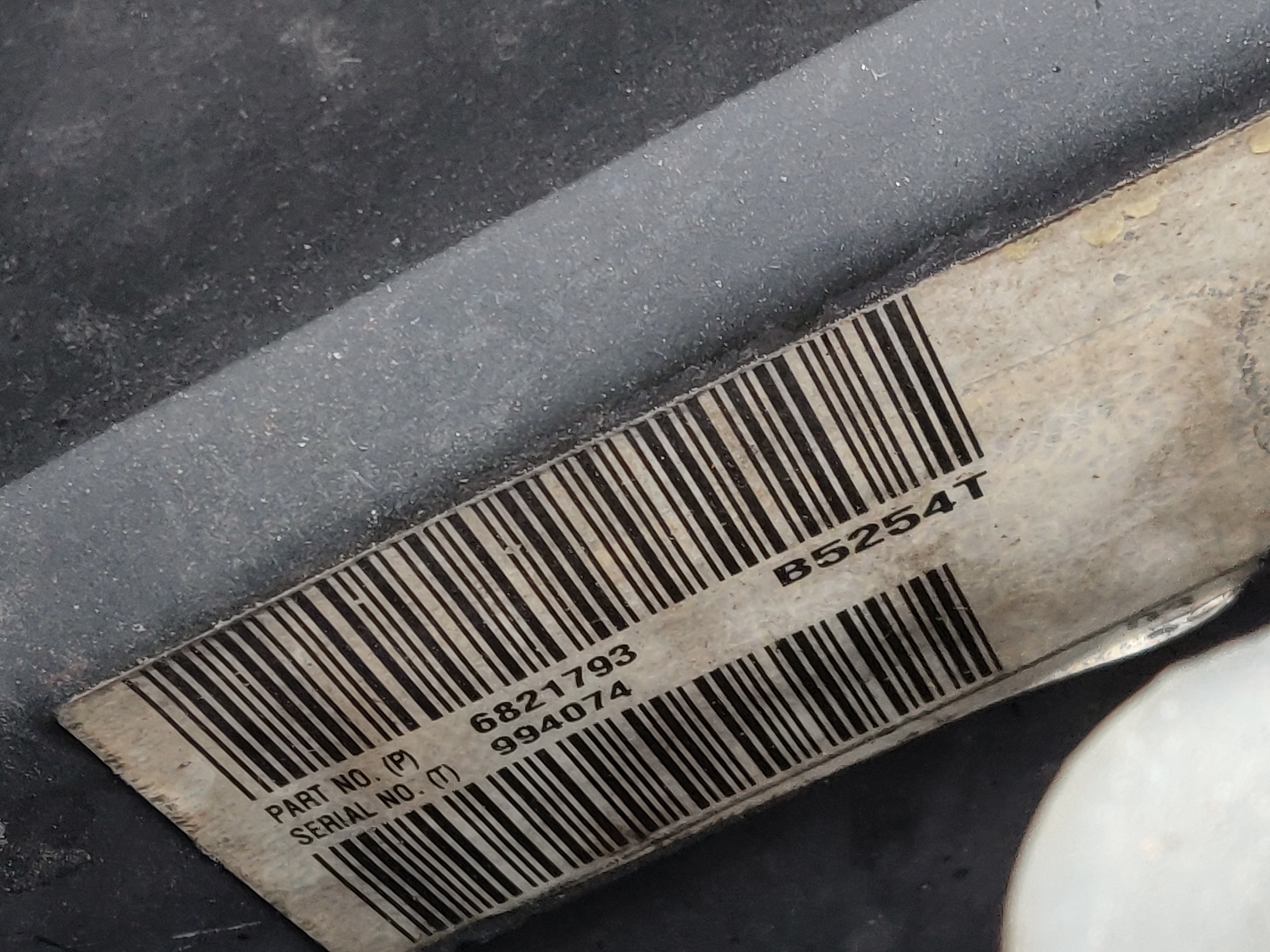

The engine is a
B5254T
And the
engine serial number is 994074
See enclosed pic

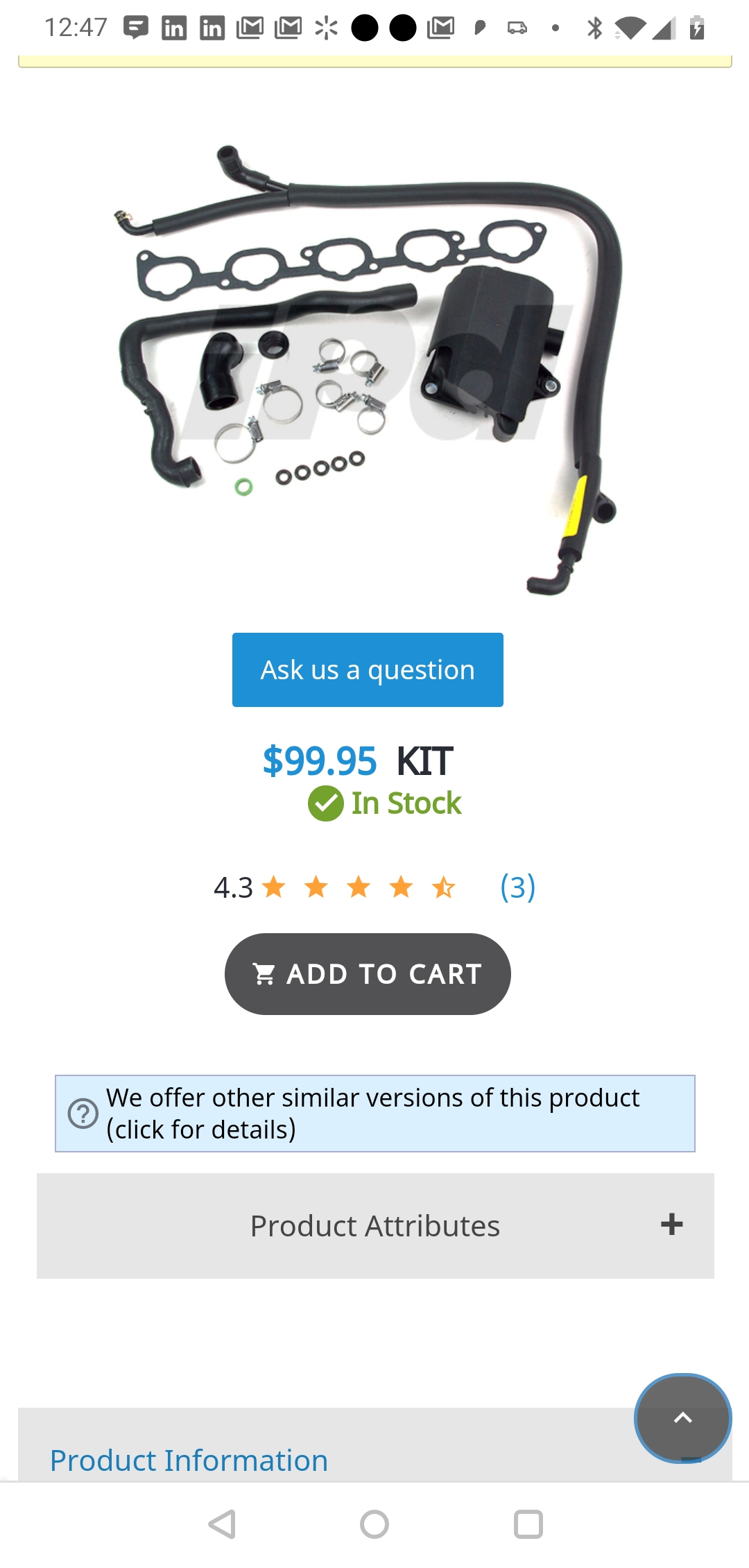

Question.... Any thing to watch out for, any unknown to be prepared for ahead of time?
Any extra parts to have on hand? (One Youtube vid suggested injector orings just in case, lucky this kit comes with them)
And, any other things I can do, when I am down in that section of the engine, while I am in that area?
Any pointers or video links would be helpful. Thank you!

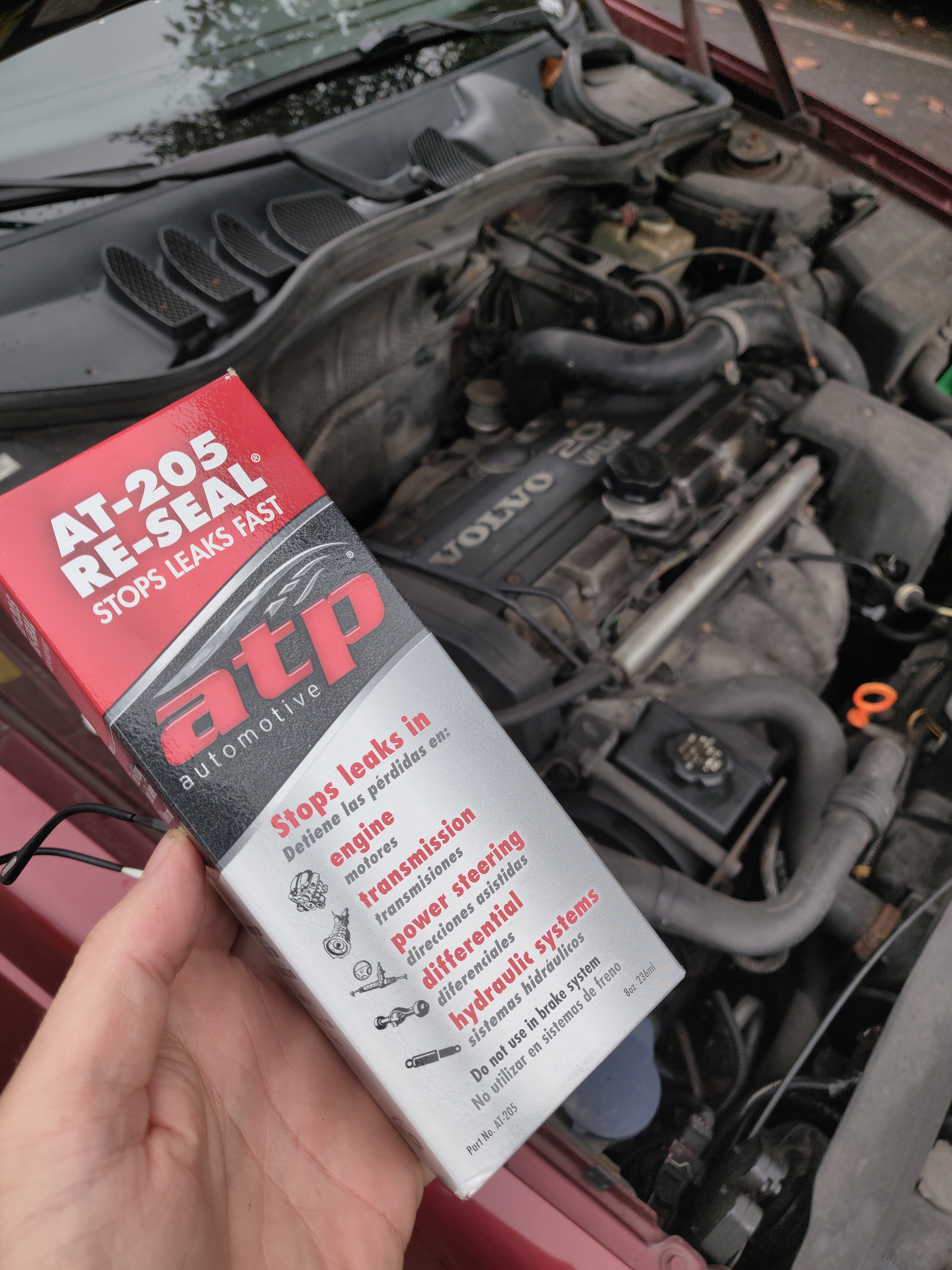

Also, because of the milage, and I am hoping the valve stem seals are ok, I did a little preventative by adding ATP at-205 to rejuvenate the valve seals. Not my favorite way to fix something, but I did do this with my trans am and it fixed the smoking problem.
I am still going to do this job, so any info is helpful!
