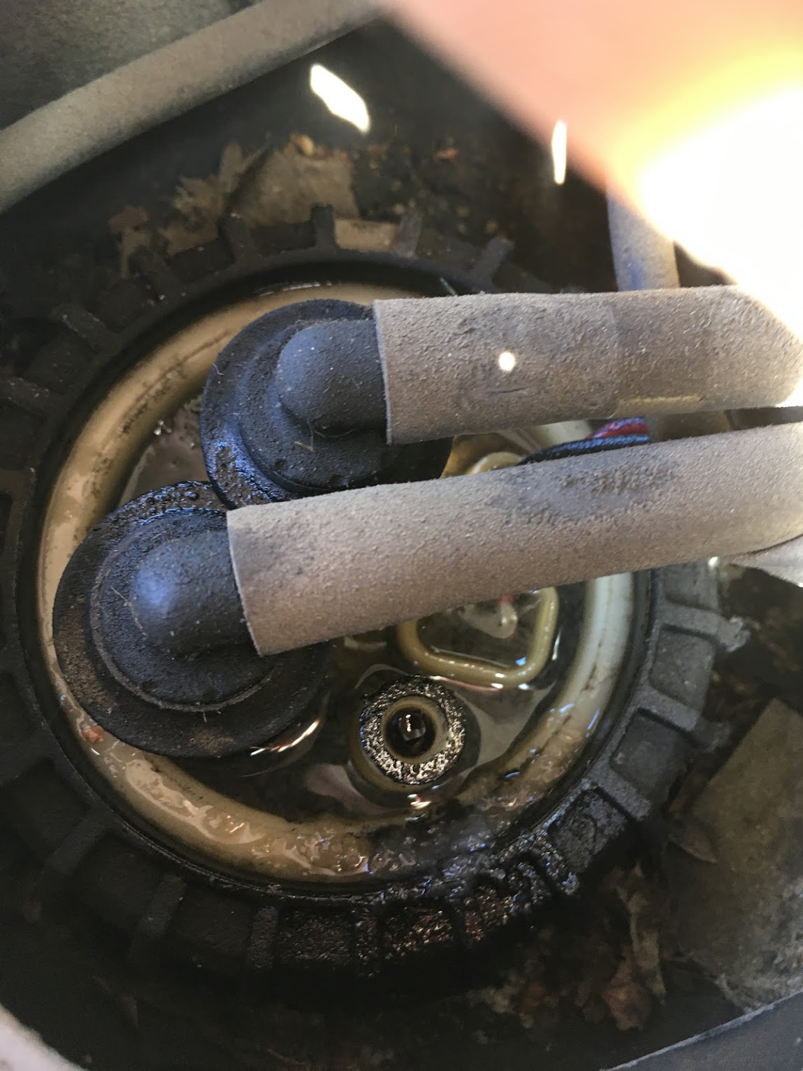

Got a first look this afternoon. Am I correct that this is the top of the fuel pump, and that the white ring inside the collar is actually sealant? Looks like the sealant ring has degraded. I'm going to go dry it out and take a closer look in a few hours when it cools off, no fun working on a car during a California heat wave..

Something broken up top and is spewing fuel into the top.
