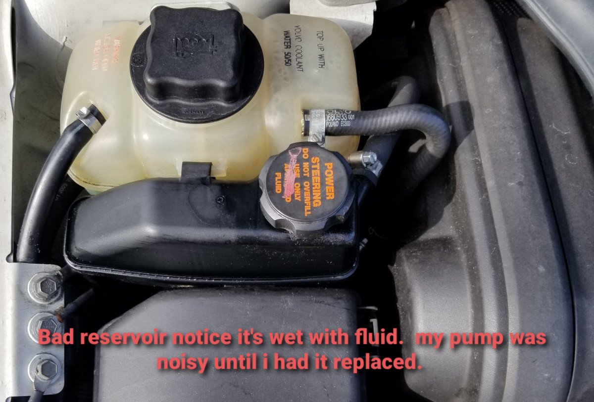

You may have a bad reservoir. If it appears to stay wet around the cap than replacing the reservoir is your first action. A part breaks inside causing the fluid to aerate causing a noisy pump. Its a common failure on a P2. June

That's another question I had, the reservoir is not wet or leaking on the outside but I did notice a steady stream of air bubbles in the reservoir when viewing with the cap off. There's no leaks anywhere in the system yet there's the stream of bubbles and I don't know if that's normal or not.June wrote: 18 Oct 2020, 09:42 You may have a bad reservoir. If it appears to stay wet around the cap than replacing the reservoir is your first action. A part breaks inside causing the fluid to aerate causing a noisy pump. Its a common failure on a P2. June

No the turn down has likely broken off. When not broken you can't see the return stream. I'll video mine when I get home so you can see what normal looks like. Once the reservoir was replaced and air blead from the rack the whine/ grind sound went away. June

Here is my car 205K original power steering pump replacement resistor, quiet pump now. No aeration now. June

The fluid in your video looks much better that mine with the air bubbles although I'm not exactly certain what's the cause, the return path within the reservoir doesn't look broken but there could be a crack I'm not seeing. At this point I'm going to take a final look with fluid removed but will likely just replace the reservoir. Thanks again for the video.

The reservoir is a common failure and as long as you have fluid aeration your pump will make all sorts of noise. Mine did for quite a while. My pump was not damaged and as you see is in good working order at 205K. I hated all the groaning an one day ran across a post about this problem. Sure enough it fixed it. I found this video of my engine minus the noisy pump and the odometer had 170K so 35K later the pump is still fine. Junefirstv70volvo wrote: 18 Oct 2020, 17:05Thanks for the video June, very helpful. I took a short video of my reservoir but file format was not recognized so I wasn't successful uploading it.June wrote: 18 Oct 2020, 16:29
