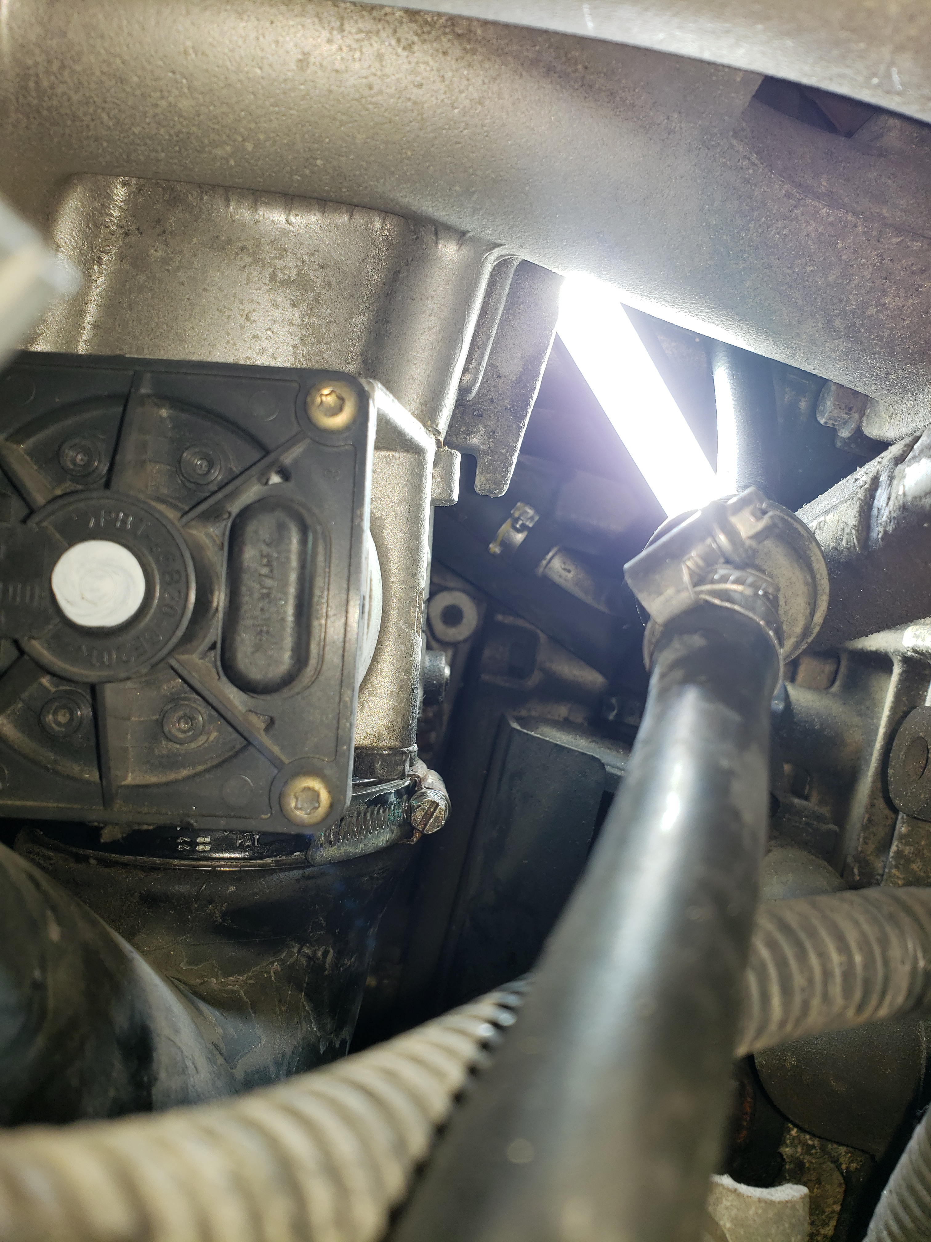

Just wanted to give an update on the radiator removal. I did drop the intercooler, radiator and fan out the bottom. When I tried to lift them up i could not clear the lower AC hose attached to the sub frame.
I finally looked carefully at the hard plastic induction air pipe that was the original obstacle (picture shows it coming away from the ETM). Fortunately the 7mm screw head on the pipe clamp is visible and accessible.
With the radiator, etc. already out of the way I used a 1/4 in drive socket and a short extension to loosened the clamp screw and popped the pipe off of the ETM. This finally created the space needed to fit the intercooler, radiator and fan shroud back into position. When reassembling the induction pipe I positioned the clamp screw at the 12 o'clock position, behind the ETM. This allows a socket and extension to reach the clamp running parallel to the block. It is easier to access when all the components are back in place.
Please be very careful to notice the position of the clamp removing and replacing the upper induction tube hose clamp. It only fits one way that allow the small upper radiator relay support's cutout to properly fit over the clamp and the hose.
Hope this helps other owners fitted with the ETM and hard plastic induction pipe.
shows the induction pipe coming off the ETM

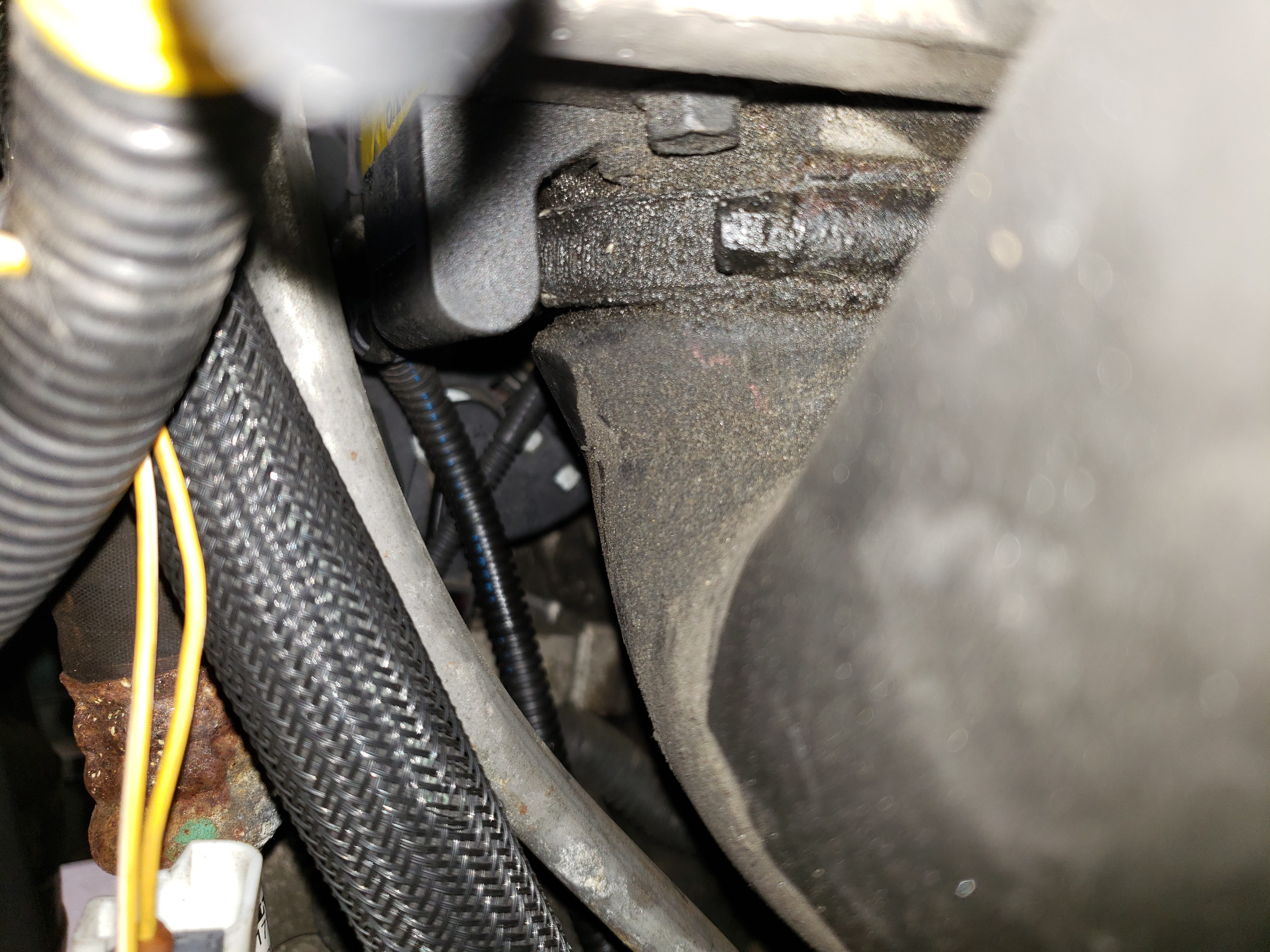

Post by 800artfreed »
Top picture is at the 12 o'clock position, post installation looking from the driver's side along side the head. Lower picture is the original 3 o'clock position all relative to looking down from the top of the engine and referencing the ETM connection to the induction pipe.
