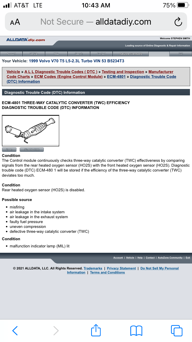

Clarifier. If you have a leak in your purge system too much O2 in the exhaust can trigger the 4801. I would think fuel trims would code first though.
That bold statement above never got clarified.
The ECM swings the mixture around stoichionetric to give it a lock signal to compare. If the rear OXS is also swinging, it means the cat isn’t working by burning off the excess fuel/ exhaust.

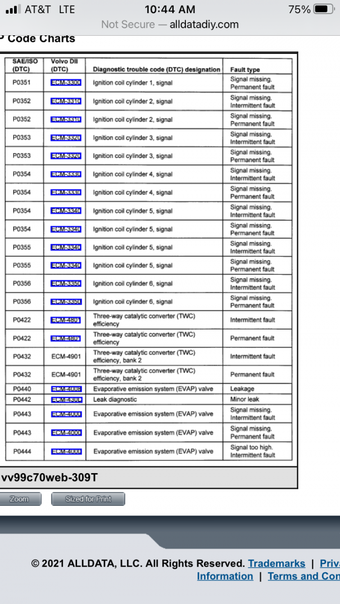

The two-year IL Air Team summon arrived in the email. The ECM-4081: Catalytic Converter Efficiency - bank 1 made a friendly visit this time. Why P0422 is a corresponding code and not P0420?vtl wrote: 18 Jun 2022, 08:17 Pretty much you need a new front H2OS every 150k miles and rear one every 200k. It could be a melted/ruined cat, too. In that case I'd go with a downpipe. Considerably cheaper and a bit more ponies and low freq grunt.
