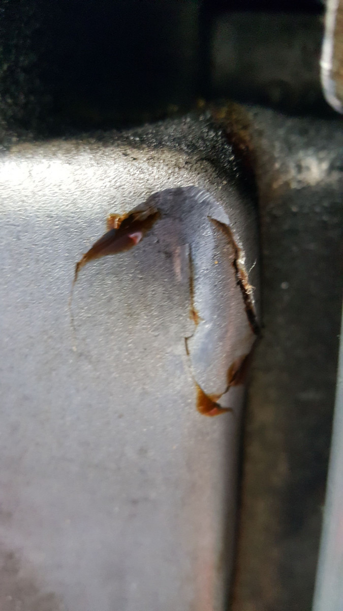

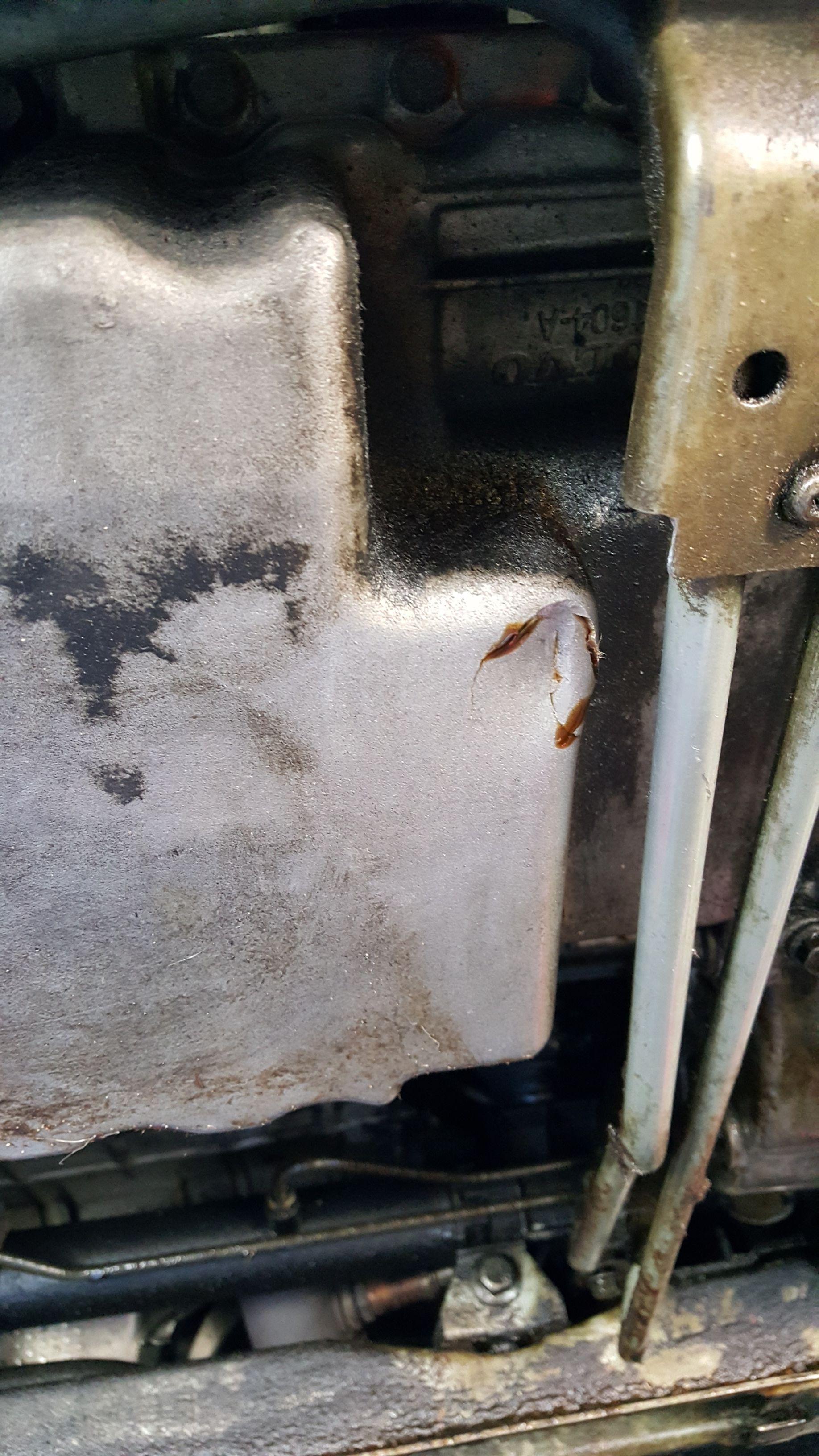

1998 V70 GLT - she had a no start issue (turned out to be the security system) that had me tow her back to the house. Somehow the towing company smacked my oil pan and cracked it. By the time he got to my place every drop of oil was gone.
I've looked around for a replacement but the cheapest I'm seeing is around $600. Anyone have suggestions on where to find one cheaper? Or options to repair the crack - like alumaloy welding or JB Weld (which I wouldn't trust honestly) something along those lines?

> Whats wrong eith ebay? They seem to sell for around $100
The $100 pans I saw on ebay were for 99 - 2001. Mine is a 98. I couldn't find anything on ebay for that year.

94-98 turbos all use the same oil pan. Chuck W is your best bet, otherwise back to eBay or upgrade to the newer pan and oil cooler like Neil said.
A reasonably skilled welding shop could probably fix that if you pulled the pan, cleaned it up and brought it in. But still might cost about $100.
The metal PS line next to the pan takes a strange turn near the bottom of the pic, that's not broken too I hope?
Pretty sure this is what I'll end up doing. The pan has to come off no matter what, so I'm going to clean it up and experiment with alumaloy first. If I fail I'll take it to a pro and let him shake his head at me with disgust at my amateur work while taking my money to fix it.
You freaked me out for a second, I looked at the pic and it really does look like the line is severed so I ran back and and double checked. Fortunately it's untouched. Near as I can tell the tow guy droped it straight down onto something. The damage to the pan isn't from a forward strike, it took a vertical hit.
