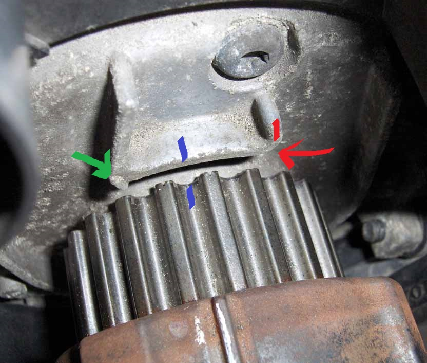

Im still trying to solve these knock sensor signal high codes, i did mistakenly tighten them thinking they were loose but i now know they are very sensitive to torque. Ive tried several times to torque them to 20nm and still getting codes and slight loss of power.
One thing i remember doing is "fixing" the crankshaft alignment when i replaced the timing belt (my car has a fixed intake timing pulley) as it was way off at the red mark (picture), i moved it back to the green mark. Did a previous owner/mechanic adjust it like this for a reason? as timing effects the knock sensor, does anyone know if this would advance or retard the timing?

You’ve advanced the cam timing by moving the cam from red to green in that picture

OK so its currently at the green, if i move it towards the red i would be retarding the timing? I will try this after i check my spark plugs and get the injectors cleaned. Ive read that bad spraying injectors can cause performance issues.

You want those marks aligned, crank amd cam. Playing with this more than a tooth or two runs the risk of bent valves from valve-piston contact. Ouch
I’m not sure what is the correct crank park in your picture. Research that and get that sorted, Mate

Playing with the timing advance to "cure' a knock code is a kludge. It does not fix the root cause and may damage the engine.
Time it with the blue mark aligned with the green mark then hunt down the source of the knock code and fix it at the root cause.

You have already corrected the timing by aligning blue and green marks, good move there (and great photo!). Nothing to do or mess with as far as timing. Checking the plugs is a good idea. I'd be surprised if the injectors were dirty but it's possible.
