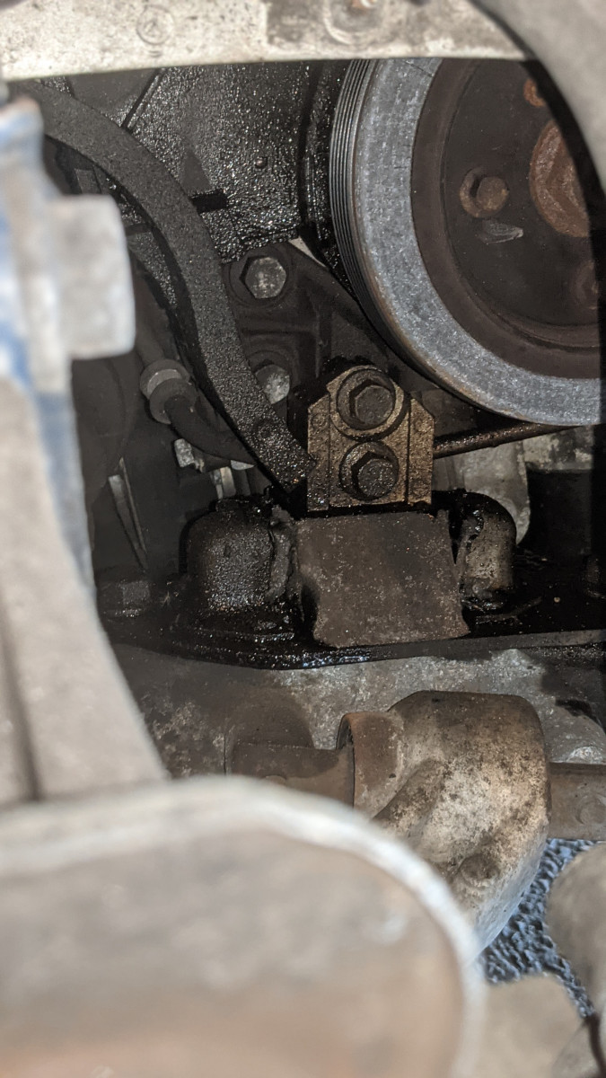

Well its been a good year now and the money pit is now demanding more tributes.

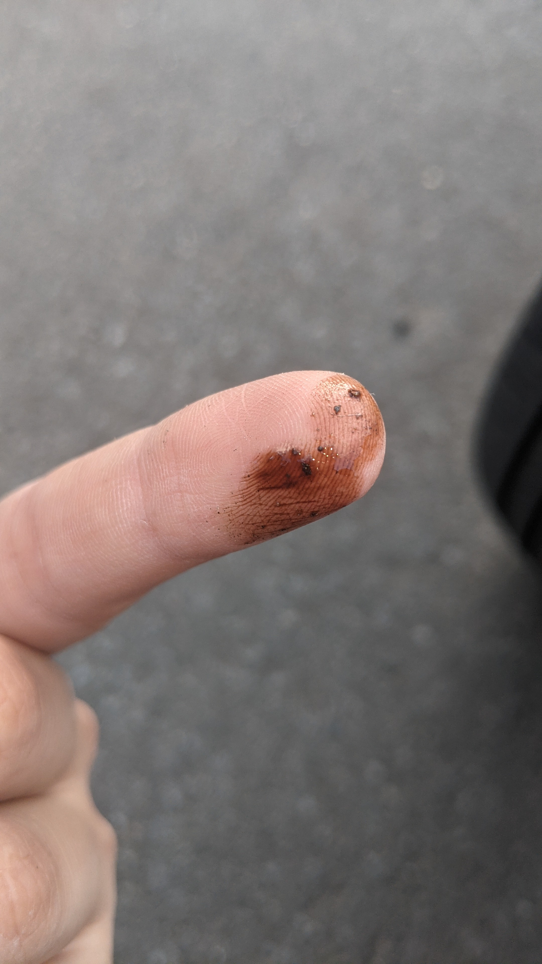

There's been a weird liquid around the subframe where the engine mount to the front of the engine is. However there hasn't been any new liquid for weeks, and it hasn't evaporated or sloshed around, so it's either motor oil or something else.
It seems like it could just be time for a premature timing belt job with seals or hopefully it's something else. I'm just wondering if someone else ahs been through something like this.
No noticeable loss of oil in over 2 months 600+ miles since last oil change

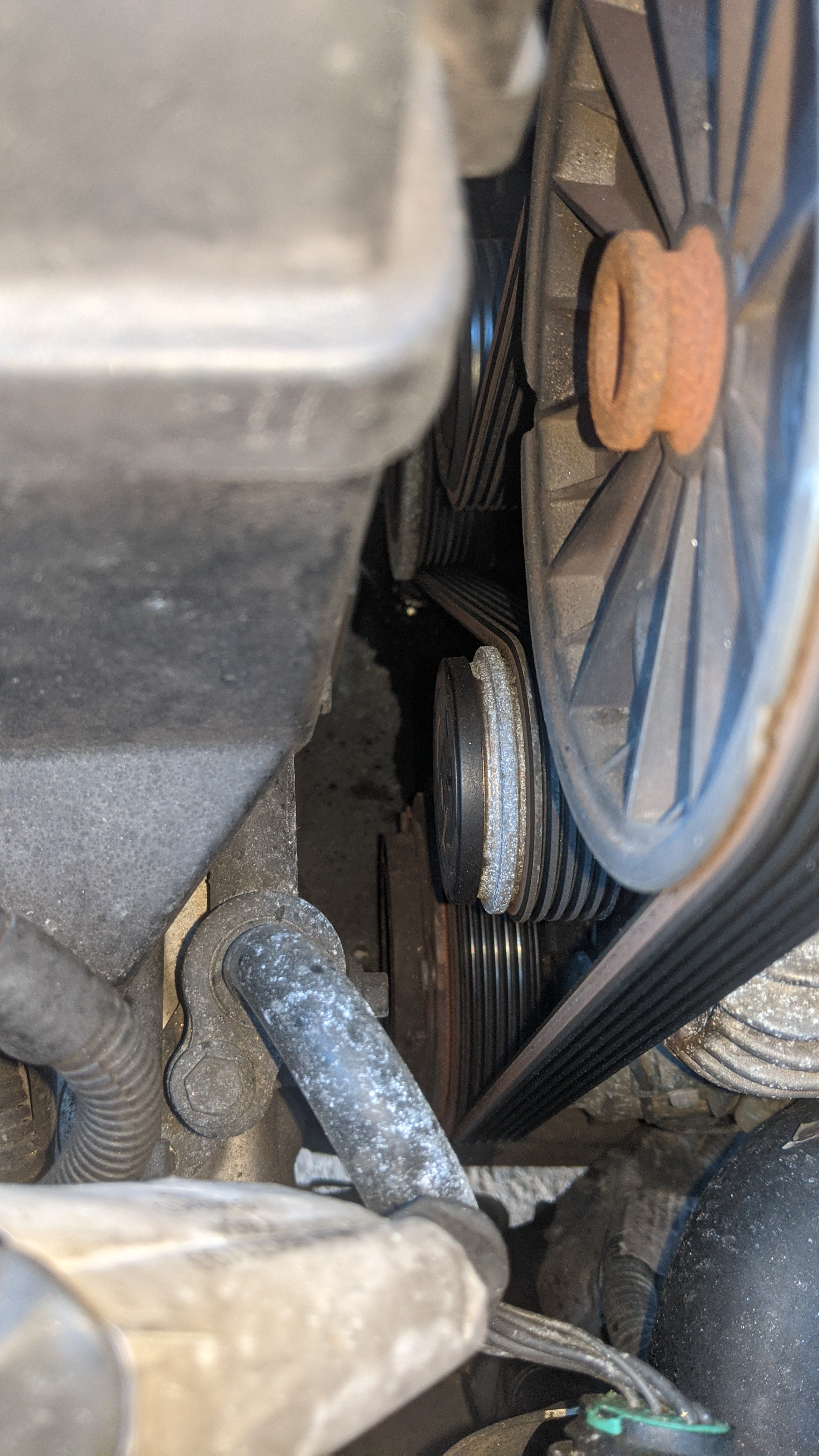

Have a look from above of the power steering pump downwards. You also have the thermostat about there and the small hose does leak sometimes coolant

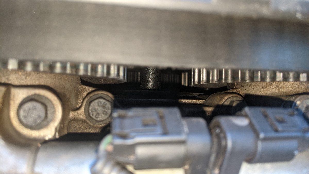

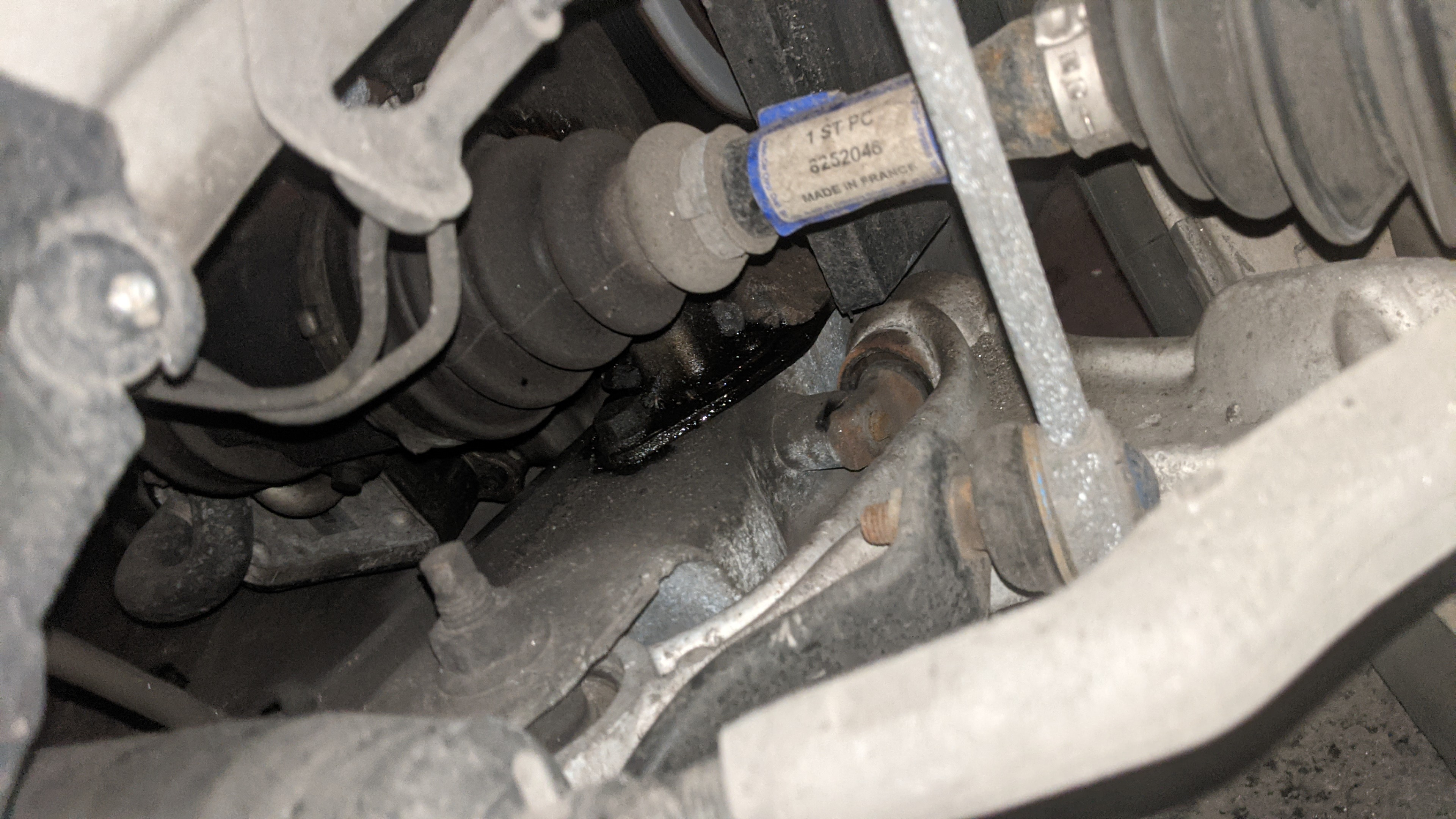

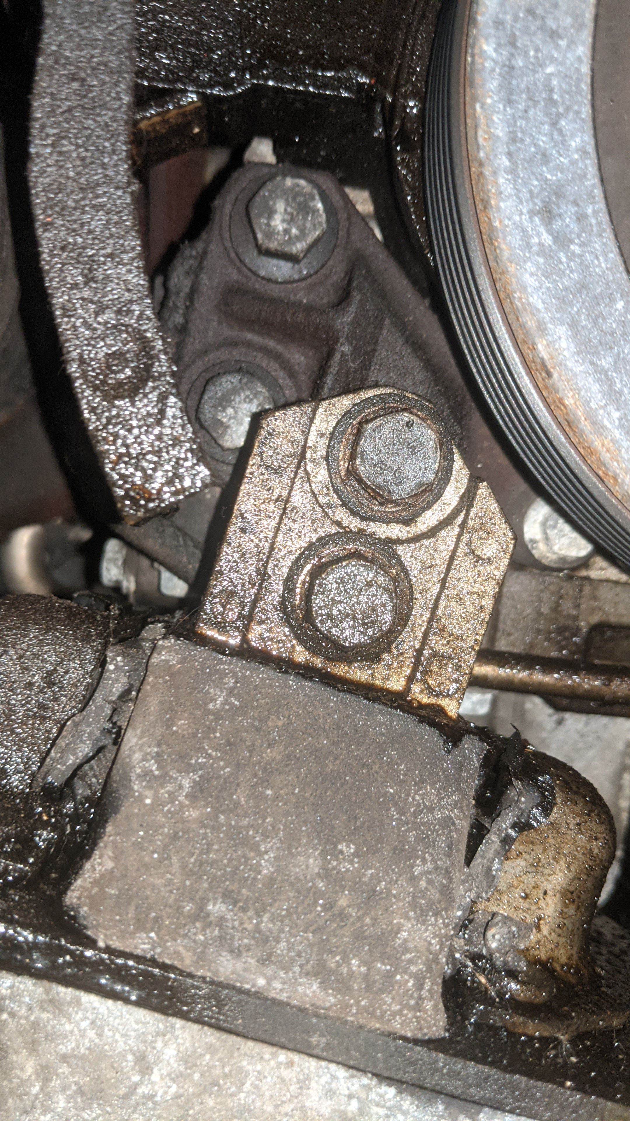

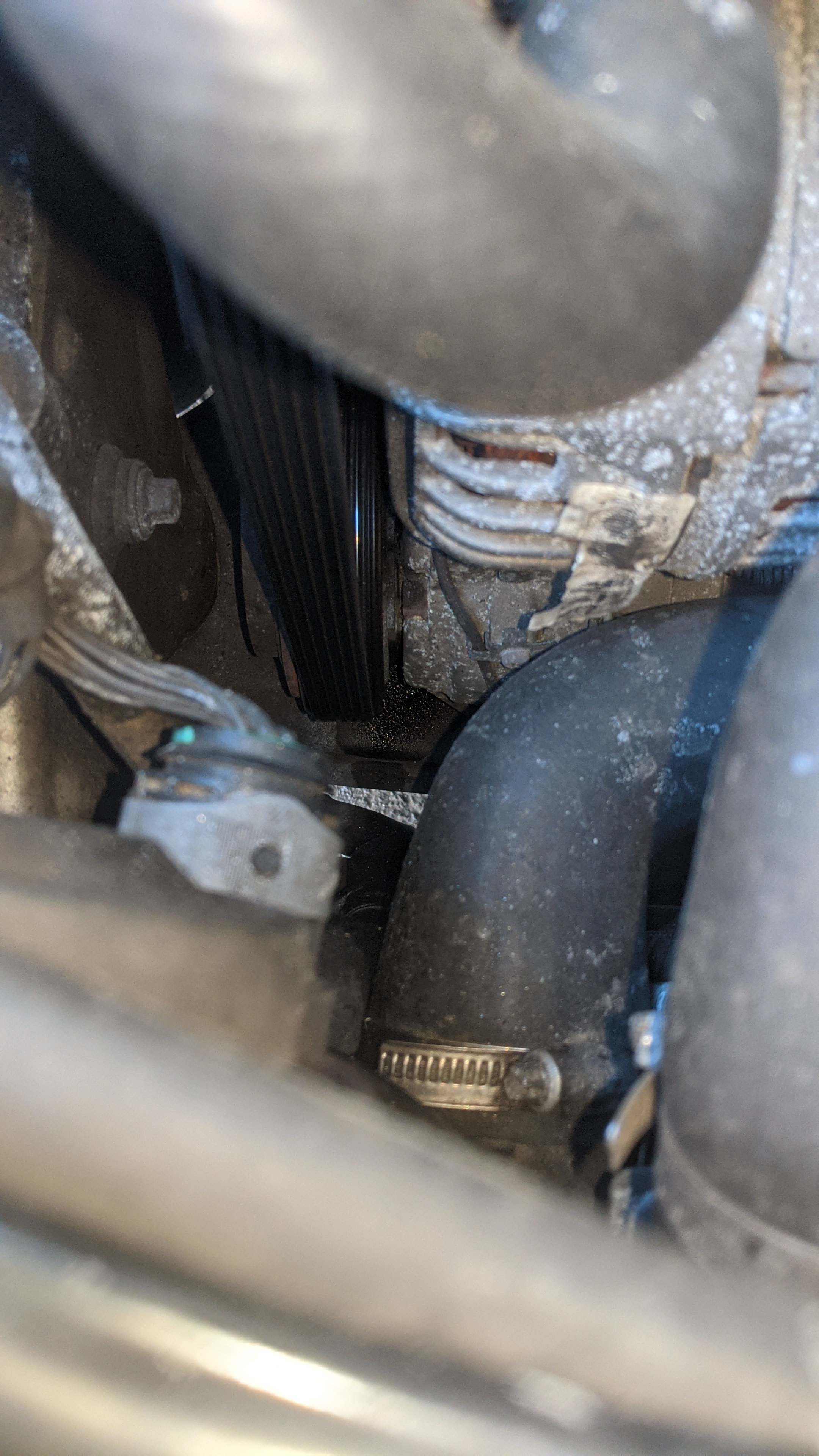

Little update
Timing belt, gears, and cover are all dry to the bone. And both resivoirs are dry underneath so there's a bigger chance that it could be the harmonic balancers seal, but no way to know until i get in there.
Popped in more pictures showing the passenger side of the subframe is coated with i guess oil, but no way to know until it gets warmer and i can reach it. The thing has a funny way of hiding under the engine.
Oil level is still the same.
@darylrobert You're saying that it's just common for the engine to spit out a bit of oil and just re-seal itself?

Hey guy, just following up with looking into what's going on with the leak.
Apparently it's an oil leak and I believe it is the camshaft seals, so it looks like it'll need a pre-mature timing belt job. I'm gonna have my inde mech look at it and do the job since it's not something you'd want to make a mistake and go back into it again.
Let me know what seal do you think is busted. Thoughts, etc.
