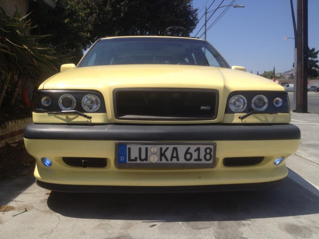

Does anyone have any experience putting quad 240/740 headlights onto an 850 ?
I get they won’t be a straight swap, but would it be possible ?
Would it even look good ?

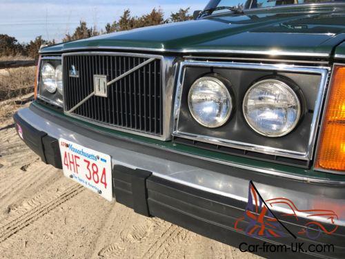

I'll admit I'm a pretty biased person in design discussions, but there is some background.

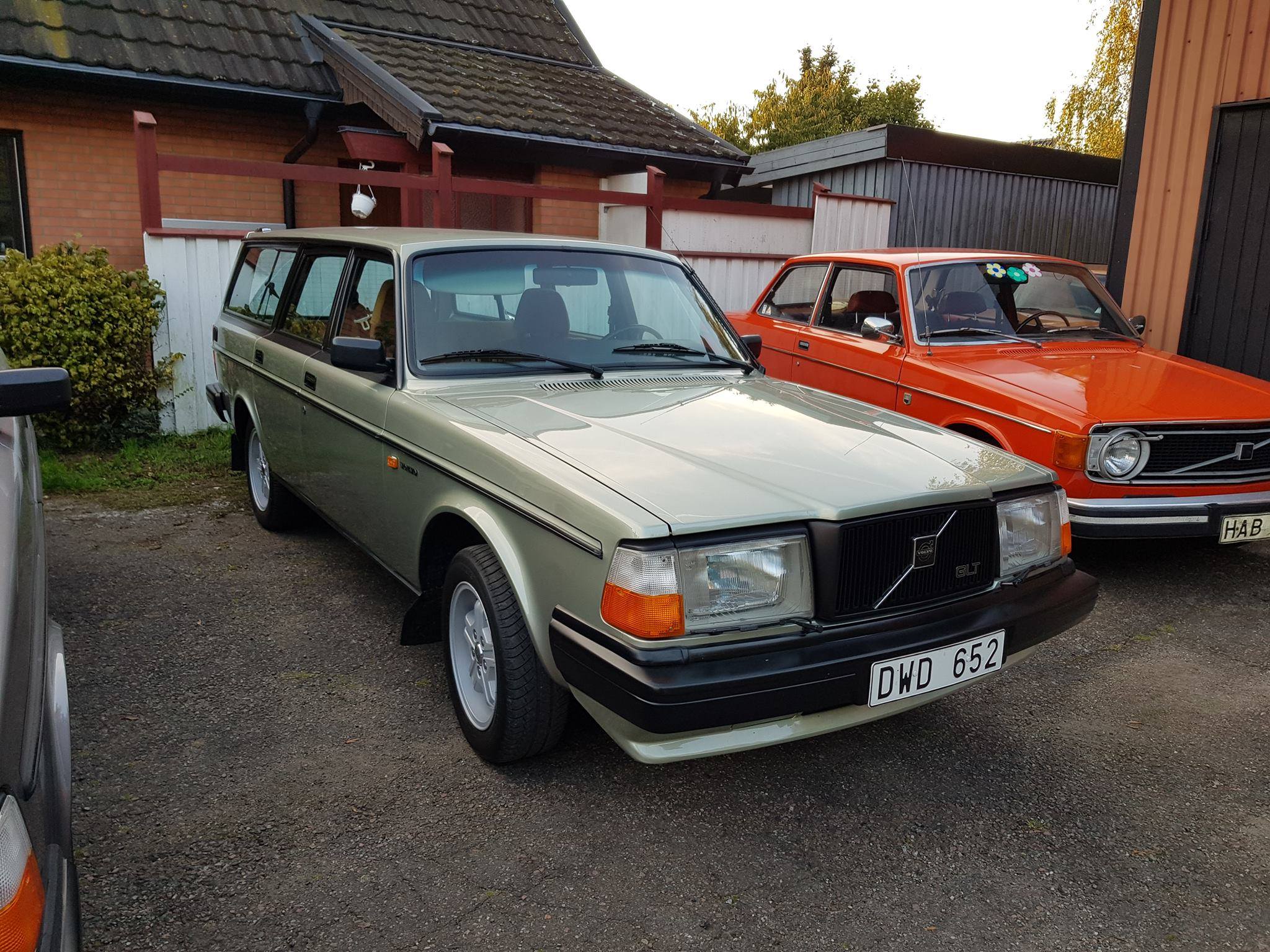

The only reason the 1980 240 came with 4 round lights is because the silly American regulations prohibited the much much better single lens and reflector european lights, which was what the car was designed with. By designers.
It looks like it's startled, surprised. The proportions are all wrong.
It was designed to look like this, with accurately cut lenses, halogen bulbs, and good reflectors.
The later 240s went to 4 tiny rectangular lights, for the same reason - US regulations.

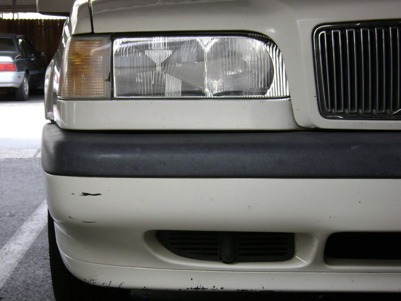

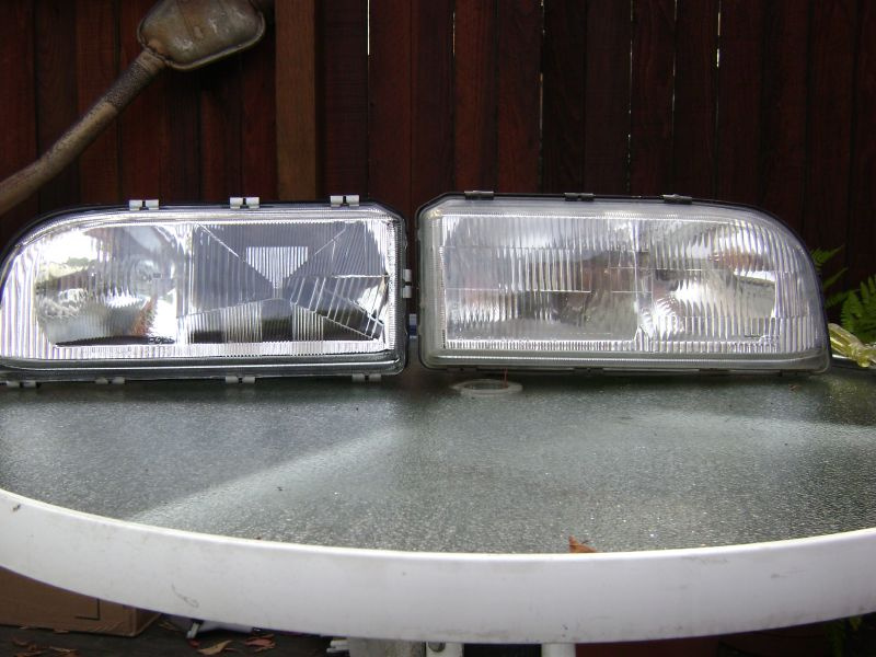

The 850 in the first year had taller headlights with one big glass and hi-low lamp. See the accurate cut-off of the light? It creates a sharp cutoff in the road straight in front of you so you don't blind oncoming drivers, and it kicks up to the right (in drive-on-the-right countries) to light up the Bambi's and the signs up ahead.
In '94, they went to a wider and less tall lens with separate low and high beam elements inside. The European "E-codes" have much better lenses and light output.
US on the right, E-codes on the left.... See the big difference in the lenses....

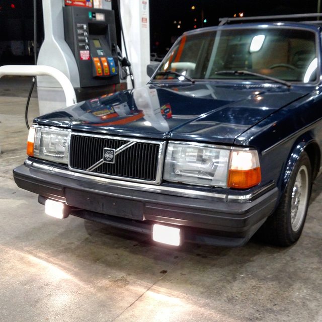

Then some aftermarket kit person decided to do this.....
fog lights installed.jpg (79.5 KiB) Viewed 1097 times
We're back to looking really surprised, and the lights are fighting the proportions of the car design. They're also too close to the middle, like cross-eyed.
