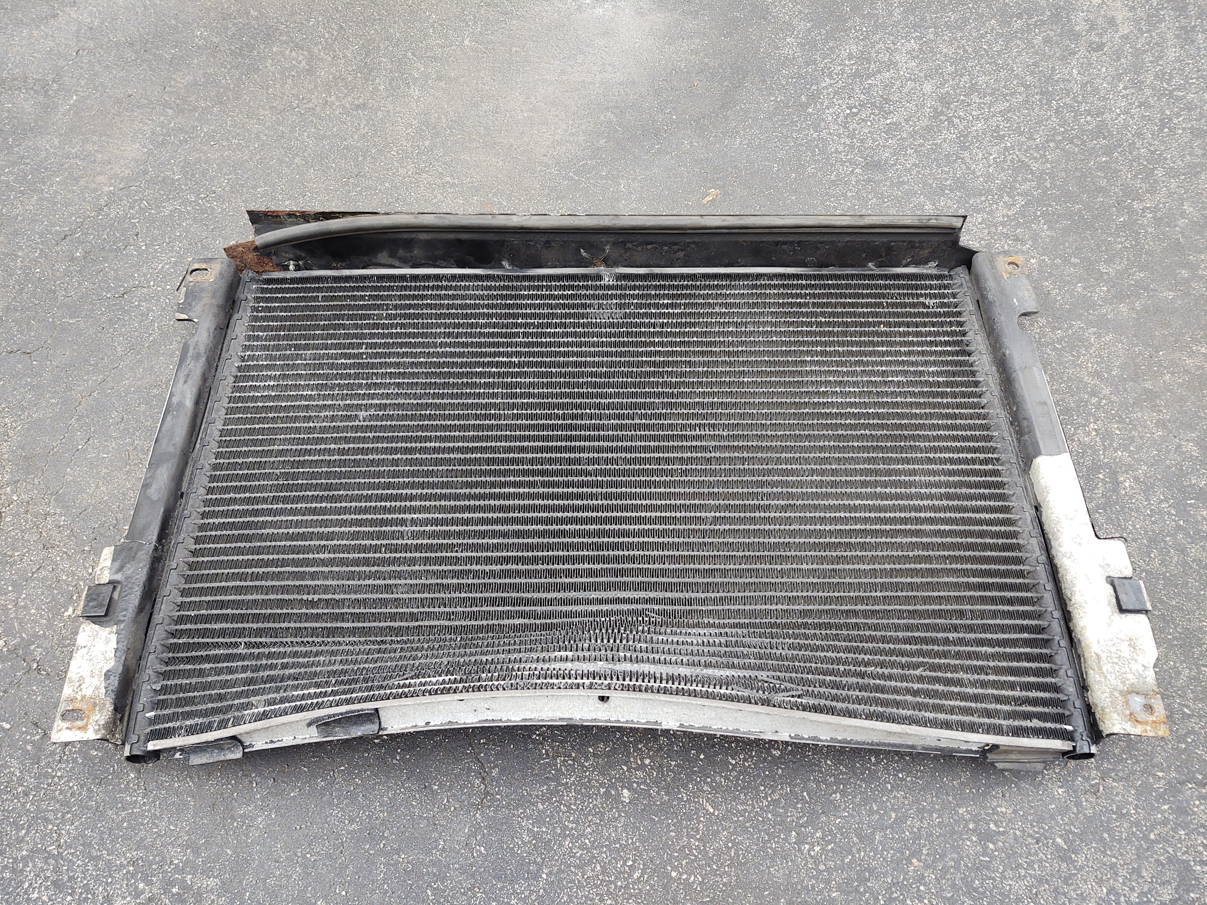

My car hit a rusty tire in the middle of the road in early morning. Condenser was bent towards to the engine, radiator too but not too bad, no coolant leak. I am going to replace both. I had no problem to remove the radiator (been doing this 3 times already) but no luck to remove the hex (6mm) bolt of the condenser hose connectors. The bolt was so tight (25 years old, original) and I stripped it after using PB Blaster for 30 minutes. I saw posts in this forum related to the removal of AC hose. Those posts showed this bolt was easy to undo but not in my case.

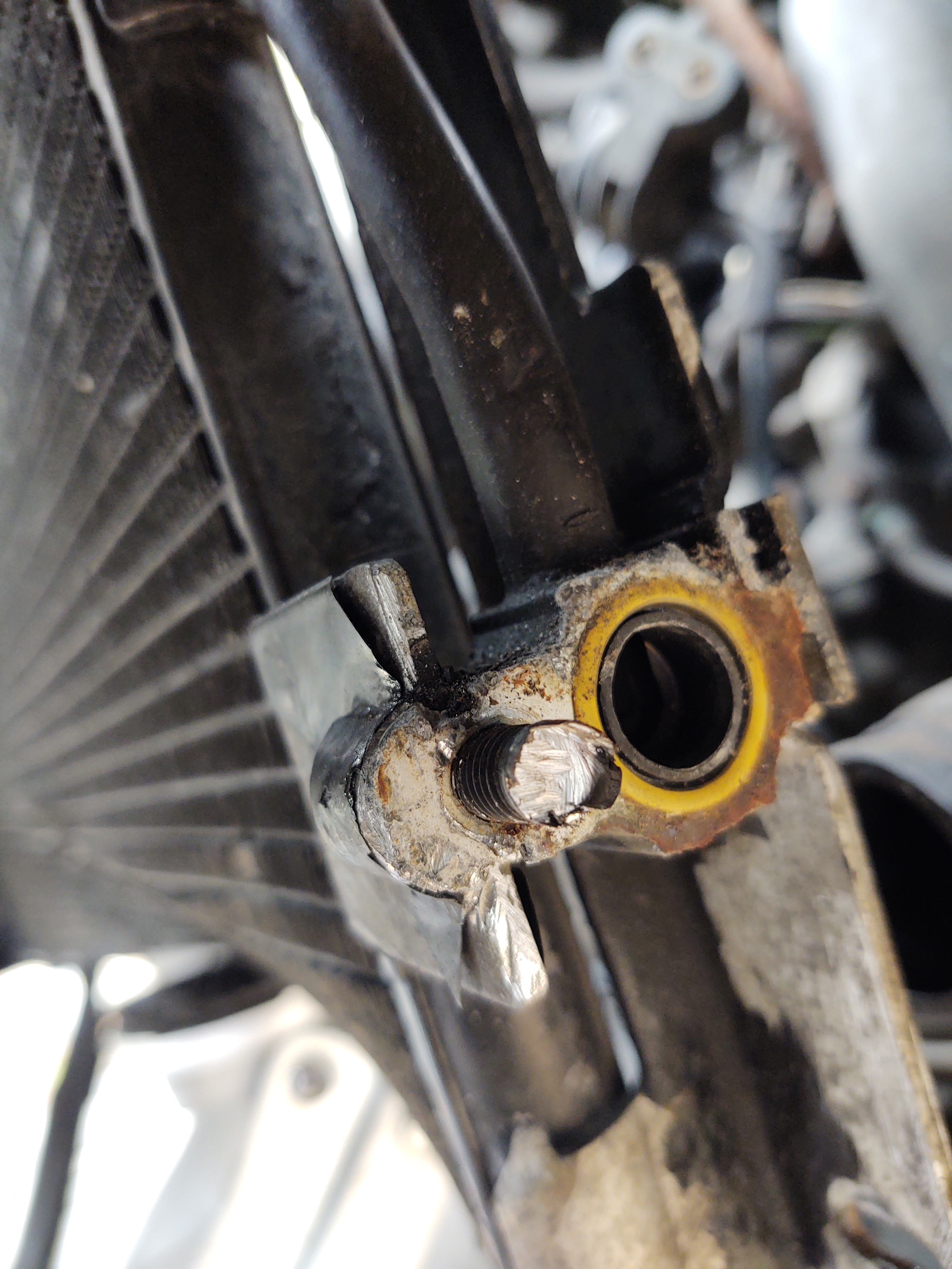

It took me about 1 hour to cut the bolt head off and cut into the bolt (a little bit behind the connector). This was because only cutting the bolt head off did not work. Maybe my cut wasn't straight enough. After these 2 cuts, I then wiggled the hose many times and it started to come loose. Finally, it came apart. I will do the passenger side bolt head next.

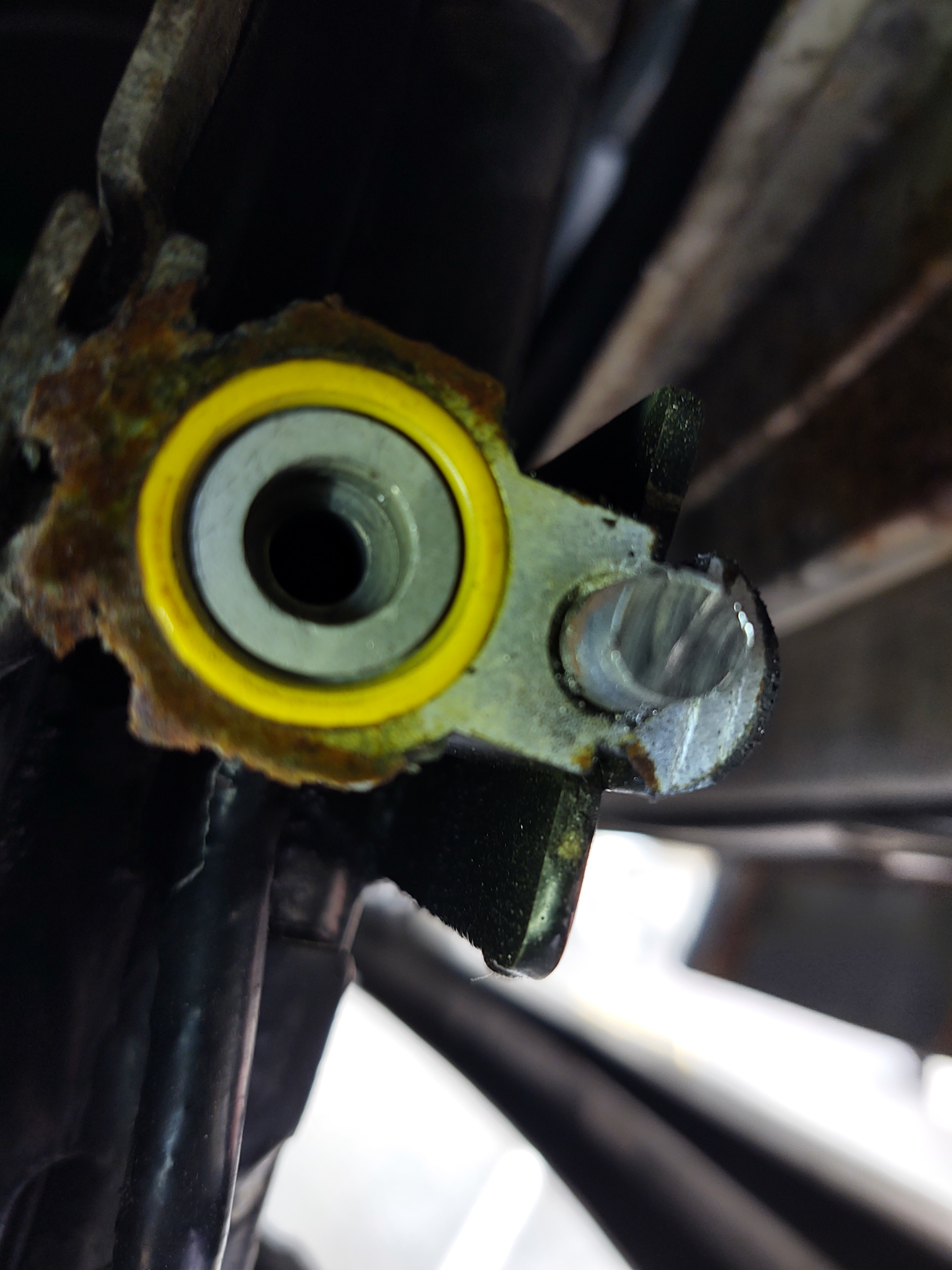

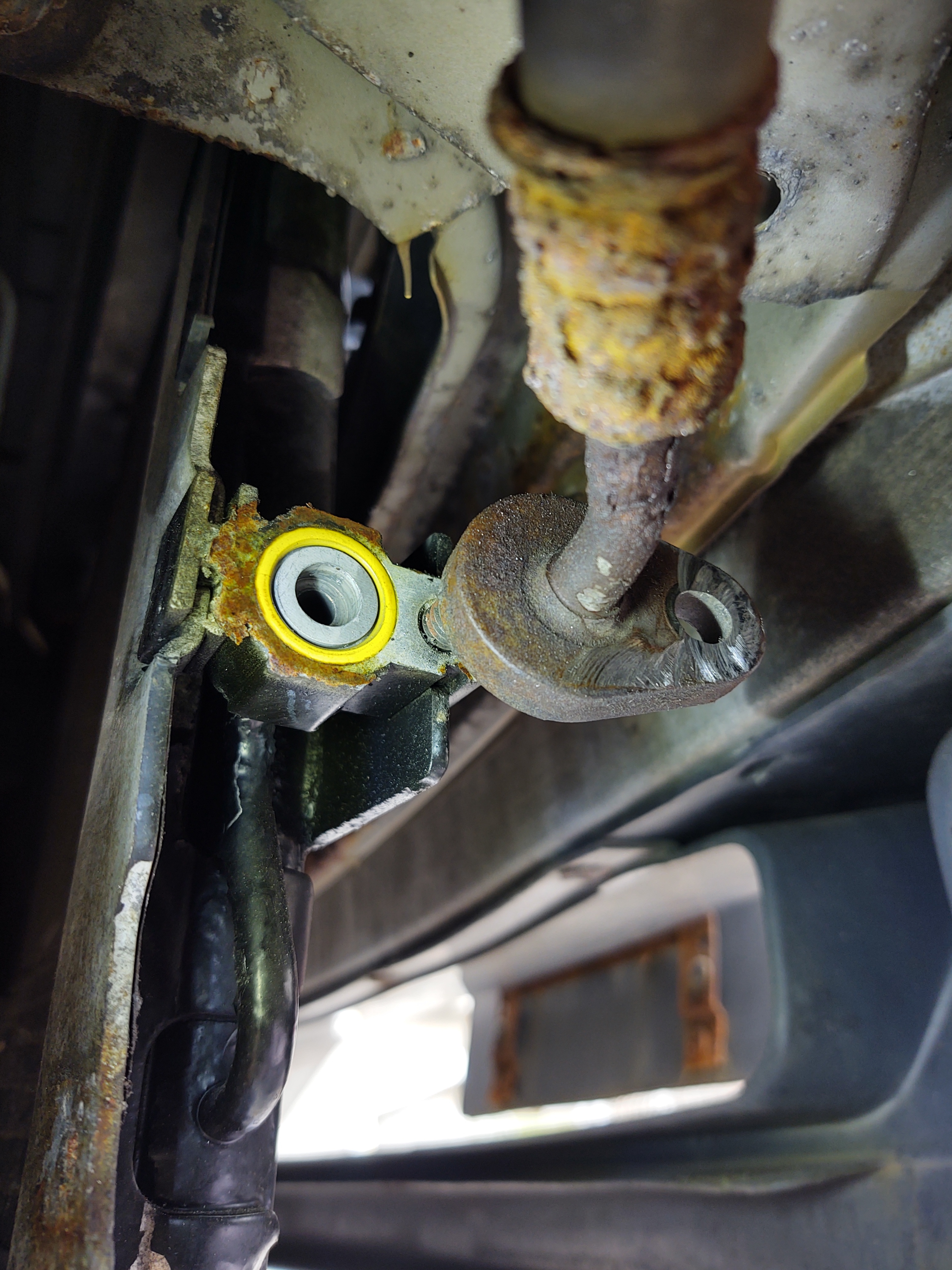

Here is the pictures of the driver side AC hose and the condenser bolt (cut).

Nicely done. If the top surface of the condensor hose got roughed up by the Dremel work just file it smooth.
The oring seal looks perfect.

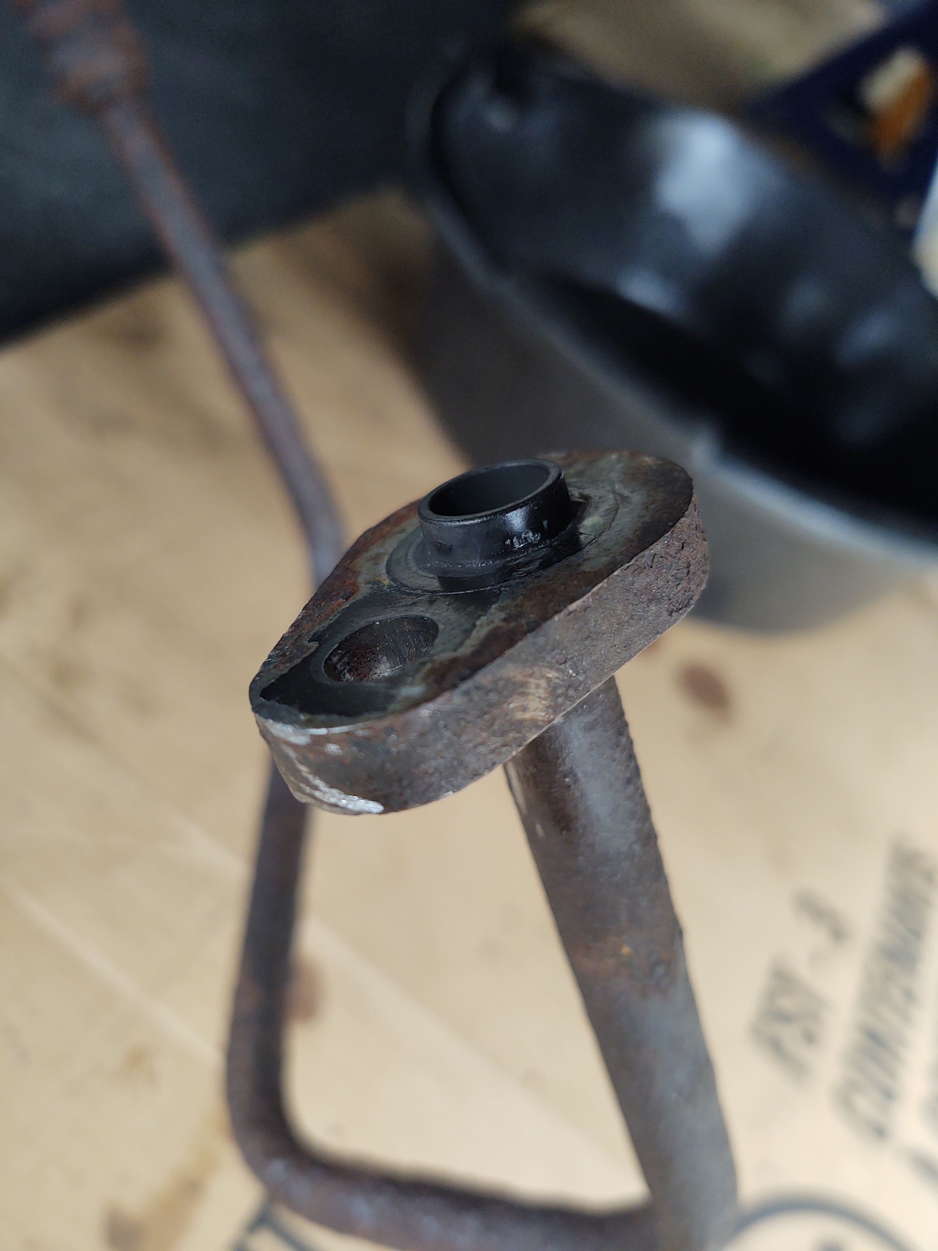

I did the passenger side today and was much easier. I used the right angle attachment in the dremel tool. Just one cut to the bolt head and connector came apart immediately. The O-ring was in much better shape than the driver side.

Ouch! That’s a dead condensor
