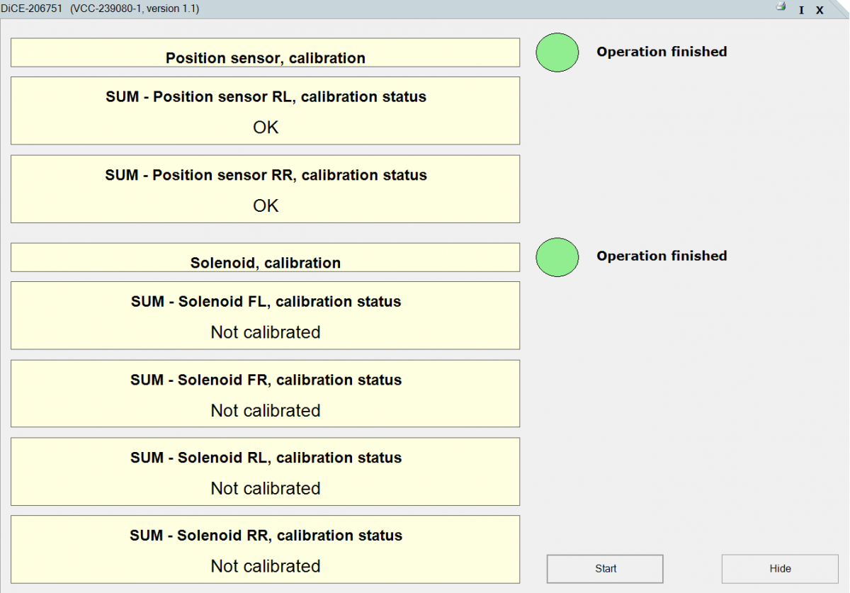

I recently replaced my struts, shocks, and springs on my 2007 Volvo S60 R. Now I need to calibrate the SUM. When using VIDA, I am able to reach the calibration screen, but I can't seem to complete a calibration. I have the engine running, and the car is unloaded. But in the bottom section, the solenoids always reports hyphens (-----------) or "Not calibrated." Here's a screenshot:
Oddly, I was able to get the solenoids to say, "OK," once, but the key was in position I. I suspect the system is still uncalibrated because I don't detect a great difference in Comfort, Sport, and Advanced modes. Also, VIDA has a screen that allows you to check the "keypad" (the Comfort, Sport, and Advanced buttons). If memory serves, you can access this screen from Diagnostics > Vehicle Communication > right-click SUM > Advanced > "Checking the Four-C (Continuously Controlled Chassis Concept) Keypad Unit." On that page, you can open a tool that lets you check the voltage that is read when each button is pressed. The page says something like, the voltage should 0-2.4V in Comfort, 2.4-3.5V in Sport, and 3.5-5V in Advanced. Despite each of the Four-C buttons illuminating when pressed, the voltage shown in VIDA remains roughly the same:

RickHaleParker, thank you for that image. While I understand what it's saying on paper, I don't know how practically to check this on my car. Do you know of some instructions for following this connection all the way through to ensure it's connected?
I took my Volvo to a dealership yesterday to get the suspension calibrated. They didn't end up actually doing anything to the vehicle, but they didn't charge me. Their top Volvo technician checked the car and gave me a lot of information. These are the conclusions:
1. "With an S60 R automatic, you will always get hyphens in the solenoid calibration section. Just getting 'OK' in the position sensor section and 'Operation finished' on the right for both sections is good enough."
2. "The 'SUM - Switch input signal' will only change while driving and switching Four-C modes."
But I'm not sure if either of the above is true. I haven't seen any agreement for either of those points online. I also tried #2, and I still couldn't get my switch input signal voltage to change.
He also thought all Four-C modes felt like they normally would on an S60 R.
Here's how I'm hoping someone can help me:
1. What are you SUM parameter values for "Valve supply front left", "Valve supply front right," "Valve supply rear left," and "Valve supply rear right"? Should it be 0 volts? Mine are.
2. Has anyone with an R ever been able to get something besides just hyphens in the solenoid calibration section?
3. Does your "SUM - Switch input signal" change when you press your Four-C buttons? Volvo's own documentation says it should.

I'm not familiar with the calibration routine but I've got an 06 S60 R that seems to function properly. The front 4C struts were replaced at a shop just before I bought it, the rears are original (!). I've also got VIDA so here is some partial response to your three questions:
1. For my car, all four valve supply voltages read zero when the car was stationary. But when I moved the vehicle (rolling slowly forward in drive) the voltages immediately started to jump around. I also noticed that the voltages jumped up to higher max values (hard to see exact readings as it changes so quickly) depending on the 4C button mode: In Comfort the voltages seemed to be up around 2 V, in Sport they were up around 4 V and in Advanced they were more like 6 V. This was all rolling slowly down a bumpy paved surface. Those observations provide some evidence 4C is working.
2. I am hesitant to enter beyond the front screen of calibration mode because I don't want to mess things up if properly calibrated. If you (or anyone!) can assure me it's no problem I can push further on this matter.
3. The "SUM - Switch input signal" always read the same voltage (about 4.5 V, like yours) *unless* I held the button down. In that case it gave a stable voltage within the expected range for each mode, just like in your original post with the info from VIDA. So try holding the button down, not just switching modes. The rest of the SUM values for my car were similar to those you have posted for your car.

1. I observed the same thing. I had just needed to put the car in drive while observing those values. It was cool to use the graph mode and watch the voltages change.
2. I cannot assure you of that. I know very little about it really.
3. Holding the buttons down was the trick. I thought I just had to push them briefly.
Thank you, erikv11! I can finally feel confident my S60 R is running correctly.

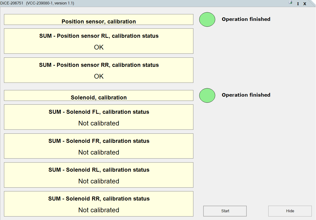

My wife was complaining about our S60R nose crashing, even bottoming out, on a big dip in the road she sees on her commute every day so I thought maybe it was time to replace the 4C struts (70k miles on them). But I did wonder about calibrating the SUM to better handle dips so I sought to try that first and got out there DiCE unit.
However the SUM refused to calibrate as one of the ride height sensors was out of whack:
Snap 2025-06-07 at 19.02.06.png (35.26 KiB) Viewed 1552 times
I was getting 1.5V on the RR sensor, 3.4V on the LR. Ideal is 2.5V each side.
When the SUM refused to calibrate it also pointed the xenon headlights to their lowest position like a couple feet in front of the car, which is the default when the car's height (nose up, nose down etc.) can not be determined by the SUM.
Since the two voltages I was getting still added up to nearly 5V (1.5 + 3.4 = 4.9), that told me the sensors were probably fine but just badly calibrated. While reading the voltage I first tried dropping the rear of the car by placing several bags of soil in the trunk but that just spread the sensor values even farther apart. So instead I jacked up the rear of the car and watched the values get closer together. When they were like 2.1 and 2.9 I tried again and calibration worked! Headlights returned to pointing to a "normal" position as well.
Then I removed the jack to drop the rear down to normal resting level, ran the calibration again, and it now reads 2.5V each side when the car is level.
Best part is the dampening is clearly improved, including that the nose no longer crashes in that dip in the road she drives every day. So we will not replace the front struts yet (hooray).
