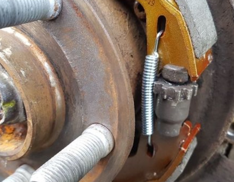

I agree the best place to adjust is at the shoesvtl wrote: 05 May 2021, 06:17 P2 takes adjustable claws from P80: 30793438 and 30793437. One or two clicks through the brake disk mounting hole and the parking brakes start to bite well again.
Note: For my LR2 with a similar configuration I replaced my shoes at 13 years because I had read about the friction material delaminating and resulting in significant damage. If it were my car I would replace the brake shoes.
Picture of the adjuster (LR2 not Volvo but it should be very similar on your Volvo)
Can be adjusted without removing the brake rotor
Take care
Paul

FYI, I replaced my 2006 S60 2.5T FWD parking brakes in Sep 2018 and neither the old or the new ones had the Adjuster that Paul shows. Hence all adjustment had to be done at the parking brake lever. I'm looking at the photos on my phone. Mine had a short H-shaped piece there.
https://www.fcpeuro.com/products/volvo- ... 0-31257573
vtl and jonesg are suggesting successfully using a superior S80 part on other Volvo P2 models. I wish I had done it.
Be sure to pick up new spring sets as you may damage the old ones during brake shoe removal:
https://www.fcpeuro.com/products/volvo- ... o-31445338
Although I picked up the part that expands the shoes and is attached to the cable, I was not able to detach the cable although I might not have loosened the cable enough. Still I was happy with the job and pleased to have a working parking brake again (the shoes had delaminated and I needed to fix it for the Mass state inspection).
