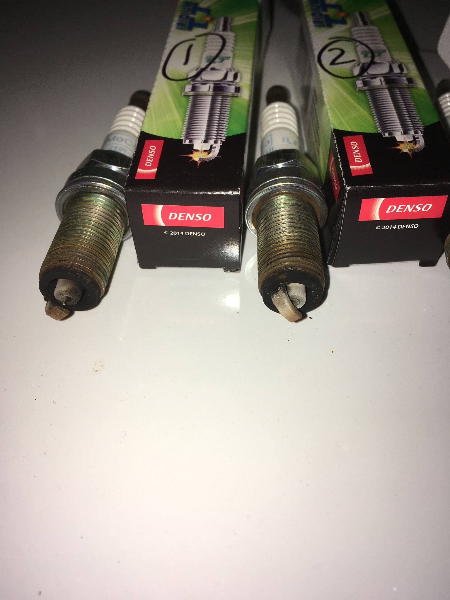

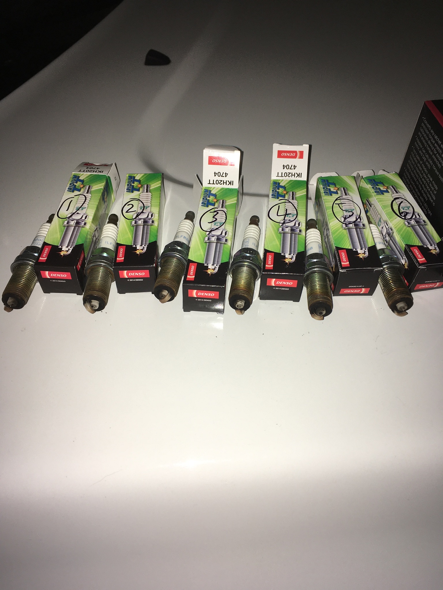

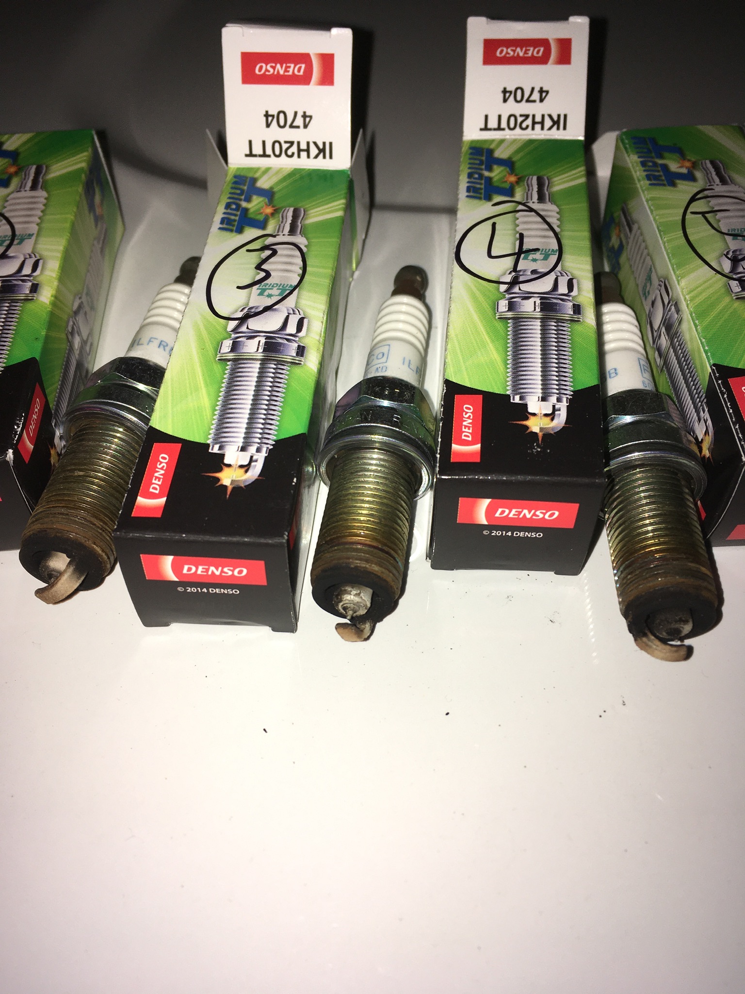

Spark plugs replaced from 2010 3.2 at 111k miles (not the one from the catalytic converter thread). To the experts: what do the spark plugs tell me in terms if the engine?

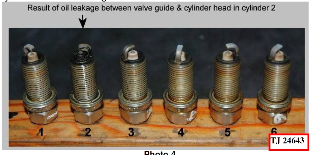

They should look like this (except for number 2 which has a problem)
The way the PCV system routes the Vapors (and oil if its broken) is in a channel that connects all 6 intake ports
Start 6 - 5 - 4 - 3 - 2 - 1 finish
Because of this plug #6, #5 will be worse than plug #1, #2 (and I think that you have that)

These plugs look the same as the set I pulled out of my 2013 XC70 at 110K miles. The gaps are a little enlarged, due to the positive electrode tip wearing down. If there's anything besides normal wear and tear, it doesn't show in the photos.

All pictured spark plugs look to be equal visually, meaning your cylinders and related are consistent. They have excess oil/coke deposits. This could be b/c of short driving distances, PCV system, or worn rings. I bet on short driving distances. So they look normal for short driving distance usage, but as you can see the results are not optimum. It is not just the spark plugs.
