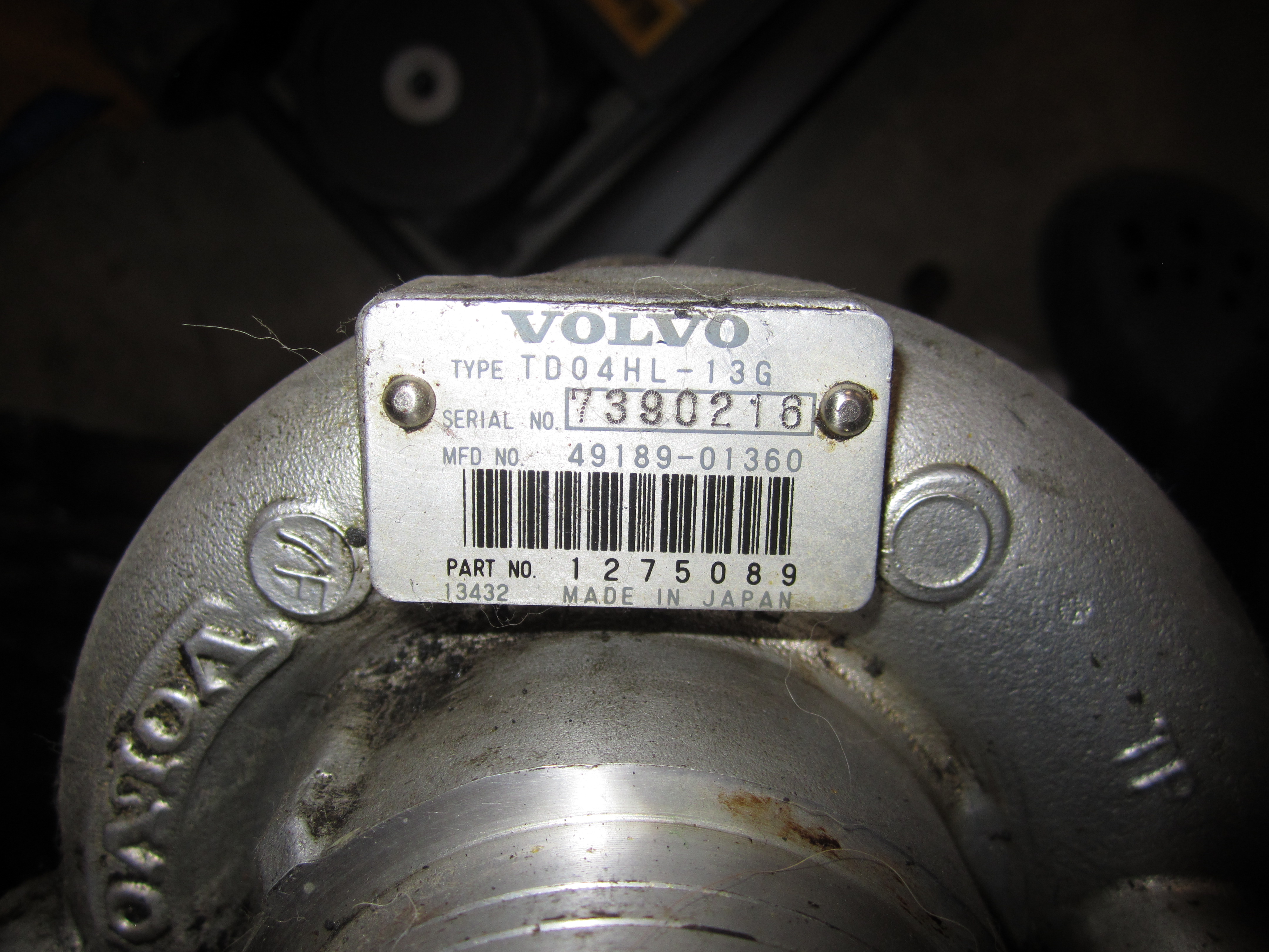

bronco wrote: 14 Jun 2021, 16:44 How do I tell the low pressure and high pressure turbo from each other in hand?
The LPT cars are usually spec'ed with a 13T. On the std HPT cars (non-R, etc) you'll find a 15G or 16T.

What Chuck said - check the nameplate on the turbo. It may be all oily and need wiping off. Like this: Image
A 98 HPT will have a 16T but a 15g is close to it performance-wise.

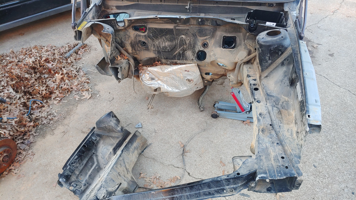

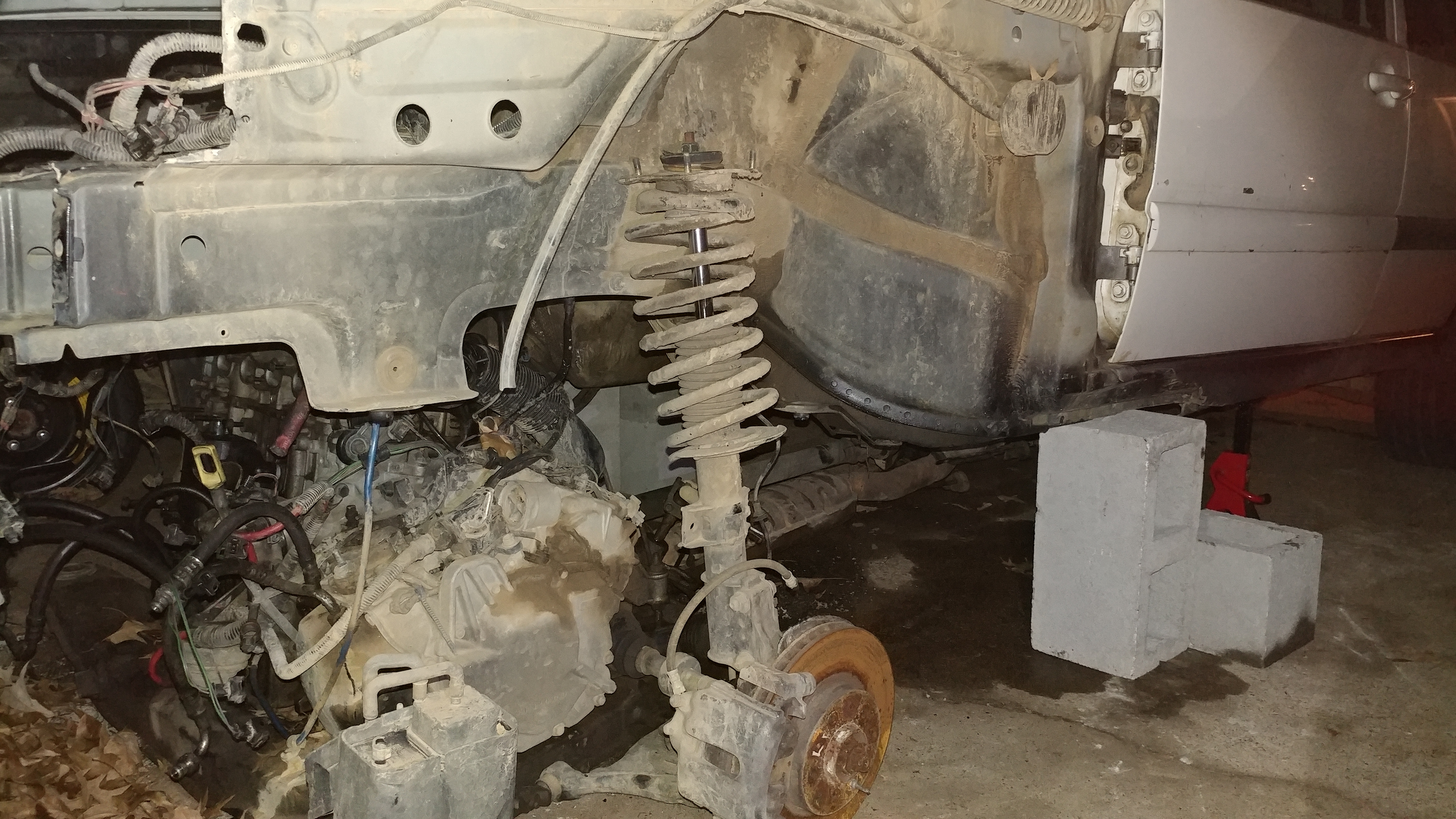

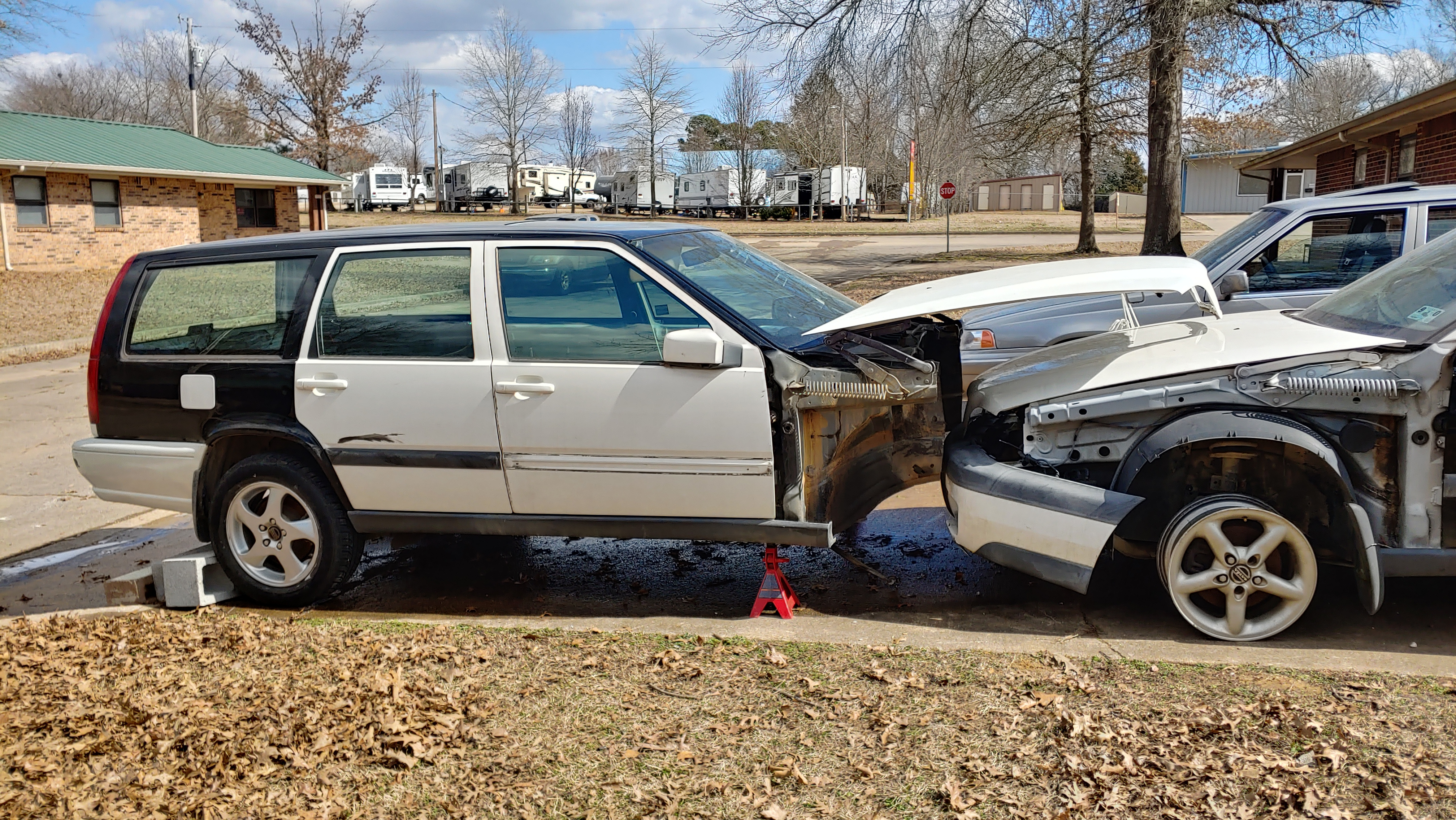

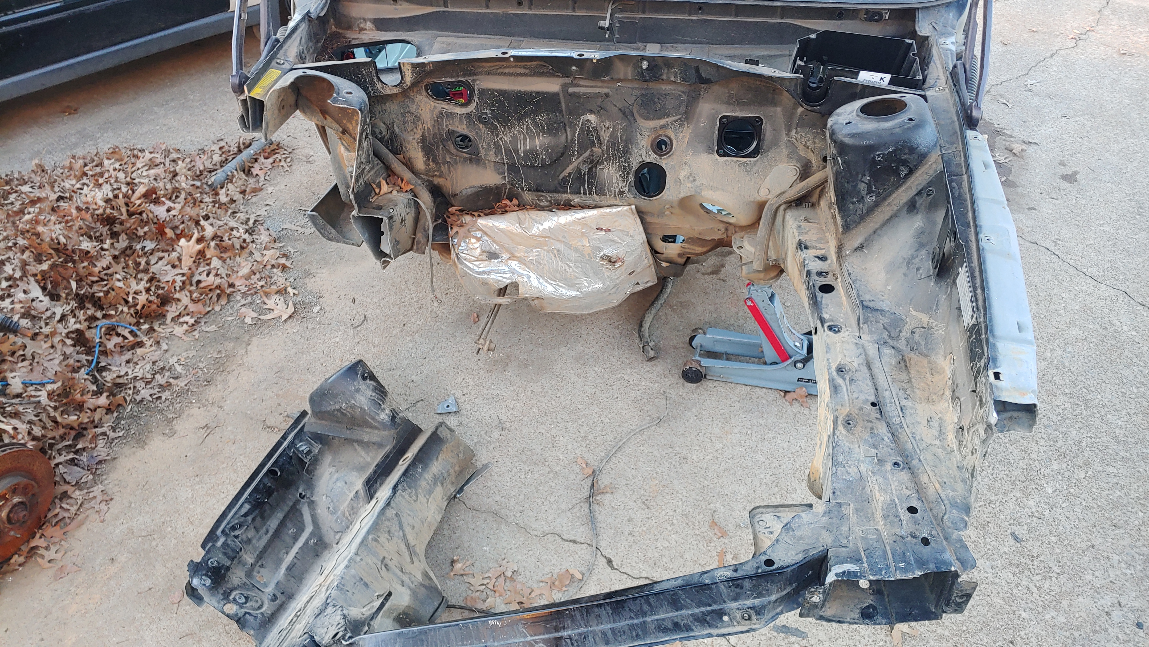

Want to know how to strip out the motor and front end fast? Then refer to my 98 xc trailer conversion pics. Of course place cinder blocks under the subframe and lower entire car before disconnecting subframe :P :lol:
