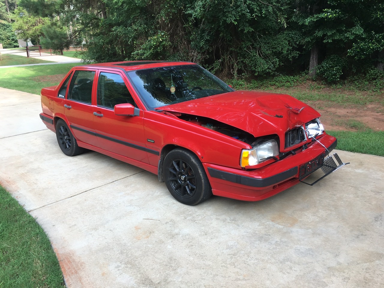

My beautiful, deeply beloved 850 had a very unfortunate encounter with a deer :( though my Volvo came out winner (while they are a bit of a nuisance to cars, still my condolences to the deer) it still took a very serious beating on her front end. Now, I have a few interchangeability questions hopefully someone here can assist me with.

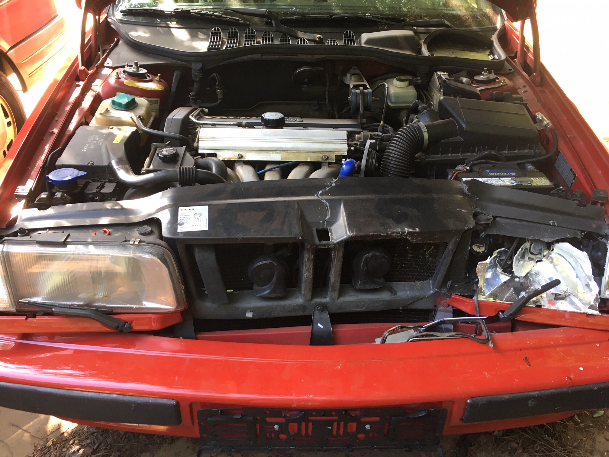

The core support I’m referring to is the fiberglass piece on the front end. The headlights mount into it as well as holds those relays above fan etc. On my ‘93 it has a split down the middle and the later ones are solid. I believe the later ones may fit, however. Here’s a straight on pic of the core support. I’m referring to:
The horns are also mounted to it. '93 has that split down the middle in the center of the core support but that is the only difference I am able to tell from looking at images of the later years (which are solid in the middle). Even the headlight mount holes (thought headlights are slimmer on later years) still appear to be the same size as my '93. If this is the case I can easily simply yank one of these at salvage as well as opposed to buying a high price 1993-only reproduction online.

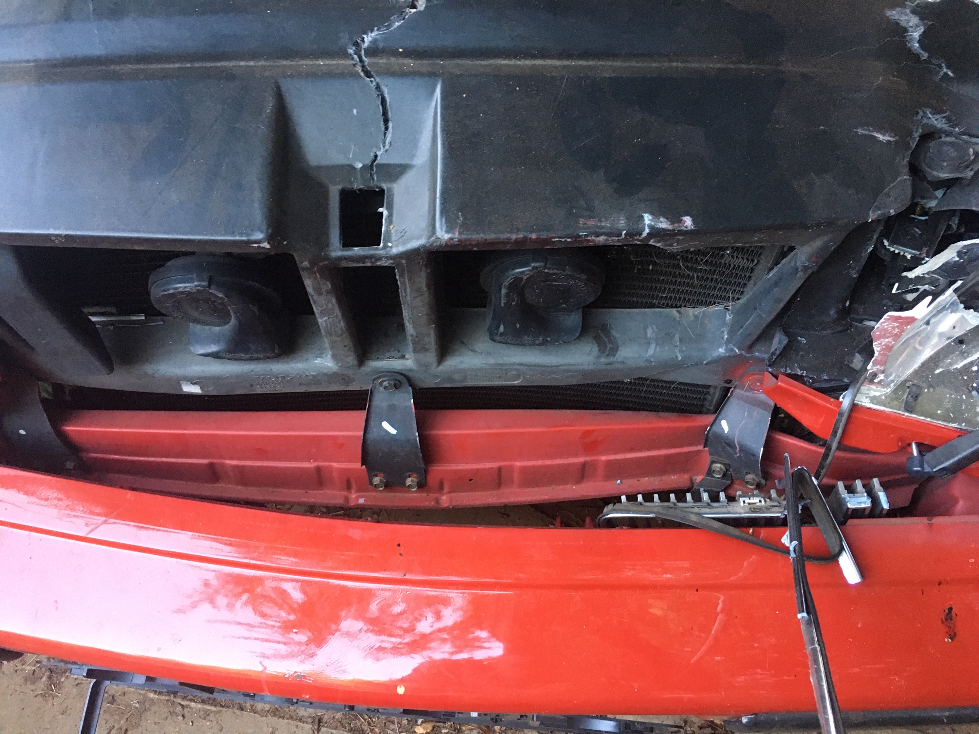

This Fiberglass piece (what I understand to be the “core support) then mounts to a metal piece below it:
It is not the subframe or cross member. It’s (comparatively) fairly thin metal. I may just honestly bang it out if I can’t find a reproduction. But, being thin, tack welded in, and in the front end I would imagine someone reproduced them at some point for repairs.

The metal piece is the crash bar. The fibreglass part is called also called slam panel in other parts of the world.
