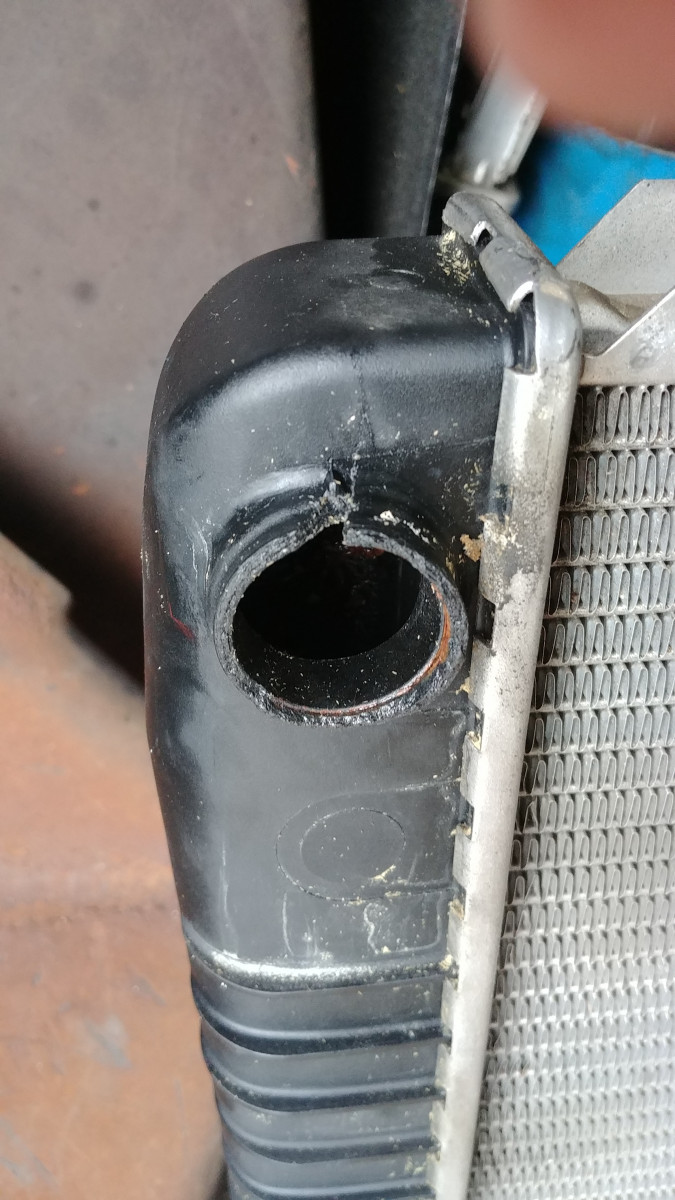

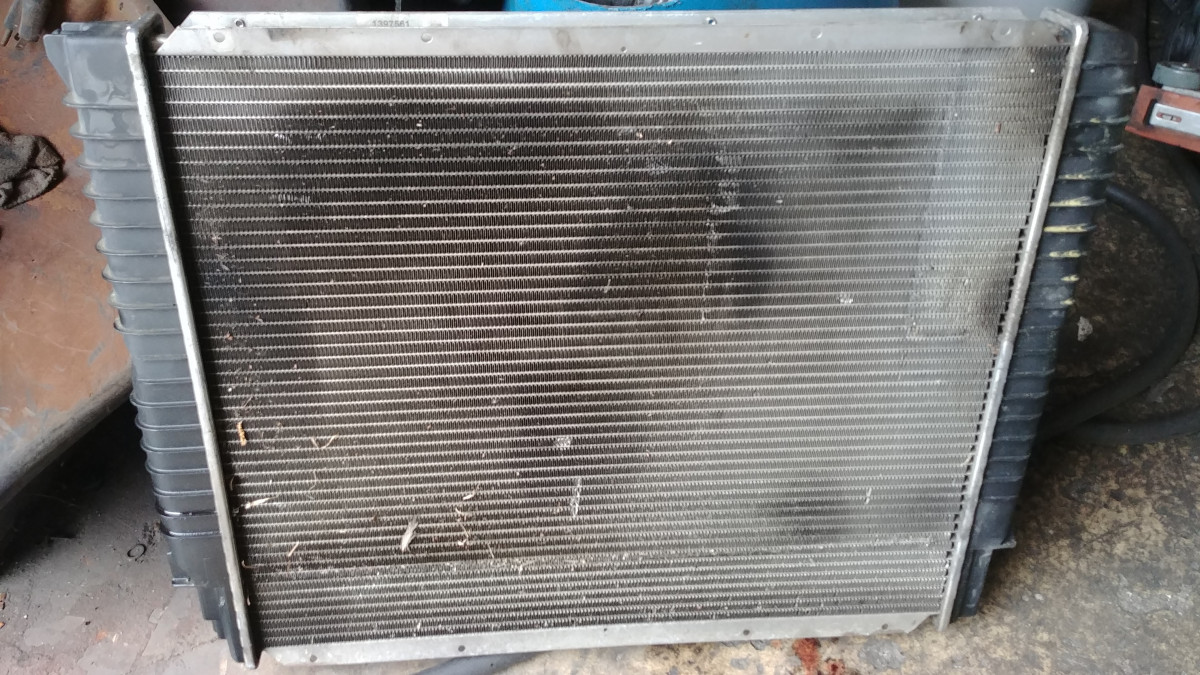

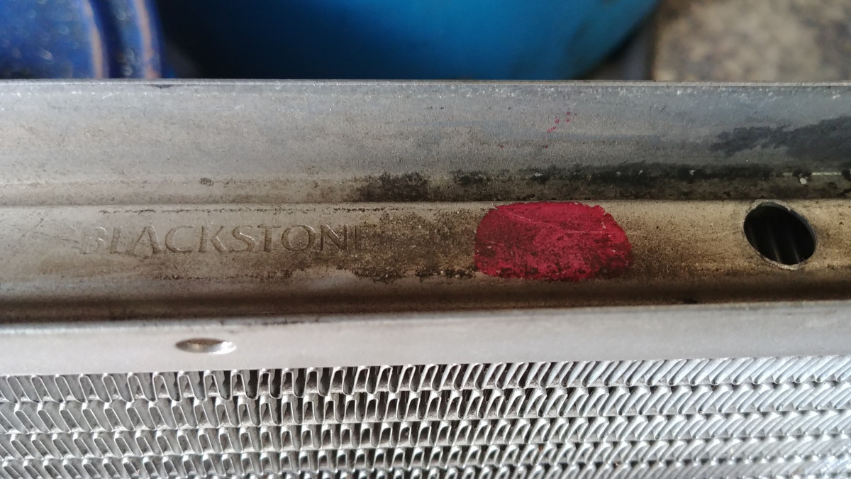

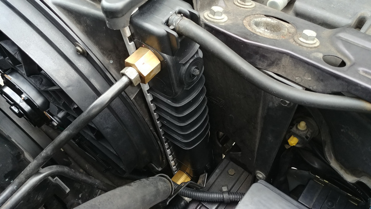

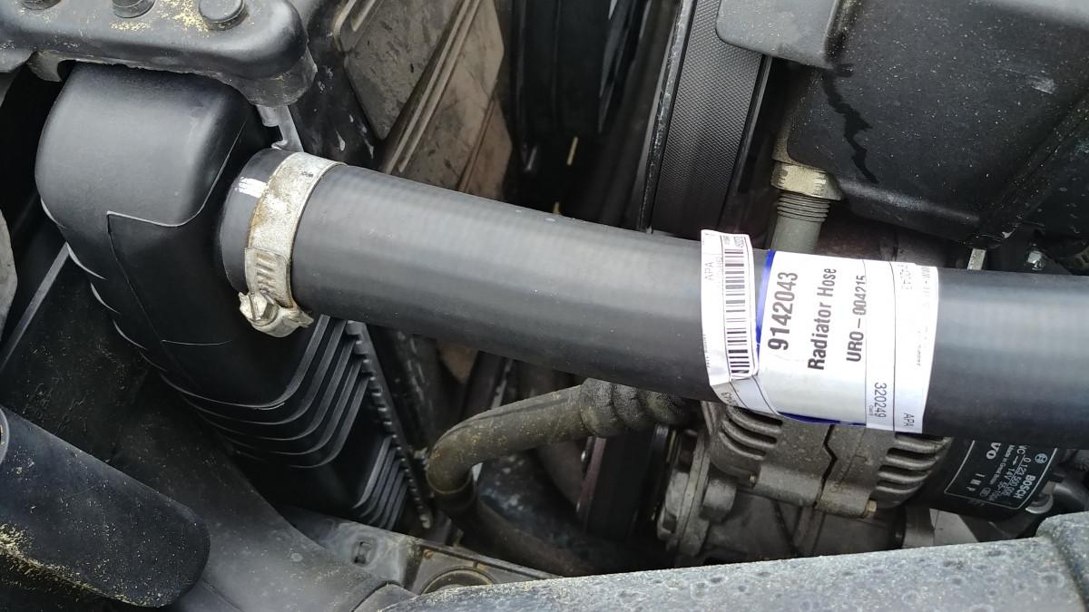

Got the car back and there is a crack in the radiator tank near the upper hose. Doesn't appear to be any coolant left. Going to replace the radiator and also the hoses and thermostat for good measure.
Guess it's just old age - 23 year old plastic. It wasn't leaking at all prior to this trip and was pressure tested a month ago. Oh well - back luck I suppose.
As far as collateral damage, it may be too early to say. Car started up fine and sounds normal when idling and on a short drive off the tow truck and another short test drive when cold. No obvious signs of other leaks.

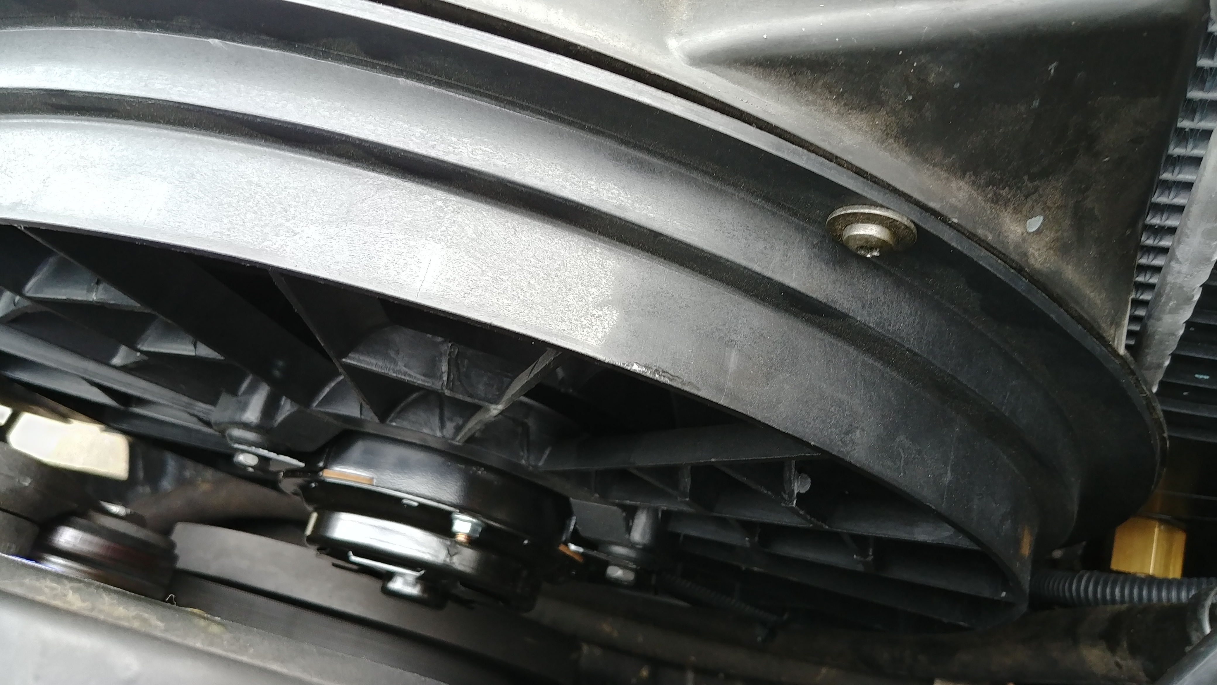

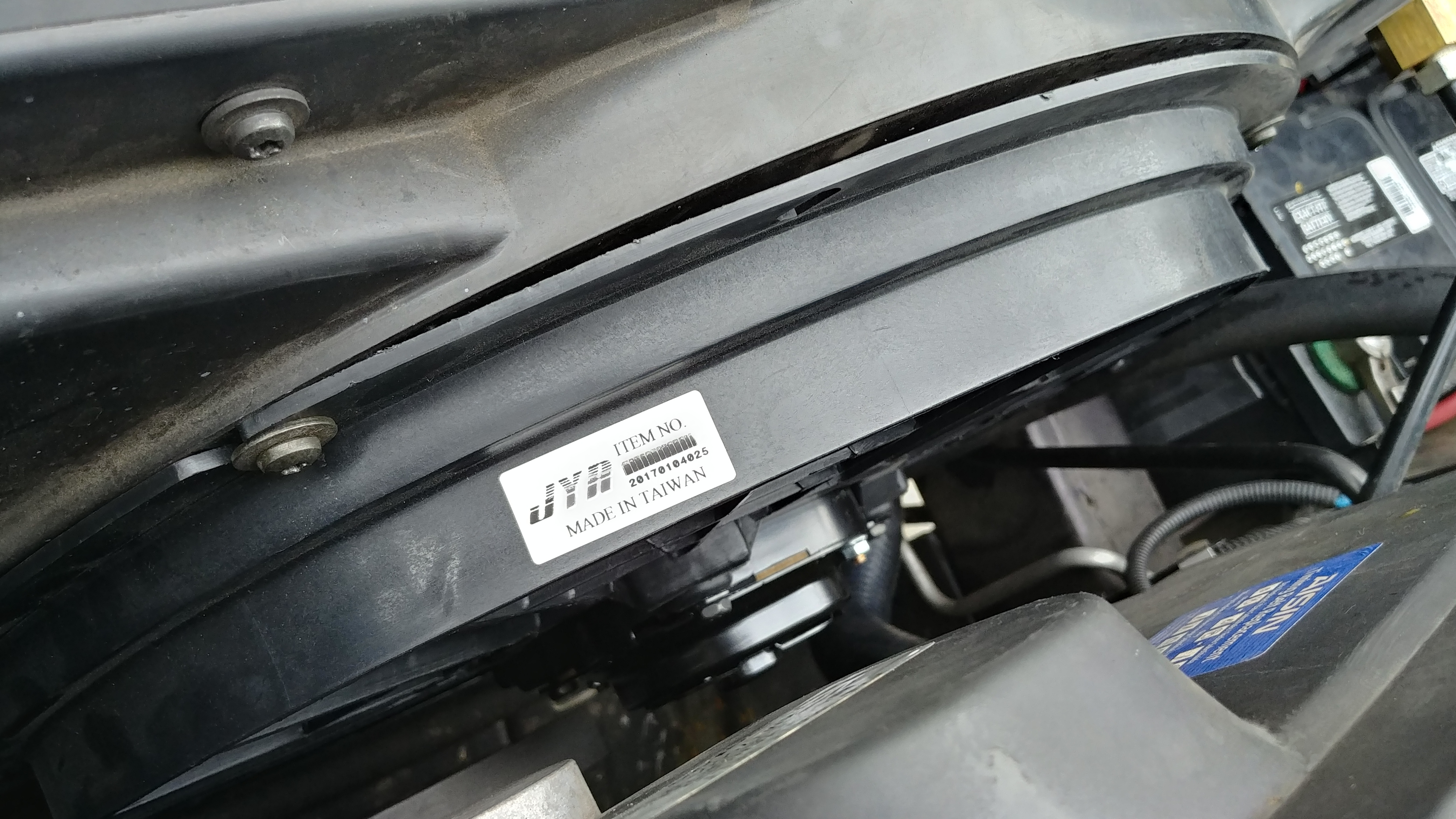

The culprit is the radiator fan. It blew a fuse - replaced the fuse and it blew again. Looks like the fan motor seized. Getting a Dorman replacement.
So I suppose the sequence of events was the fan stops and next the pressure builds with the higher temp of the coolant. But instead of the coolant tank top blowing off to relieve the pressure (and save the radiator), the plastic on the radiator tank cracks. Just my good luck I guess.
