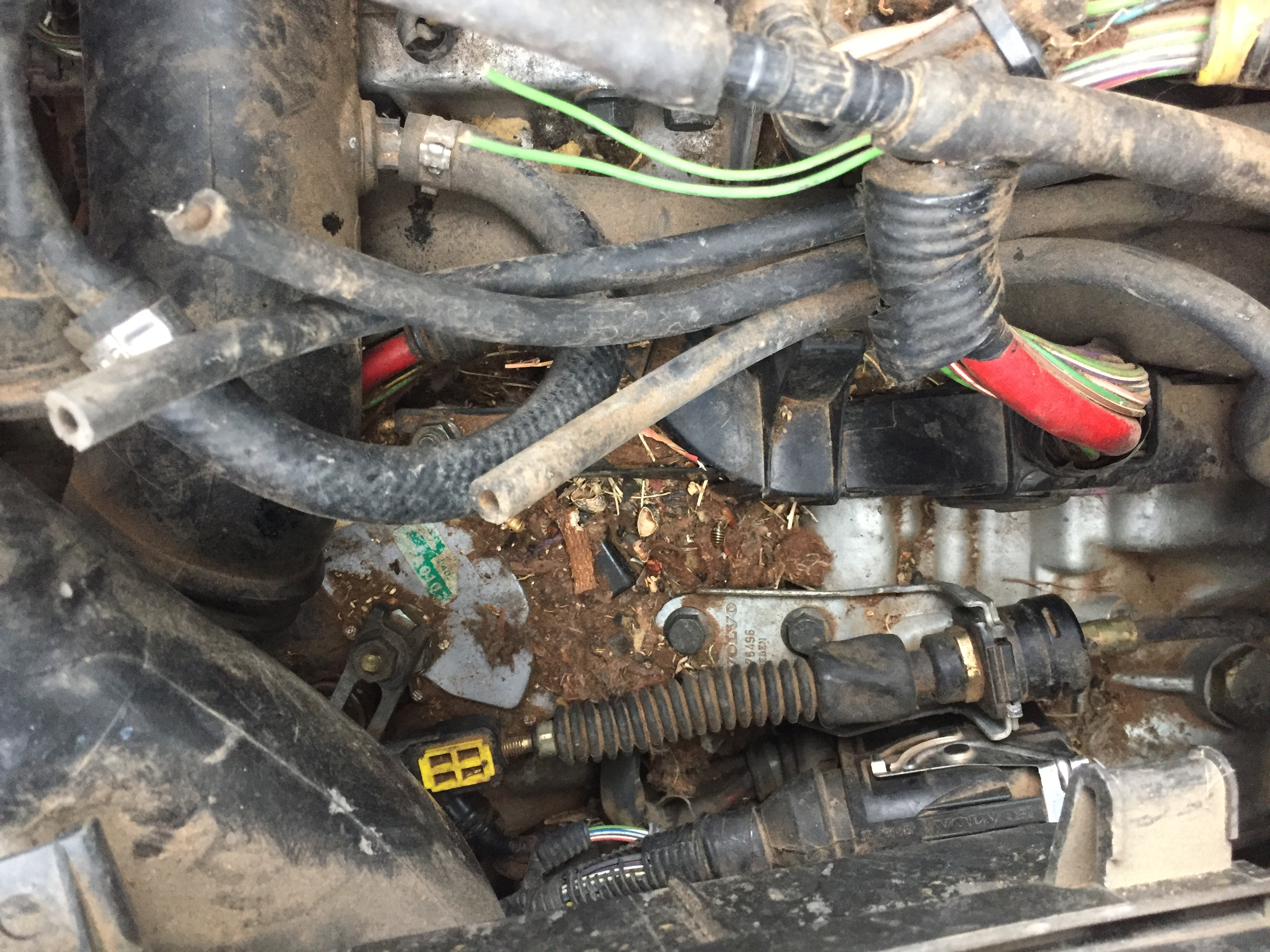

I tracked down the owner of an abandoned v70, and in short, he gave it to me. Someone began stripping it, and piecing the puzzle back together I noticed two cut green wires and three hoses (vacuum lines?), and a couple places to bolt something down. The void is where a throttle body would go, between the engine and airbox, drivers side, but it’s turbo so I don’t think I need one of those. Does anyone know what would go there? Oh, and there is no key, so that’s another thing.

The turbo boost control valve goes there. Three hoses and two wires. A cheap part and one you can find at a junkyard..

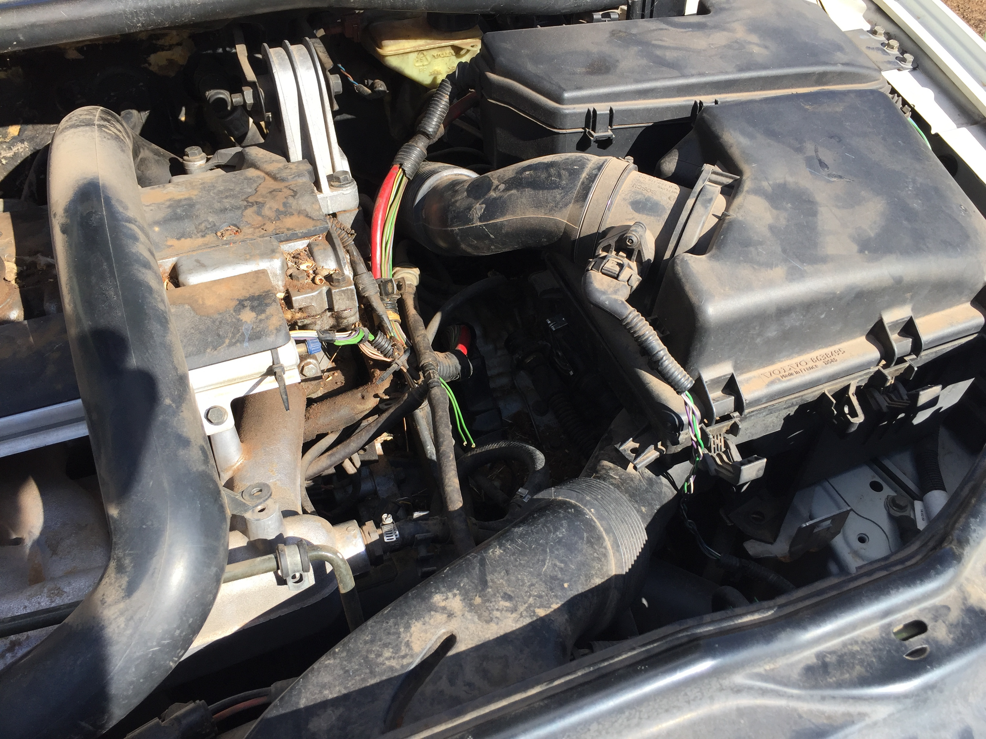

The throttle body is attached to the intake manifold. Follow the air pipe over the engine from the turbo to the air cooler, then from the drivers side across to the engine.
On the 2001's the Italian throttles often fail due to the throttle plate position sensor wearing out. Xemodex in Canada provides repairs.and replacements - including touchless sensors.

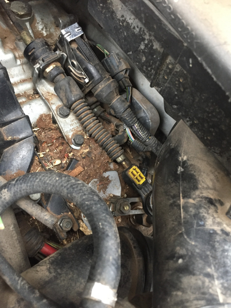

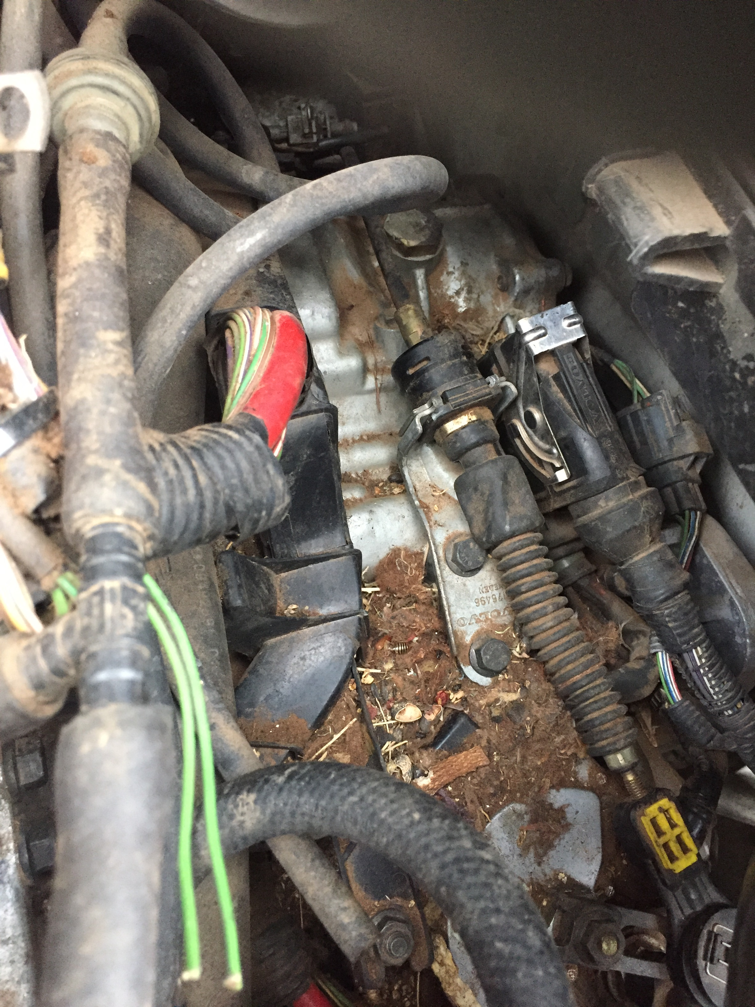

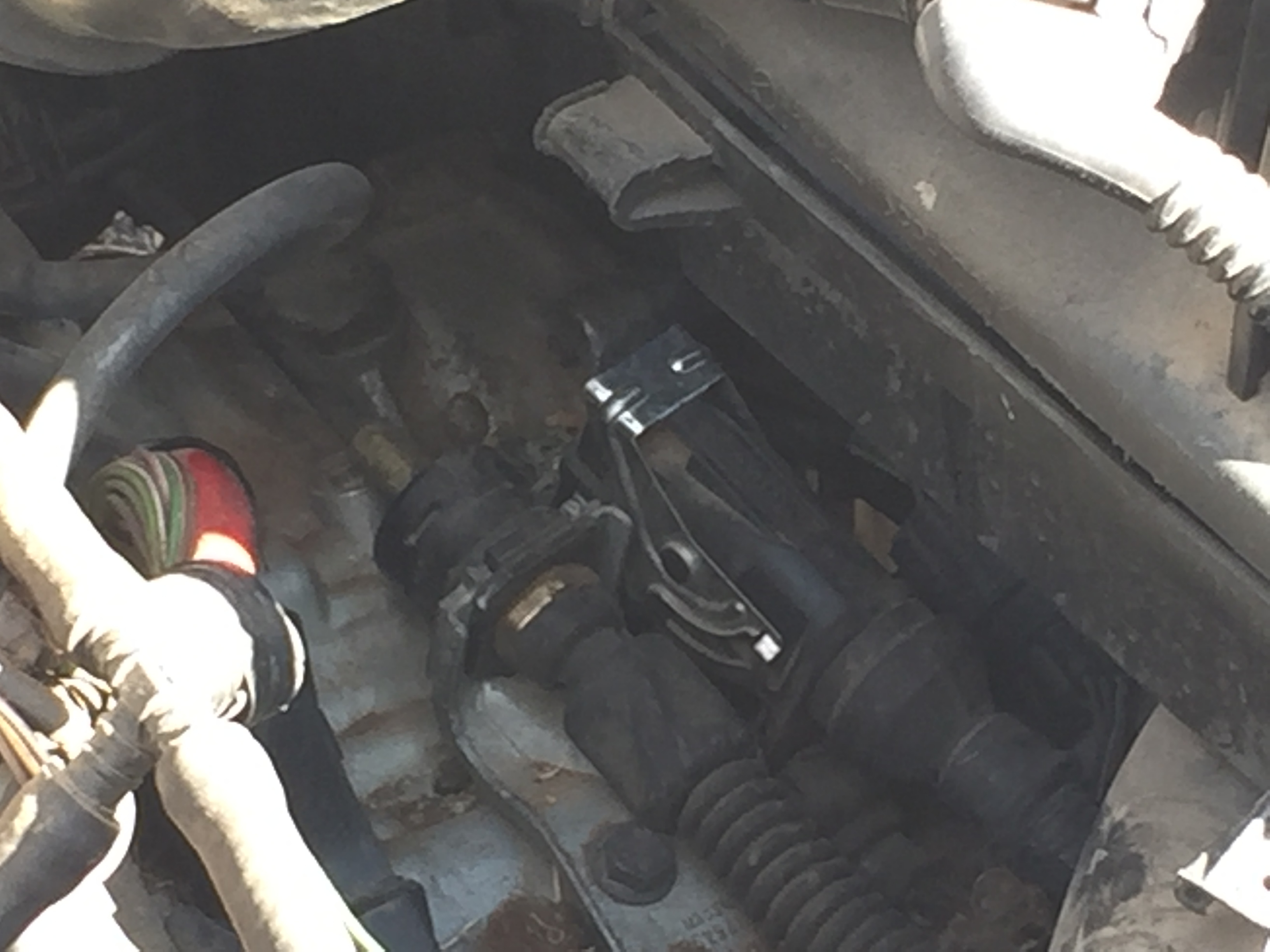

Also check if the BCM (brake/ABS module) is in place, I see its connector laying under the air filter box.
Also not sure about earlier P2, but you may miss a brake vacuum pump (deep under air filter box) and a 3-way valve (in front of the air filter).

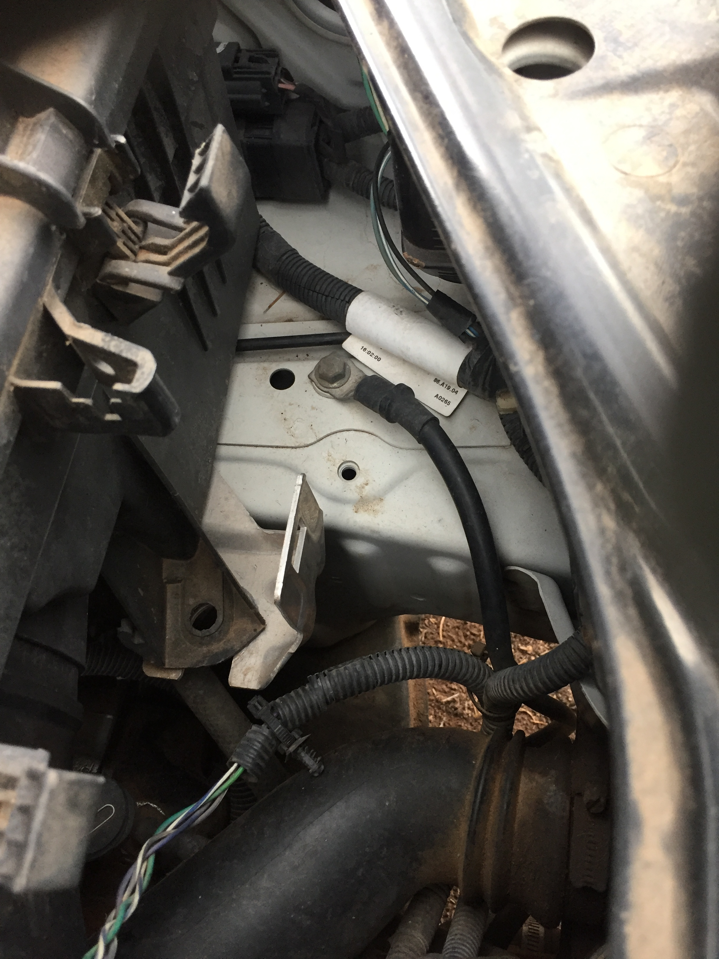

Here are much better pictures. It seems whatever goes in front of airbox is missing and it looks like it might be big as a coffee can. ABS unit? And between the engine and airbox is a space for emissions/fuel control.
