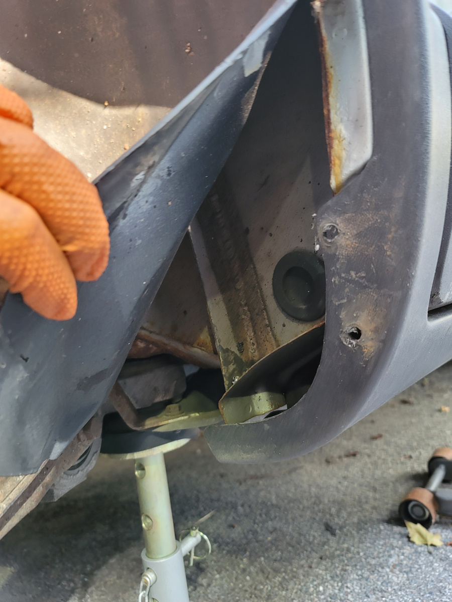

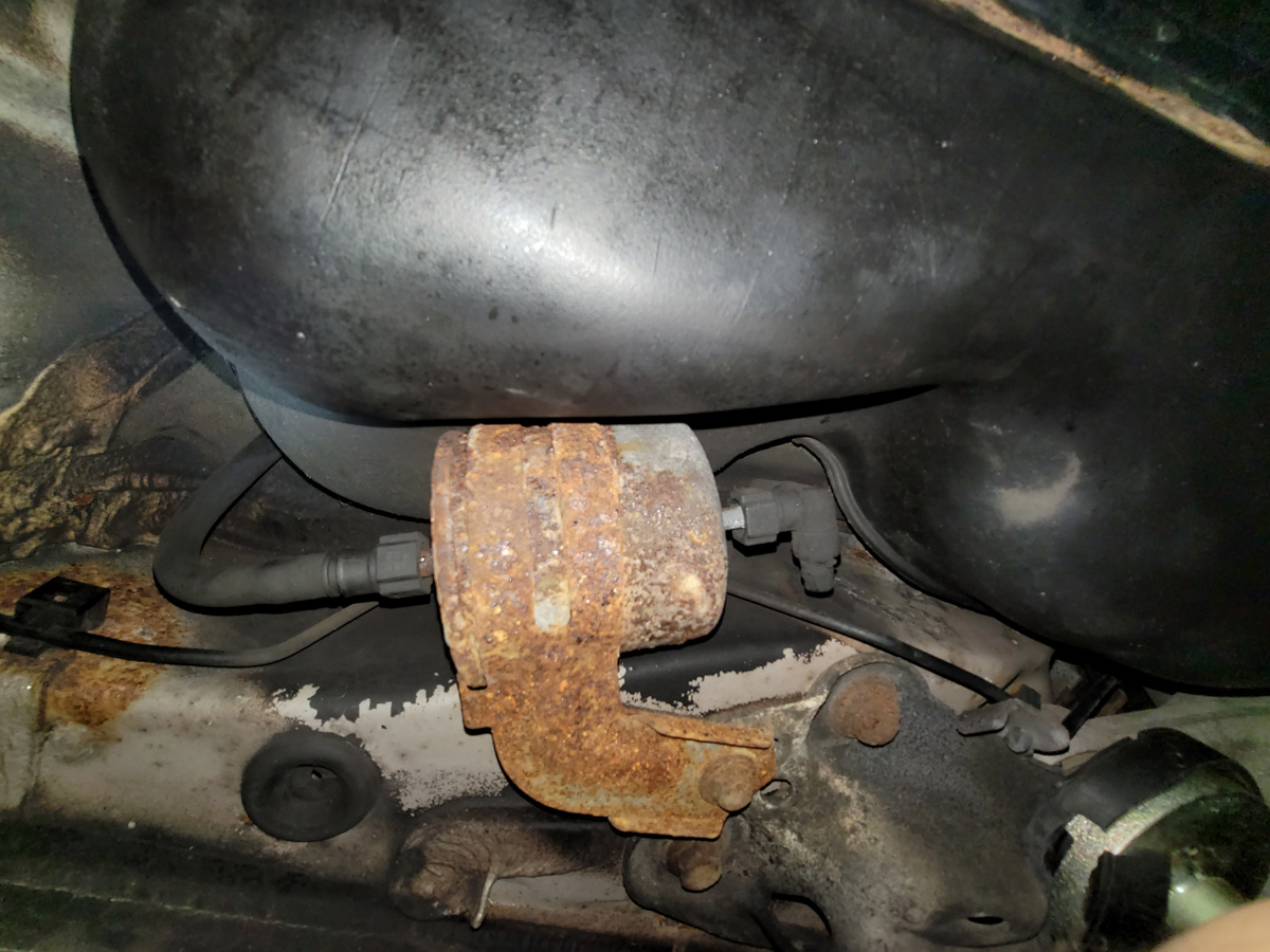

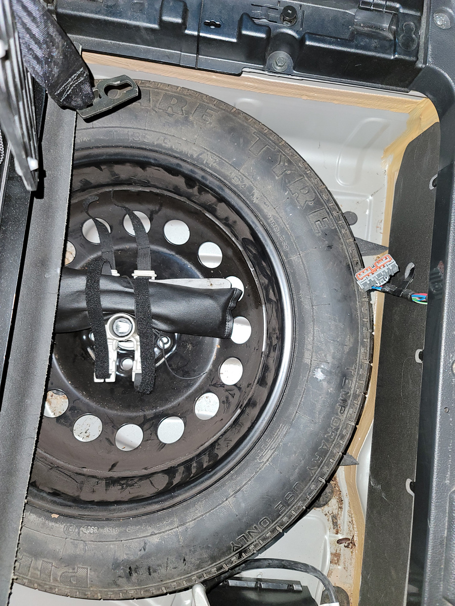

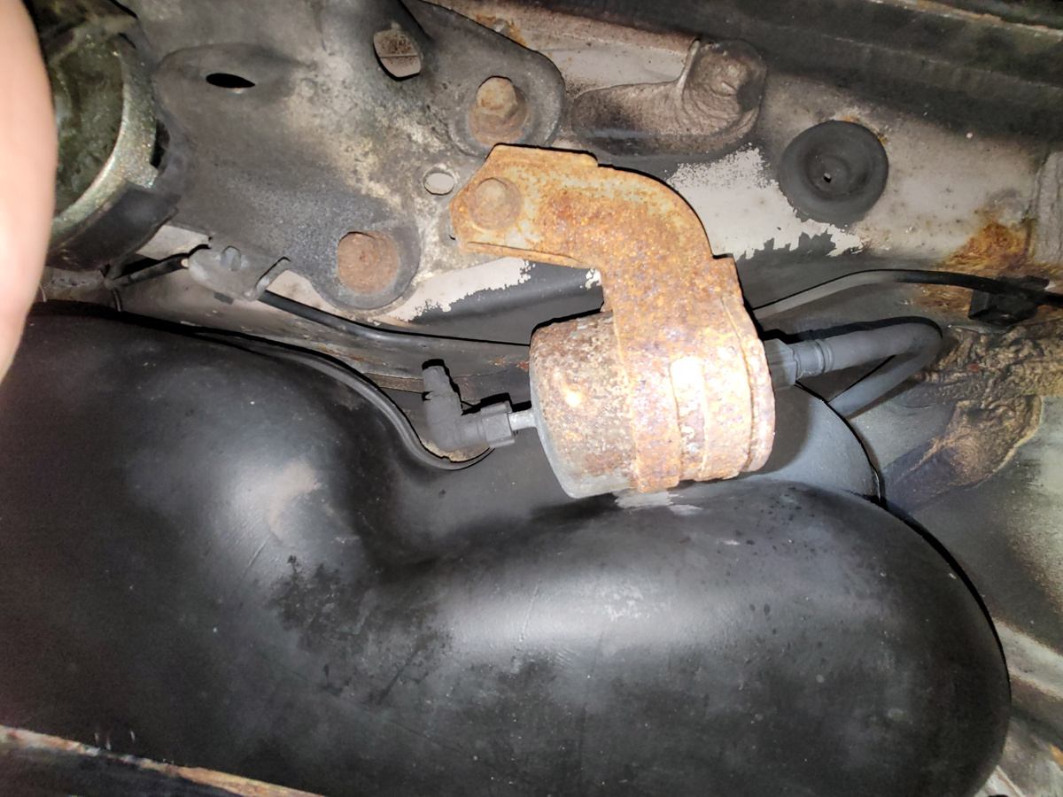

Saga of the missing PEM - PEM is not on top of the gas tank. The tank does not look like the metal tanks with the PEM on top and the too clearance seems too small. Plastic tank? Also did not find a PEM next to the fuel pump, in the spare wheel well or behind the right rear fender liner. Please see pics (the jack is secondary to a jack stand also in place out of view). The spare wheel well does have what looks like the PEM connector shown in other threads (obviously not connected to a PEM). Could the modification have been done to move the PEM to the spare tire area but the PEM no longer be present (or required)? Or is this connector intended for something else (that is missing)?
- PEM not in wheel well.
- 2021-09-06 19.02.11_1200px.jpg (606.53 KiB) Viewed 913 times
- PEM not behind right rear fender liner.

- PEM not next to fuel filter.
- 2021-09-17 22.21.44_1200px.jpg (364.16 KiB) Viewed 913 times
- PEM not above fuel tank.
- 2021-09-17 22.22.42_1200px.jpg (385.79 KiB) Viewed 913 times

The early P2s don’t have a PEM but I thought by 2004 PEM was used. Vida would tell you of course

thats the tow bar connector near the spare tyre. when was your fuel filter changed or is that rust normal?

Thanks regarding the toe bar connector. It is time for a fuel filter change but the rust may also be "normal" given New England's salt covered winter roads.
