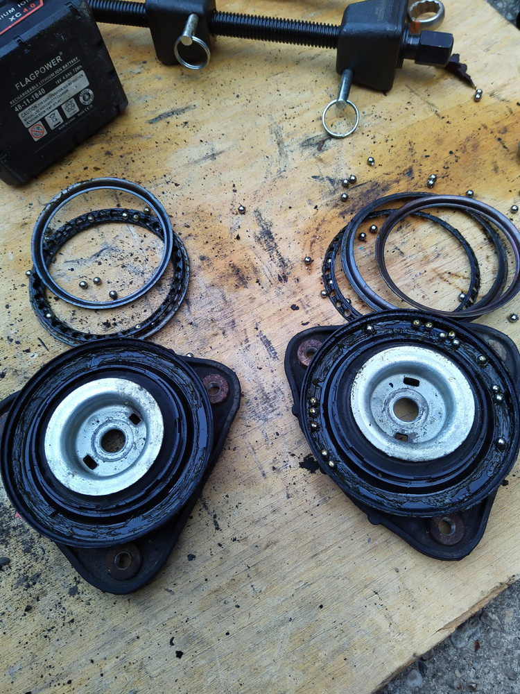

After setting up my spring compressors and running them down, I was able to zip off the 18mm nut on top of the strut pretty easily with my Milwaukee mid-torque. When I pulled off the strut bearings from the strut mounts... it did this.
Desperate need of replacement, right? Broken bearings here, though, didn't really affect driveability. By my calculation, we've done a few K miles with this noise. So anyhow, the job is fairly straightforward. And there was no fear or springs shooting up into the hood of the car. The strut mount is a piece of steel covered in rubber. (The original strut mount was still in good condition. For those thinking about saving money. I would guess you could keep it and just replace the bearing to save money.)

Yes, everything I've taken off this car has been branded "FOMOCO!" Spring seat looked great. I almost considered reusing it but then said, well, I have a new piece here anyway. That's so interesting about the bearing. I was surprised that it fell apart, ball bearings spilling everywhere. Bearings were pretty cheap so I just installed the new ones I'd purchased. Car feels great... but damn clunking...

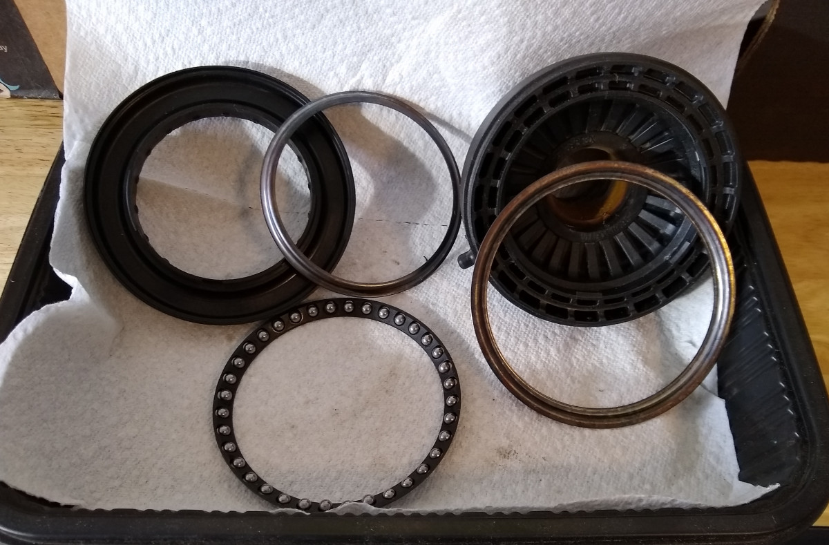

The Bearing Assembly is made to separate so mine went all over the ground when I first took it apart. Two Bearing Races, top and bottom, and Bearing Cage with Bearings in the middle. Had I lost just one bearing I would have changed it also.

I wish I'd seen a write-up on those bearings. I could've regreased. That being said, bearings do wear out... I work on bicycles and installing headsets and sometimes you see pitting on bearings and braces where water and dirt have made their way in... I'm okay with new Rein strut bearings!!

It's a toss up at those miles but being you had them might as well. Took me a bit of contemplating before deciding to reused them. The deciding factor was I found a set of news struts at around $20 so if those went bad quickly I would be in there again with Bilsteins and new bearing.theWIFES_S70 wrote: ↑23 Aug 2021, 11:42 I wish I'd seen a write-up on those bearings. I could've regreased. That being said, bearings do wear out... I work on bicycles and installing headsets and sometimes you see pitting on bearings and braces where water and dirt have made their way in... I'm okay with new Rein strut bearings!!
