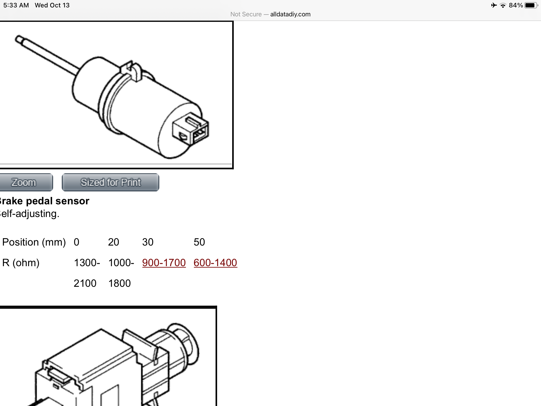

P0573 tracks to ECM-9400, which is a brake pedal sensor signal too high reading, either intermittent or permanent.
I think this uses the same sensor, check the resistance per this chart
