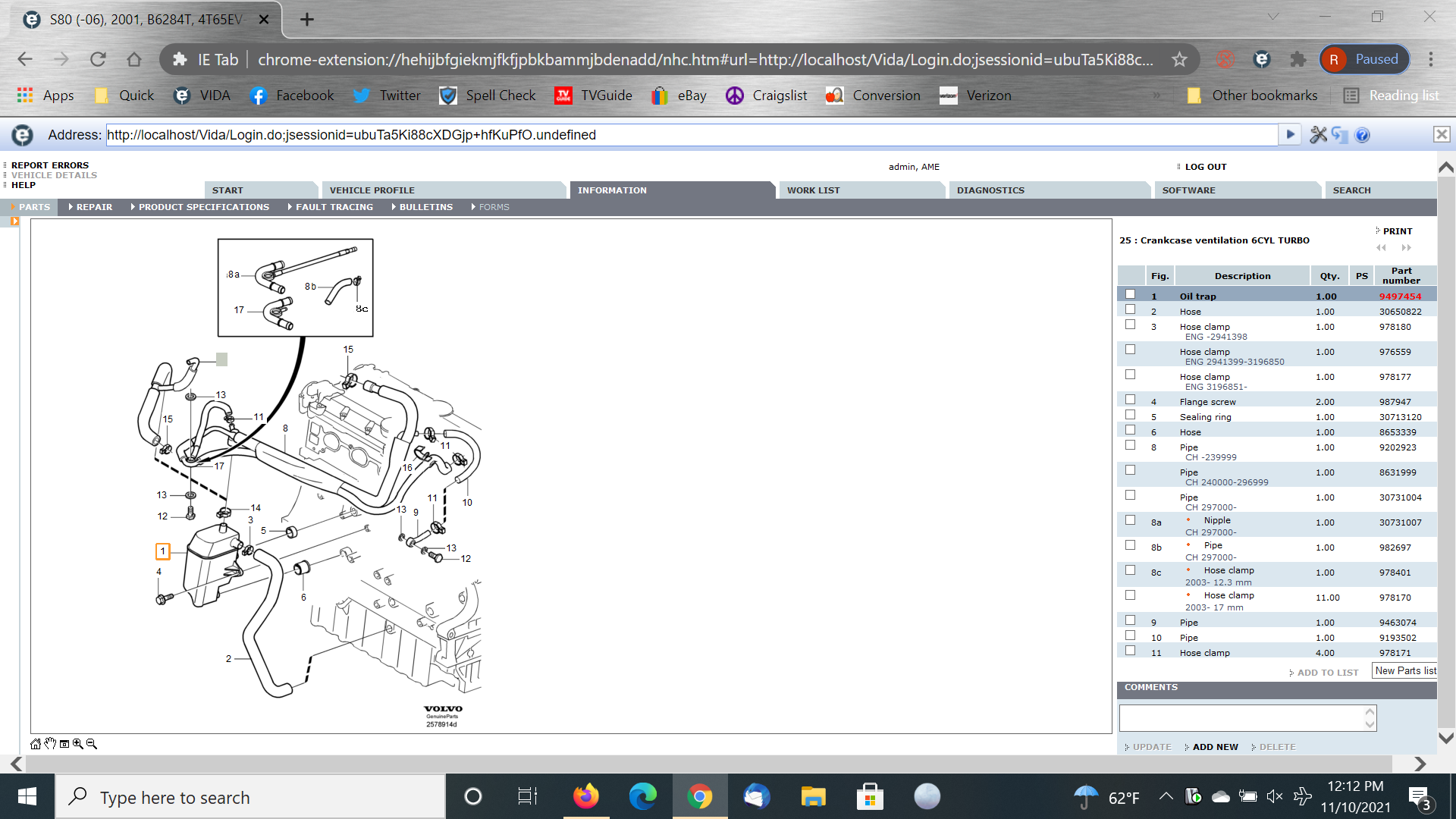

You might try cleaning the Banjo if you have positive pressure, ( bolt #12 & #17 below ). The Banjo plays the same role as a PCV valve. Clean it but don't modify it.
Oil trap is mounted on the front lower side of the block, #1.

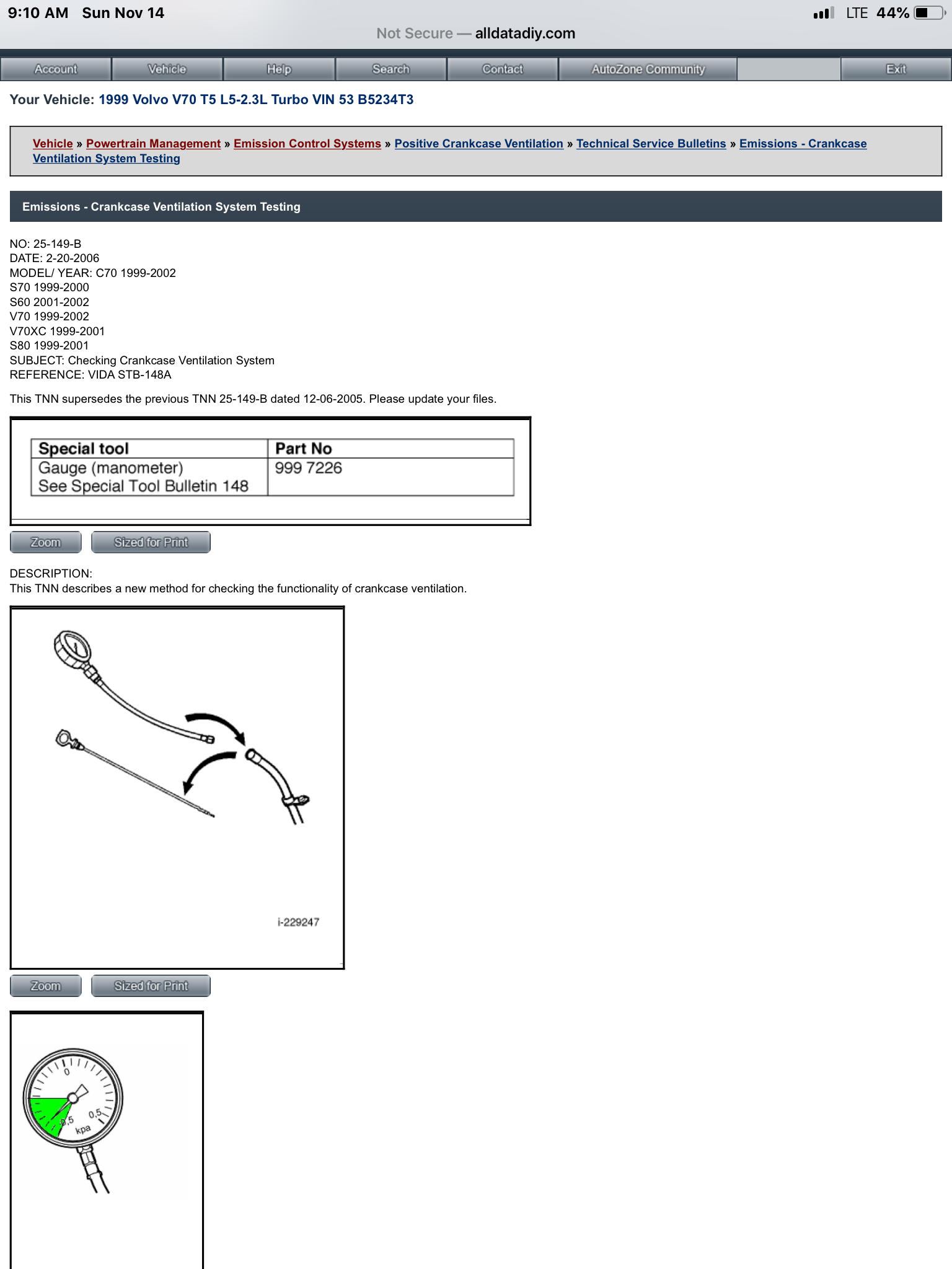

Posts: 36171
Joined: 17 Feb 2013, 17:54
Has thanked: 1613 times
Been thanked: 4077 times
There is a TSB on the actual measured crankcase vacuum, measured at the dipstick , of better than 0.2 kPa vacuum. This is to be used as a diagnostic for PCV evaluation, not a guide to cleaning.
