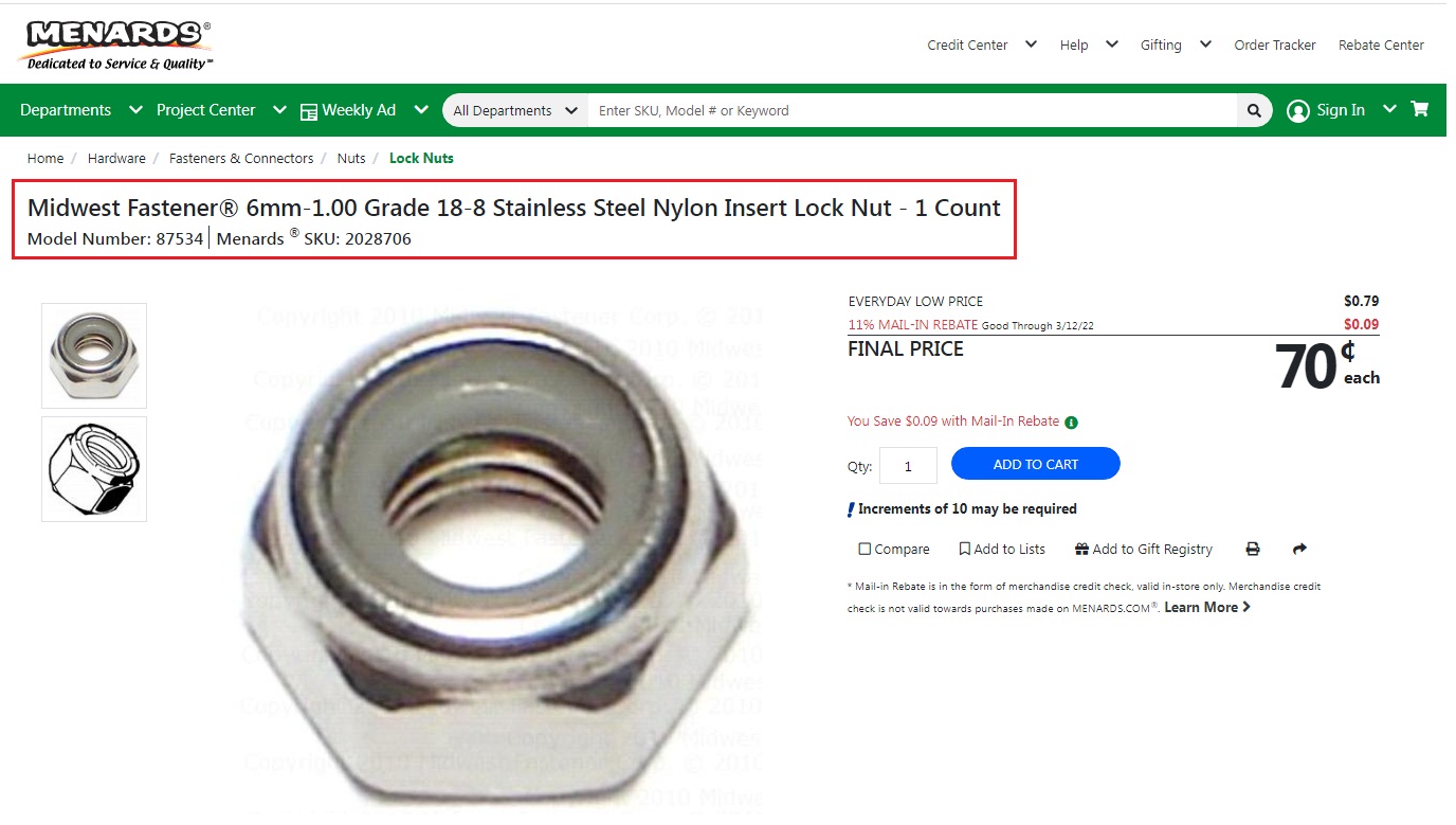

Over the years, I have learned that:
- The Volvo factory nut is regular steel and it will rust with time, especially in the midwest with salt.
- It can seize with time if antiseize is not used. Some people break the stud off while removing the nut.
So, I have been using these M6 x 1.0 stainless steel nuts (with nylon insert) for years with no rust.
I always applied some antiseize on the threads, removal is not an issue even years later.
Price for Midwest Fastener 87534 is $0.79/each at Menards hardware stores.
Volvo dealer nut is $3.79.
The nice thing about this SS nut is: you can always spray some PB Blaster or oil before removing it.
The key thing is: don't over-tighten it, just snug it until it hits the license plate, then stop.
