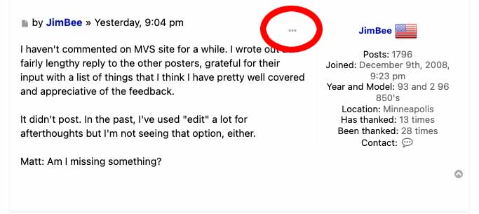

I haven't commented on MVS site for a while. I wrote out a fairly lengthy reply to the other posters, grateful for their input with a list of things that I think I have pretty well covered and appreciative of the feedback.
It didn't post. In the past, I've used "edit" a lot for afterthoughts but I'm not seeing that option, either.
Matt: Am I missing something?
- Posts: 14800
- Joined: 14 Sep 2002, 11:03
- Has thanked: 2856 times
- Been thanked: 1332 times
Jim, I'm sorry the site ate your post. I don't know of anything on this side of it that would have caused that.
Editing is alive and well. Click the three dots and it's in there. If you're on a larger desktop computer, it'll be the pencil icon in the same spot.
