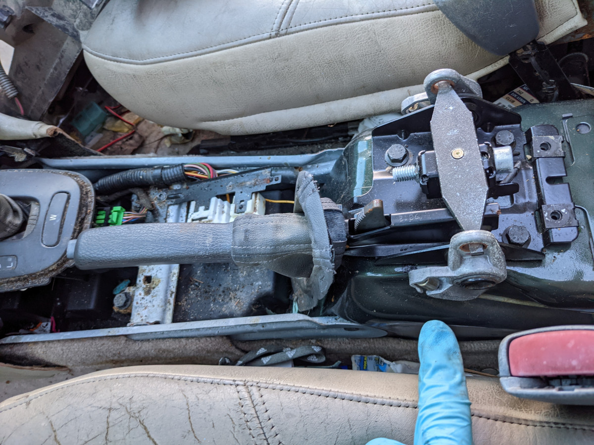

I would not be surprised if that's what happened. You can see what was left when I opened up the console.MoVolvos wrote: 07 Jan 2022, 23:14 *
Some people just yank the handle for all it's worth hard and fast so anything could have happened. Need to remove the cover and check the cable at the handle then work your way back.
I wonder if in his rush and overaggressive pull, he just stretched them out a bit. Cables are still attached at the handle, and at least I hear cable movement when I pull the handle. Going to attempt an adjustment today.

99TurboBrick wrote: 08 Jan 2022, 09:32I would not be surprised if that's what happened. You can see what was left when I opened up the console.MoVolvos wrote: 07 Jan 2022, 23:14 *
Wow, wouldn't want the guy to tighten lug nuts with an airgun! Hope they'll do the work and replace whatever was stressed or broken.
