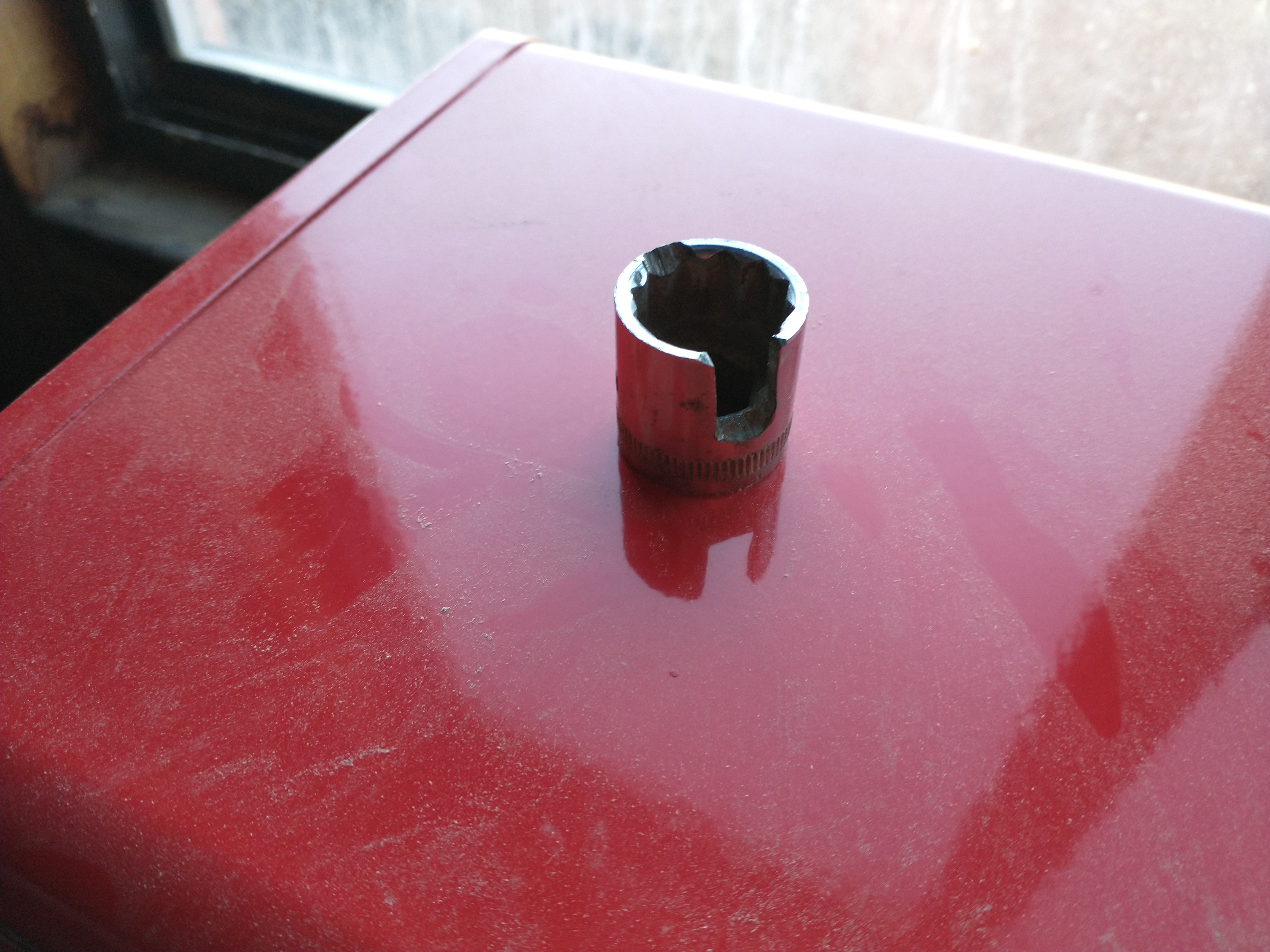

I would say - yes. Your ect is the culprit based on the symptoms. Clean the connector when you replace it.
Can be a PITA to remove, so I notched a cheap socket for the job.

Accessing the sensor is the issue. Not much room to turn an open-ended wrench in there. Even if you cut the wires off of the old sensor, you're still going to have to figure out how to tighten the new one with the wires attached.
Sveedy's modified socket is a good idea. Kind of like the split O2 sensor wrenches.
On my car, the old harness had disintegrated, so I'd already replaced the connection with another weather-tight connector. I just removed the pins from the connector pigtail so I could get a closed-end wrench down around the sensor to remove it. Opening up a stock connector usually invites things falling apart. If I needed to leave the connector intact, I'd go for the slotted socket.
