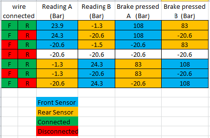

Thanks for the tip on cleaning the connectors. I actually over looked that. I went ahead and cleaned the connectors at the sensor but wanted to log some data before tearing everything apart to get to the other ones. Before connecting the sensors back up I used a multi meter to verify I at least was getting my 5 volt supply and had good ground. This left only the sensor output which I will check the continuity when I remove everything to get to the other connector. I used my scan tool to get the readings coming off of each sensor. Without pressing the brake, Sensor 1, the one more front, was giving a reading of 23.5 bar, while sensor 2, the one behind it, was giving a reading of about -1.1. So I set up a little table to help trouble shoot. I systematically disconnected and reconnected the wires and took measurements every time. I then switched the wires to where sensor 1(the front one) was sending to sensor 2 output on the scan tool and vice versa. In order to keep myself from getting confused, I named the output "Reading" so I would keep it straight that i was looking at what was being displayed and not the actual sensor 1 or sensor 2.
In looking at the data, it looks like the readings stayed with the physical sensor. This is hopeful. Had the reading stayed with the wire regardless of which sensor it was connected to, I would be willing to bet money the problem was in the wires or the control. I am thinking that one of my sensors is bad. Does my conclusion look reasonable or am I missing something?
Tomorrow, I'm still going to disconnect the connector on the control module and clean out the connector just to make sure. After that I will likely go ahead and order new sensors. I personally don't like just swapping parts until things work. Not just because of the cost but I always have that lingering question of did I actually fix what was causing the problem. Let's face it, brakes are something I don't want to have those type of lingering questions.

I wanted to give an update in case anyone else is running into a similar situation. I went ahead and purchased two new sensors. The sensors were only about $40-$50. With the way my luck runs it wouldn't be long before the other one went out too, The code cleared and the two sensors are only showing a difference of about 2 bar with and without the brake being pressed. I still want to get out on the road and test it out a little more but there are a few more things I need to get taken care of first since the car was sitting so long. Once I do get out and test drive it a little, I'll post an update. One interesting note I did noticed while trying to troubleshoot is that when I tried to calibrate the old sensors just to see if that was contributing to the problem, it gave me an error saying it could not detect the sensors. Now when I tried again with the new ones, it detected them just fine.
