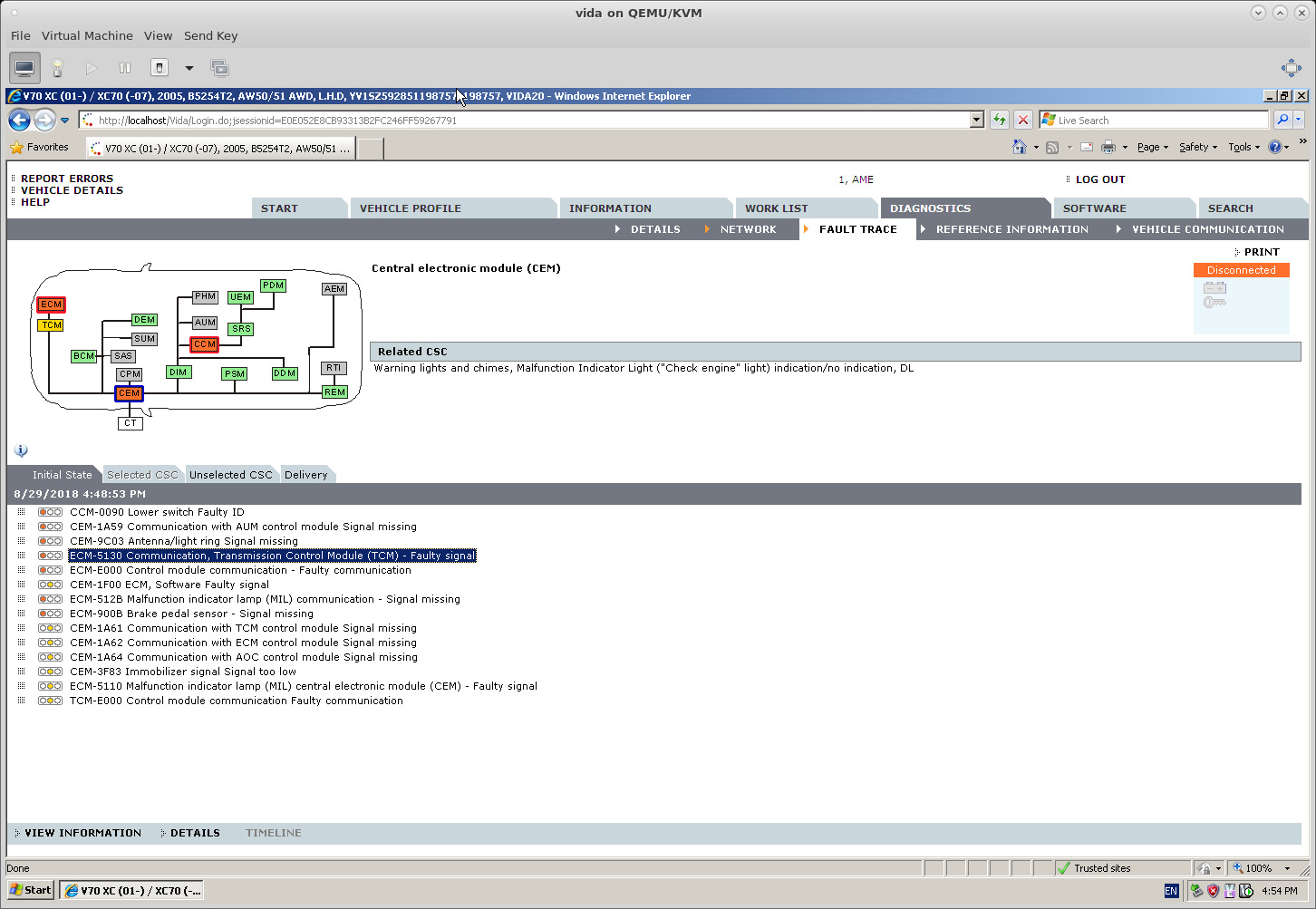

CAN-related error, something spoils high speed bus. Try to unplug DEM (Haldex computer) and see how is it going.
Errors I've got when my DEM quit:
It cracked it opened and found water leak past the seal and oxidation on the PCB. One resistor's pad was completely destroyed, that ruined CAN communication on the whole bus (CAN is a shared bus).
