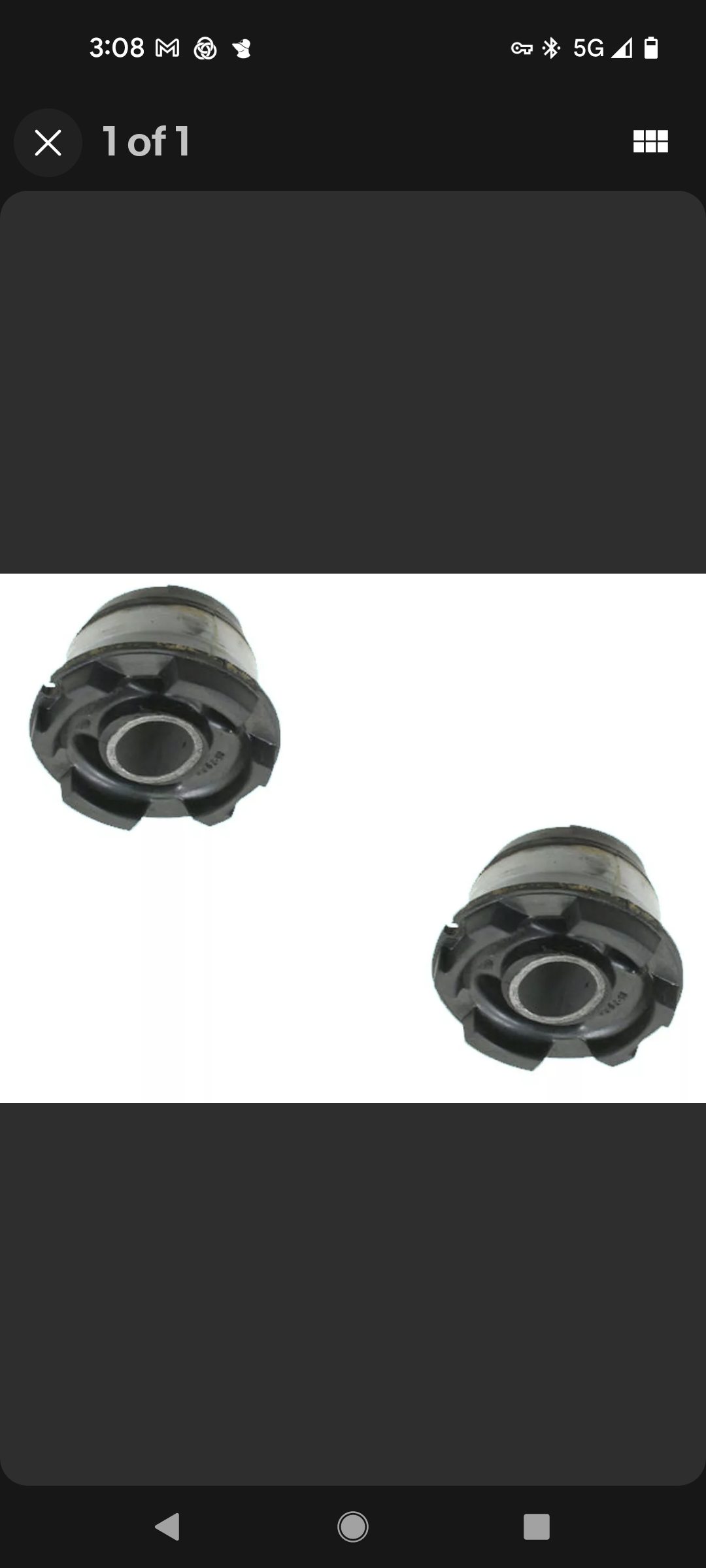

I now highly recommend that if you purchase subframe bushings, or any other parts that you do so through Volvo or through a trusted company such as ipd.
I just had a really nasty experience buying parts on eBay.

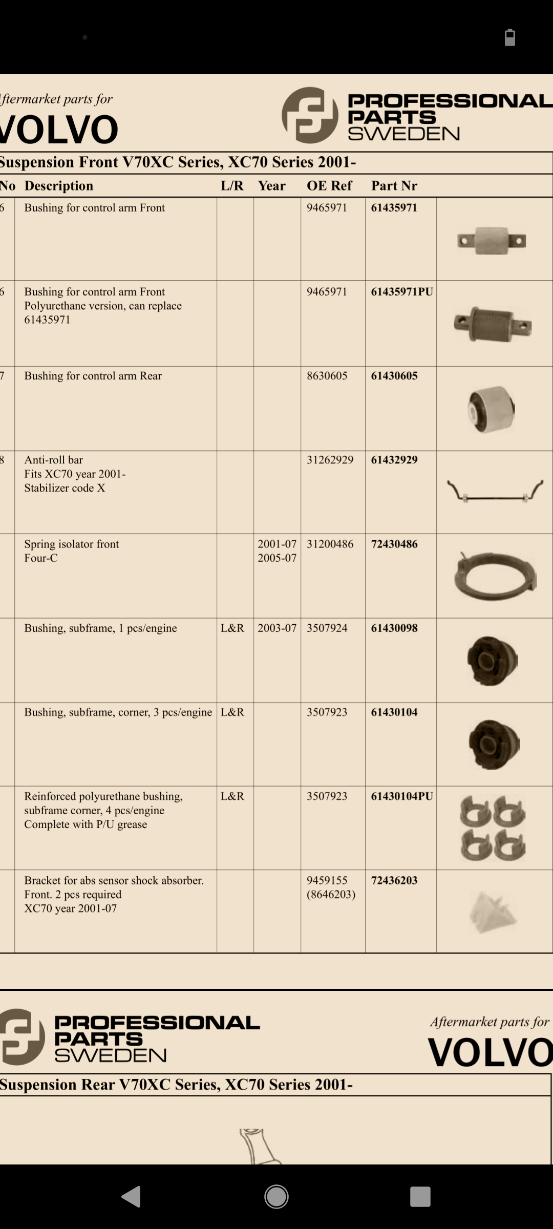

There are two different part numbers for front bushings on these cars, one with a perfectly round hole, and one with an oval shaped hole.
The oval hole bushings go in the left rear of the front subframe. The other three will be round.
You can replace all 4 with round.
I ordered two oval hole bushings from a seller on eBay and received round ones. His photo shows it as oval and the photo for his part number shows that it is oval. The parts were drop shipped from imc/parts authority
Why two? I am going to try something that may or may not work, adjust caster.
I went and double checked on the manufacturer website and the photo is an oval bushing:
https://www.proparts.se/en/artiklar/bushing-lr-43.html
There is a second part number that also has the same photo I ordered this part from a different seller and it is an oval bushing.
https://www.proparts.se/en/artiklar/bushing-lr-42.html
If you look at the notes on the manufacturers website they correlate with the bushings I received.
I emailed pro parts Sweden and imc about these issues and have not heard back yet.
This has been one of the worst experiences I have ever had on eBay and I've been using it for 18 years. The seller has tried every trick to stop me from returning these bushings. It looks like he's done this to many others in the past as well. I still have not gotten a refund and I may not.
Link to seller:
https://www.ebay.com/itm/2-Left-Right-F ... 1768411624

Volvo only lists 1 part number for the OEM subframe bushings, the oval bushing in the driver's side rear was only delivered on new cars for whatever reason. I would suggest that the only way you will be able to effect caster would be if you had all four bushings with oval holes as any repositioning of the subframe rear would return to neutral position when the front subframe bolts were tightened. I would also discourage from using aftermarket parts for this application.

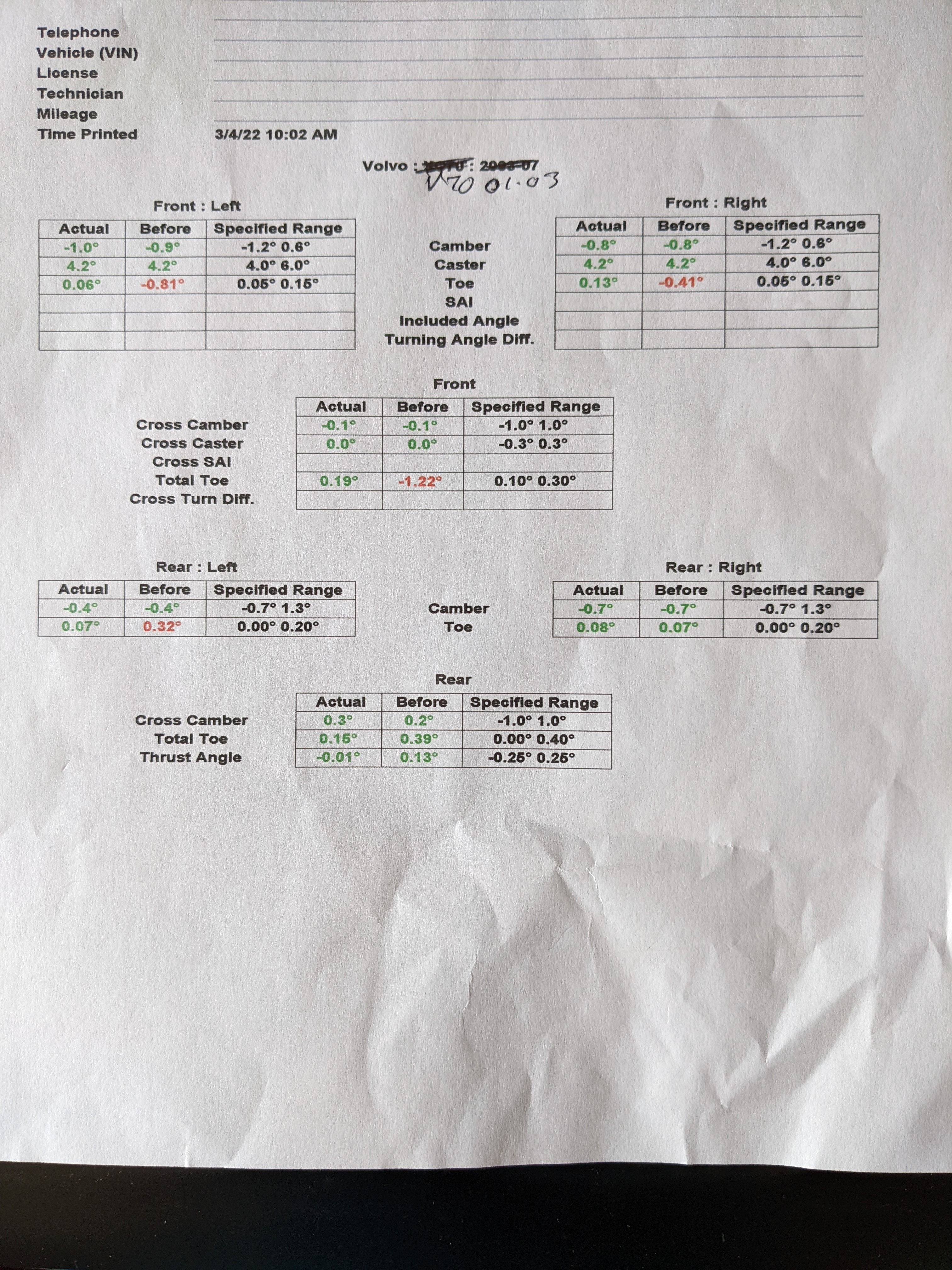

I'm very certain that it is a combination of too much negative camber -1°L / -.8°R up front and -.4°R / -.7°L as well as the 4.2° caster up front.
However you have me thinking, the tech did adjust the toe on the Rear left which was at .32°
Those front camber numbers are different than before I did the work obviously, and I had different front toe as I also replaced the inner tie rod ends due to miniscule play and I didn't want to pay for an alignment on loose parts.
I did my own alignment adjustment at home when I was finished just to make the car better since I needed it for a few days before the alignment appointment. When I checked rear toe it seemed like both sides had very equal toe in.
This makes me wonder exactly how the computerized alignment works. I took my reference off of the center of the front and back wheel to get a parallel line to the car. Where is the machine getting a reference from exactly? If I actually have the subframe crooked in the car the machine may just be set up to make the wheels track straight to each other and may not be able to tell the difference between a car that is parked crooked on the lift and a car with a crooked frame.
I have noticed that the steering feels different when turning left and right. I don't see it being possible to get the subframe too far left or right. I'm planning on taking careful measurements before I do anything so maybe that will reveal something.
I will also look at the rear more carefully, I did look at it and gave it a quick handshake before I took it in.
