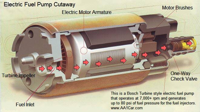

The check valve is integrated in the outlet nipple as shown in the example picture. I was able to confirm this by blowing into the nipple and couldn't blow air into it. When I sucked air through the nipple, it would flow.
What I'm thinking is that a fuel system that doesn't hold pressure (after eliminating the injectors, fuel line leaks, fpr, etc) doesn't necessarily mean a bad fuel pump check valve, Most likely it'll be the o-rings, and rubber parts in the sending unit.
