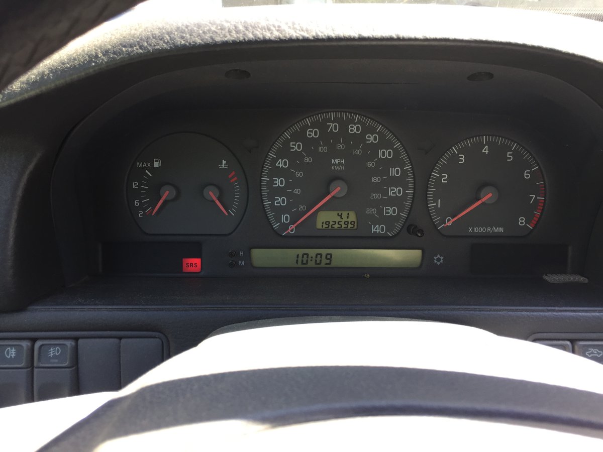

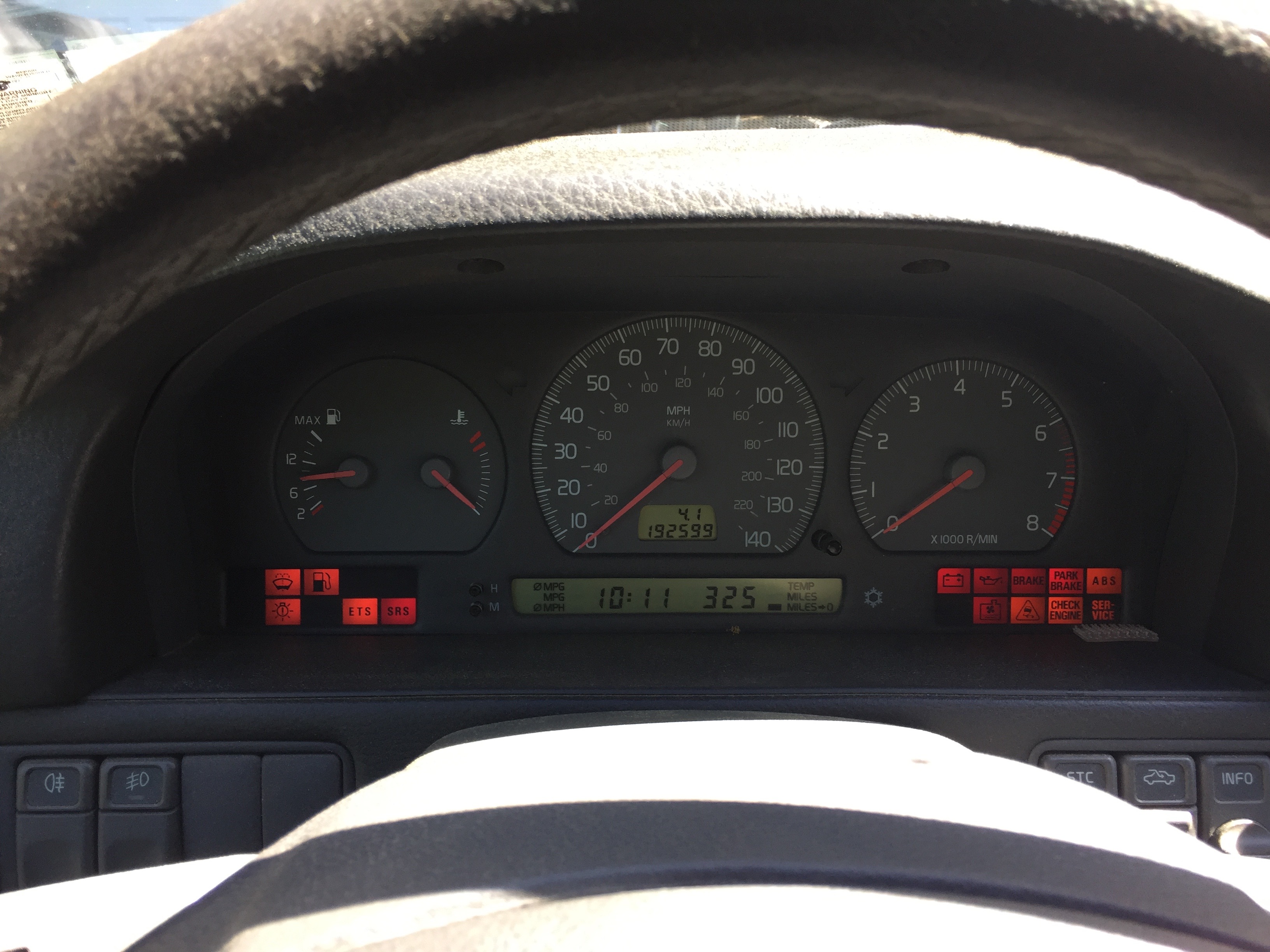

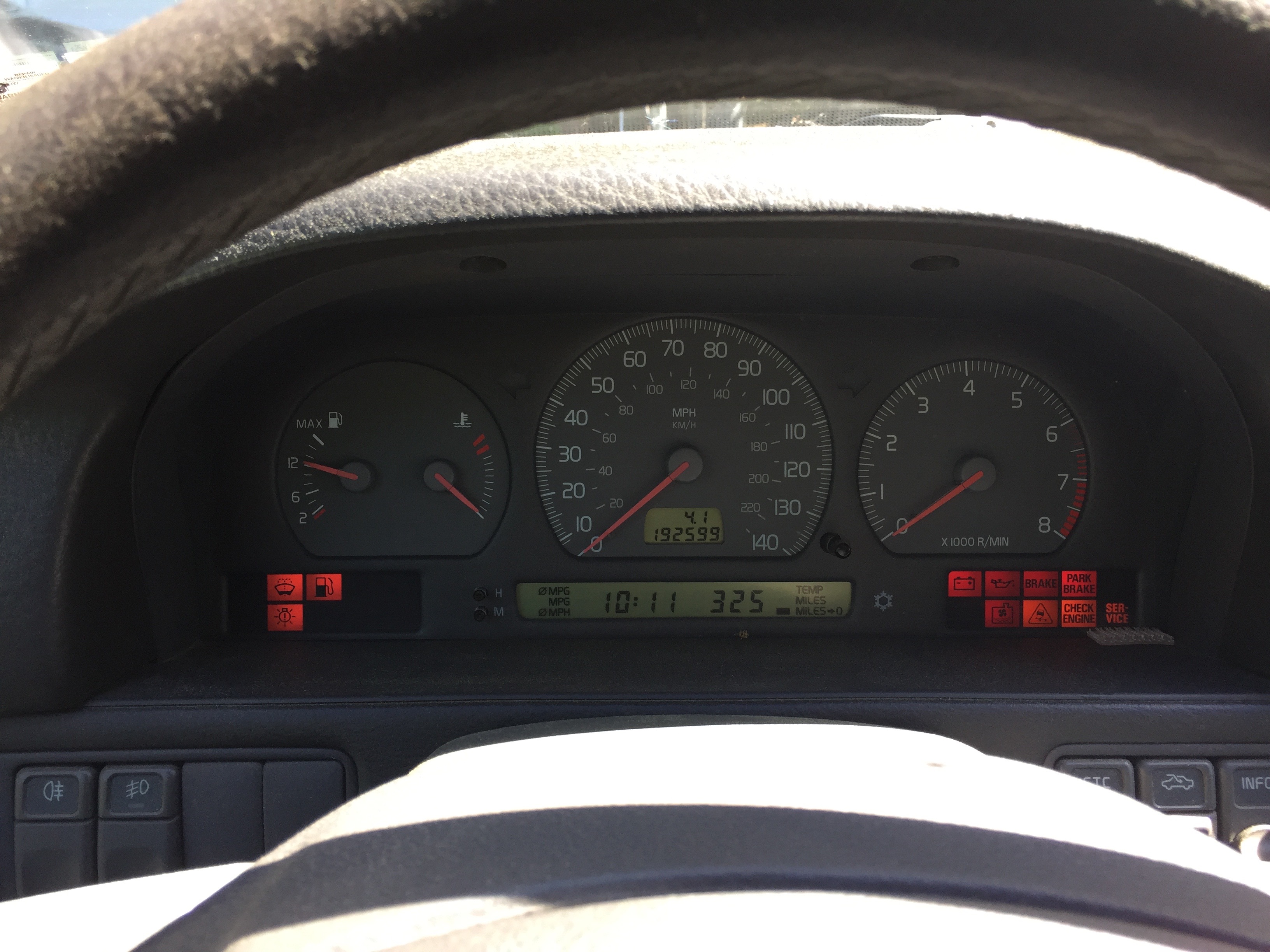

I was stuck in the car during a thunderstorm so I document the correct sequence of light-ups on keying on my 1999
Engine was not started during these tests.
POS 1 turns on SRS light for 5 seconds.
If you go direct to POS 2, all lights come on, then ABS burps after 2 seconds and goes out
5 seconds later SRS and ETS light go out.

I have to check, but I think the 98' is a little different, I am not sure about the ABS burp.
Also, on mine the "service light" doesn't come on

The cruise light on the 99 never comes on in the key sequence. There is no way to test bulb function short of pulling the bulb from the dash. Maybe you can in VIDA

I believe you can turn it on in VIDA. I know the ABS light will blink while VIDA is accessing the ABS controller as well. We should check tomorrow

Interesting . If you start the car normally, the ETS and ABS go out on engine start, the SRS 5 seconds later. That ABS has me a bit puzzled.
