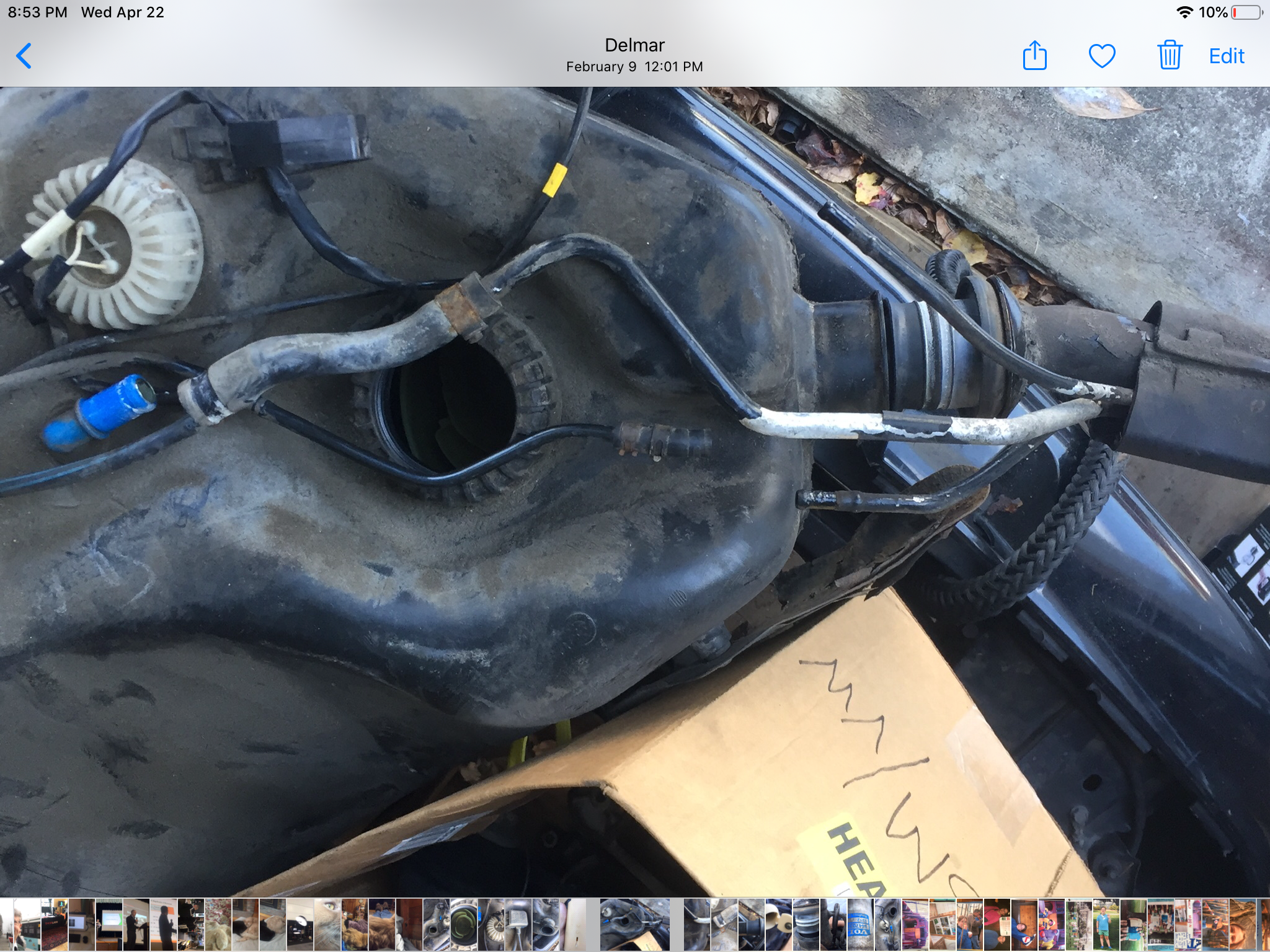

Pictures to be added, from the 1998 parts car, Clarke
I jacked the car up on left side and got about 1 foot clearance under rear, wheels on
I had previously drained tank to about 1 liter of fuel left.
Removed 5 M6 screws and removed Al plate over pump
Disconnect all electrical connectors going through plate and feed through
Levered off two slide fittings, then pop off two fuel lines.
(Note - if you are sensitive to fuel smell, do this last.)
Open fuel hatch - dig out the large (150mm radius) snap ring in the rubber grommet and free the grommet from the fill neck
Position jack under tank (not needed if empty)
Remove two M8 (14mm hex_ bolts from rear of each strap, tank drops
Release clip 'organizer holding fuel and vapor lines
Remove clamp of vapor line heading forward and remove line (pliers work here, VW style clamp)
Pull tank and fill pipe back as unit.
Elapsed time 30 minutes not including draining. I drained by applying 12 Volts to the pump (red/black wires) T2 connector and running front fuel line into a gas can

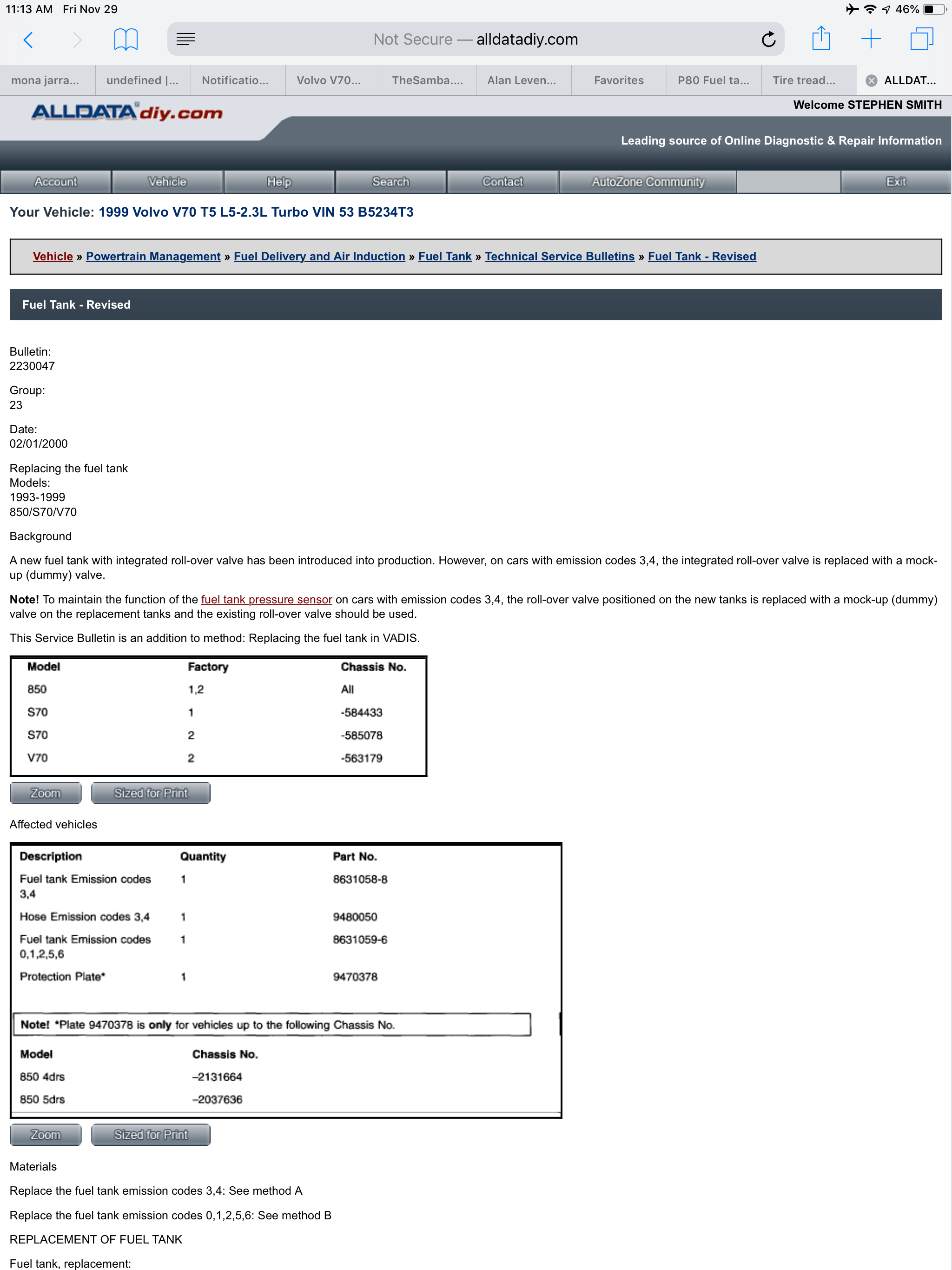

I’m not sure new fuel tanks are available but replacement fuel tanks have a issue with a new style rollover, or June Valve, that need to be understood
Bulletin attached
Bulletin attached
