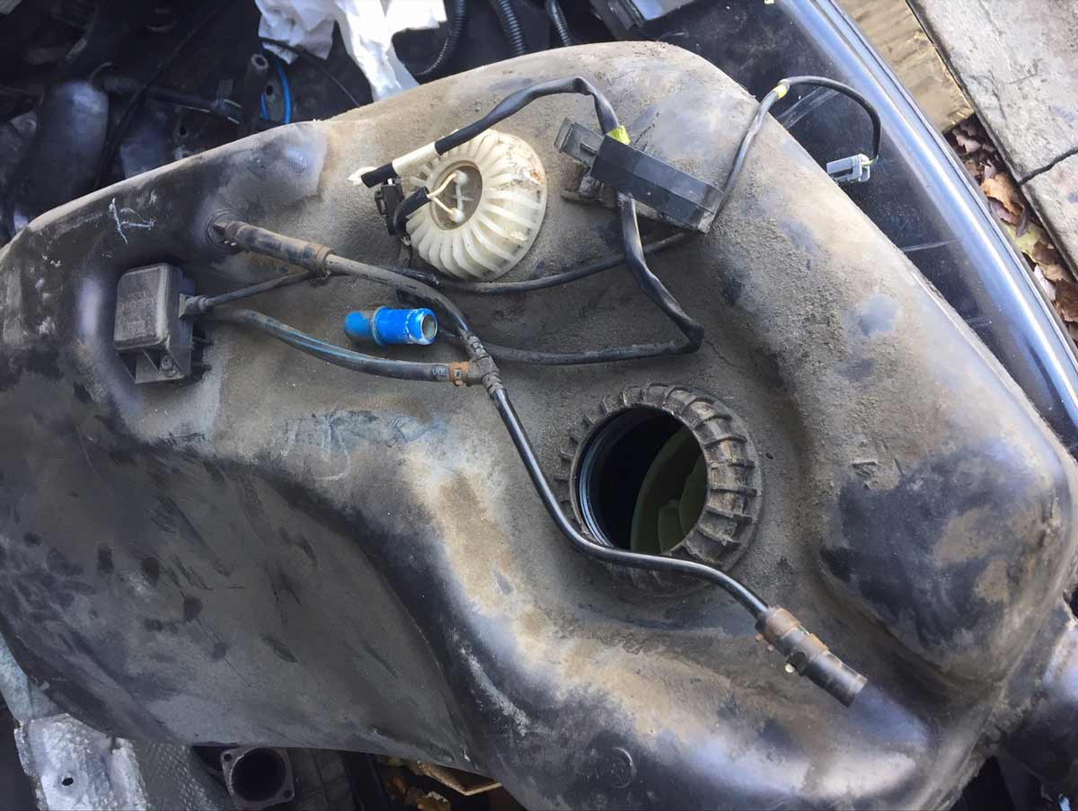

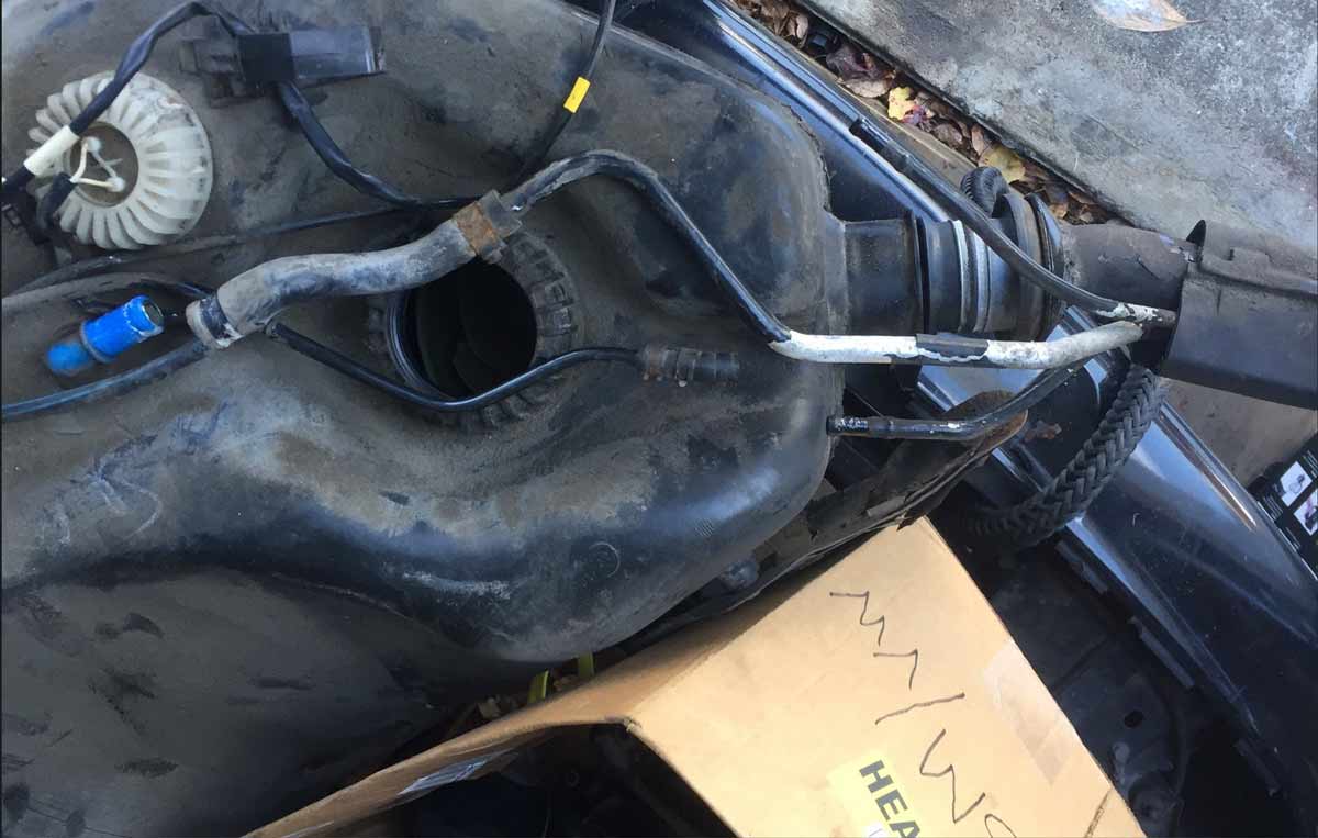

How to drop fuel tank - it's out and disconnected

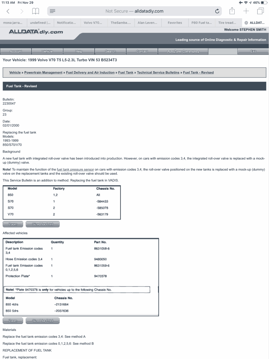

Keep in mind the availability of new fuel tanks:
