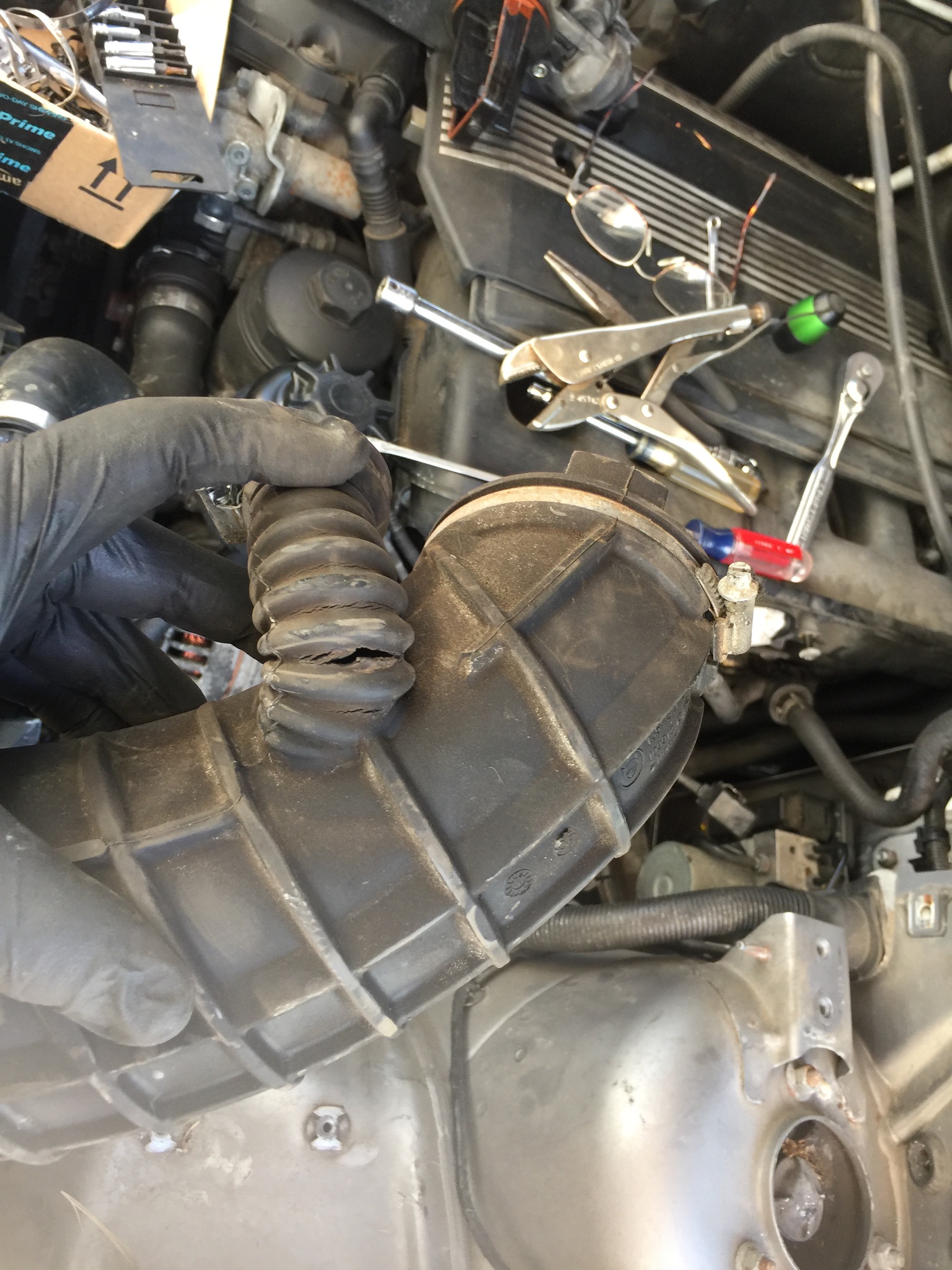

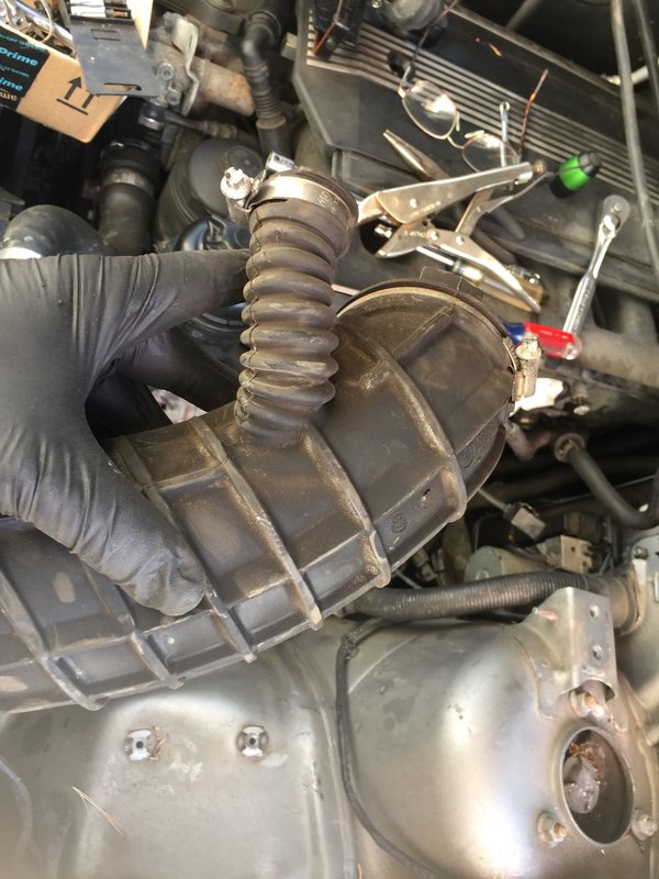

When we encounter poor running or starting, a common cause is corruption in the vacuum hoses in these cars.
Commonly, these throw codes for oxygen sensor, MAF, misfire, or fuel trim out of range.
You can't just look at your hoses to rule them out, I've found again and again that you need all your senses to make sure you don't have leaks.
I had $1300 of work proposed by BMW to cure P0171 and P0174. It was clear no one was diagnosing, they were just Mossberg Mechanicing....shotgunning a ton of expensive parts.
I knocked off the induction in about one hour..it's a pain on this car
Here's is the intake bellows in installed position
Slight pressure on the idle valve bypass

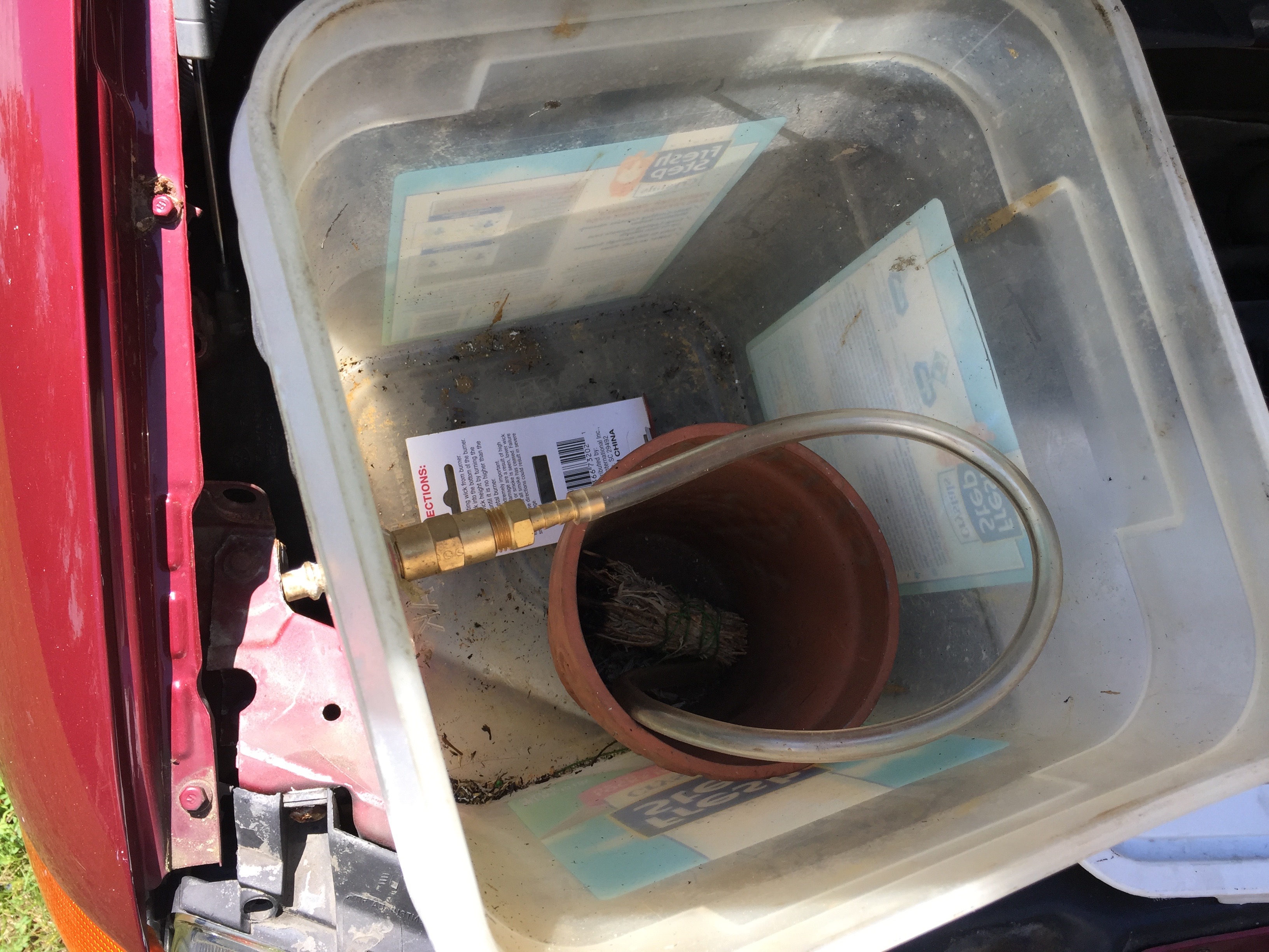

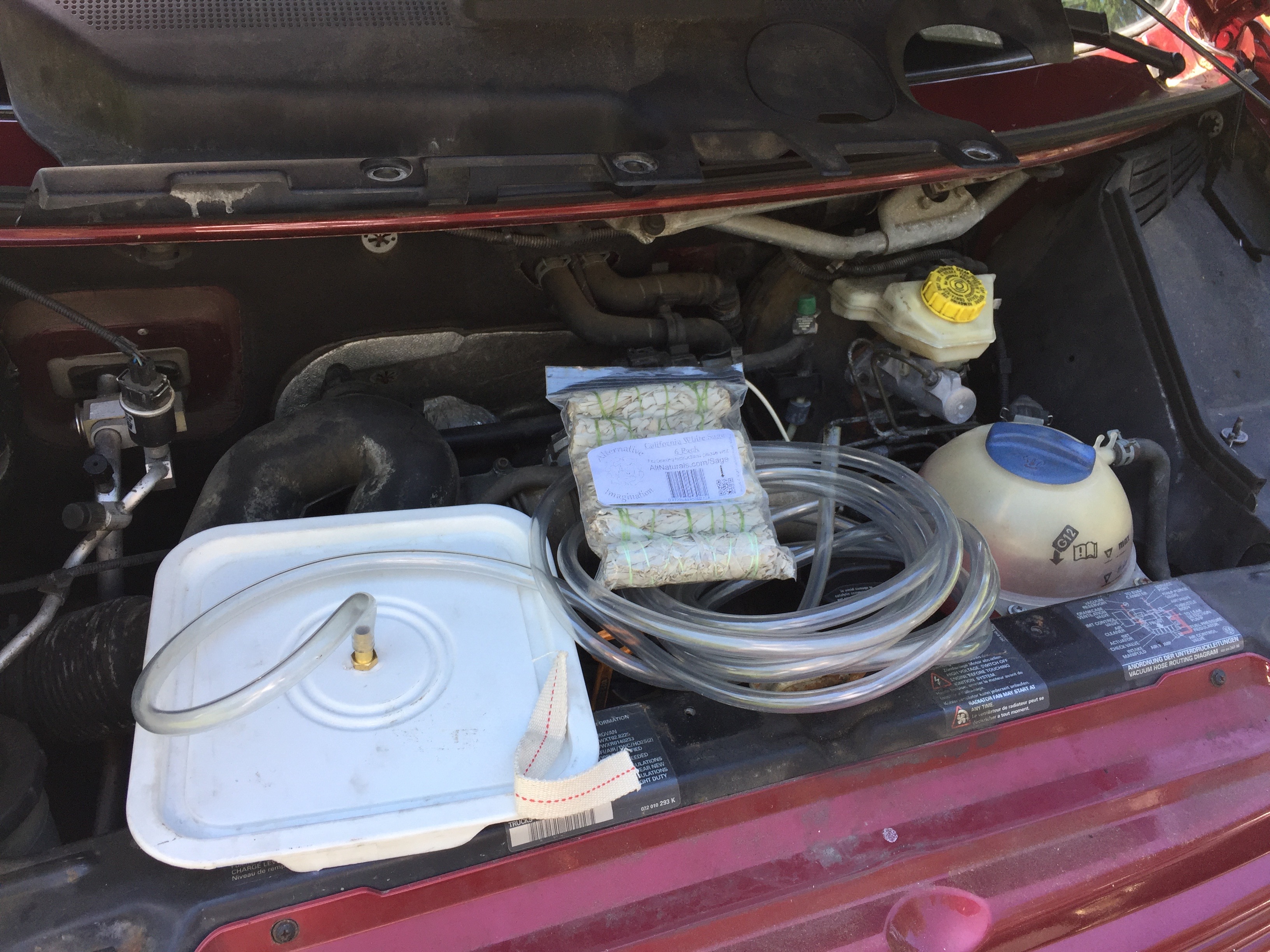

Here are picture details of my smoke tester
Cat litter bucket
CA sage smudge sticks
Clay
pot
Tygon (tm) tubing aka PVC tubing
Brass air fittings
Air compressor - not shown. you just need bit of air flow, you can probably blow to make this work. The side PVC hose blows right onto the smudge to make it glow, then it will puff off thick smoke.

Is it hard to smoke test the system? Like where do you hook up the smoke injection hose?

You can tape the Tygon tube nicely to the brake booster, on the suction side of the check valve

Big fat hose heading to the brake booster

I am assuming that smoke does not harm the system?
Does anyone use soapy water for this kind of test?

Most people will keep smoke out of the MAF by pulling off the big snorkel hose and putting a baggie over it. Thats probably smart. Any leak before the MAF doesn't matter , of course.
