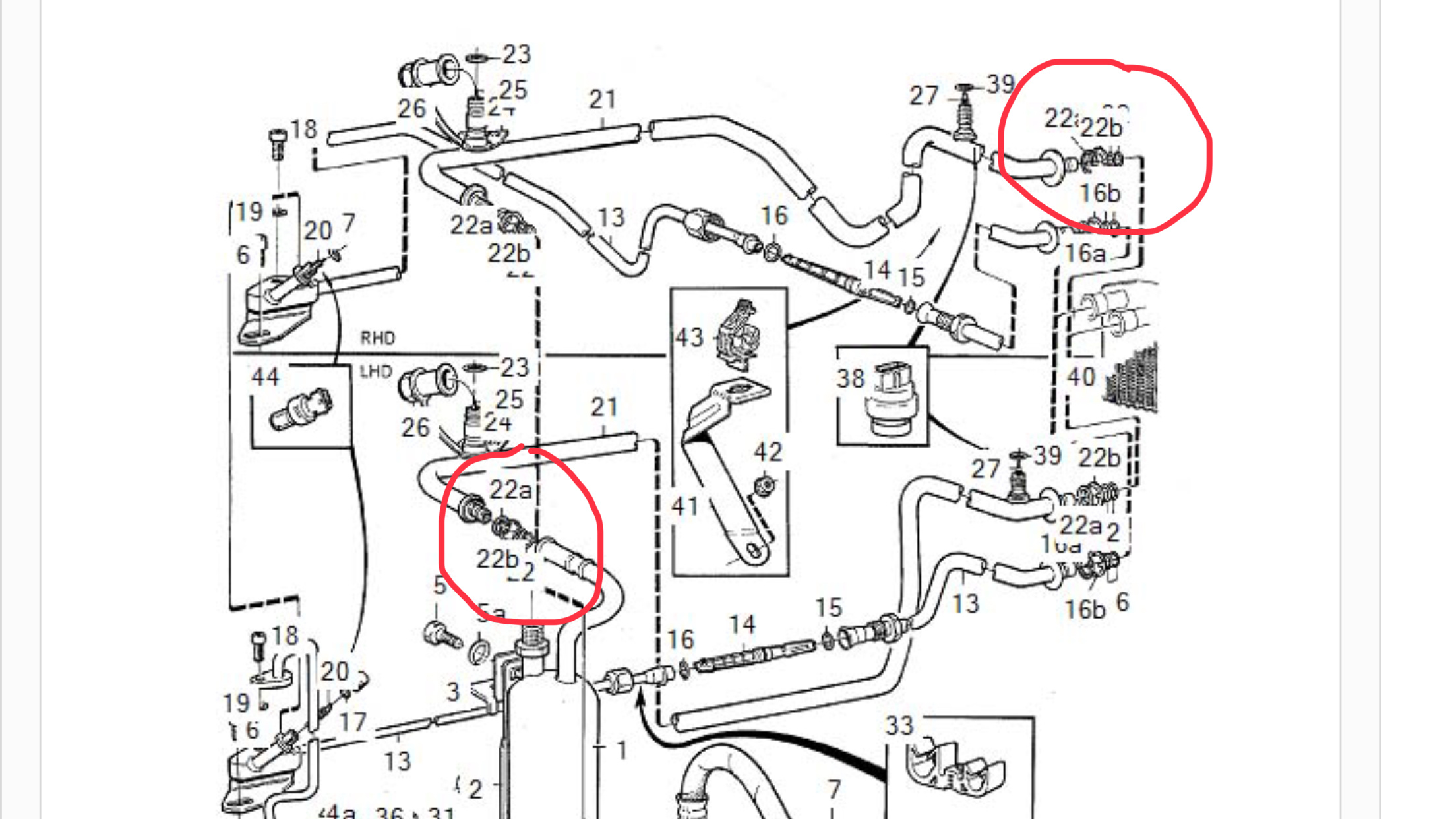

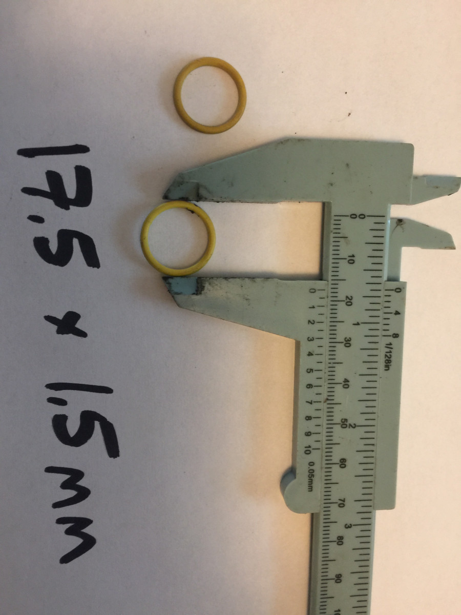

Part 3545416
Dimensions 17mm x 1.5 mm nominal
Used in pairs on the warm side of evap as well as the return side of drier

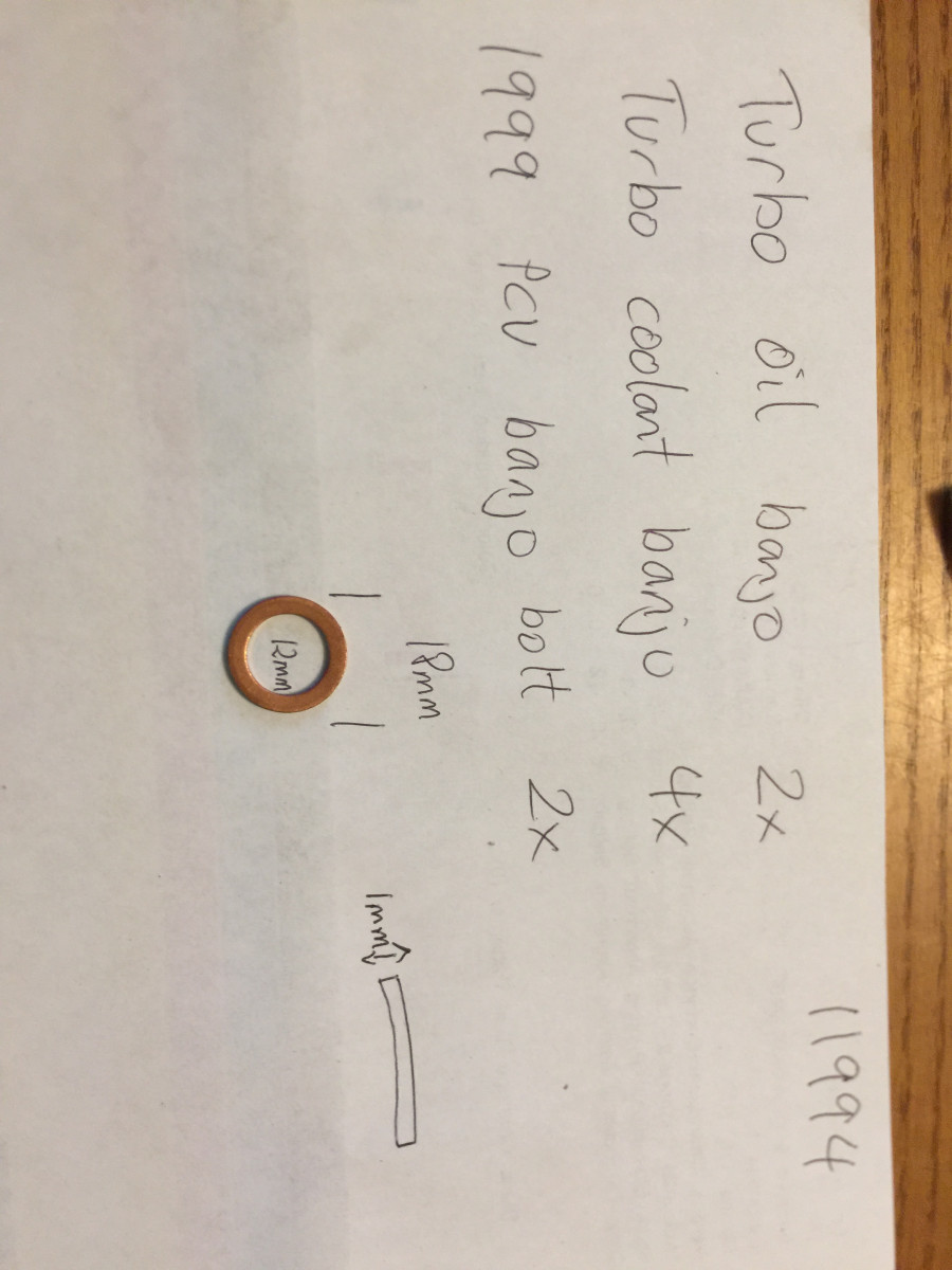

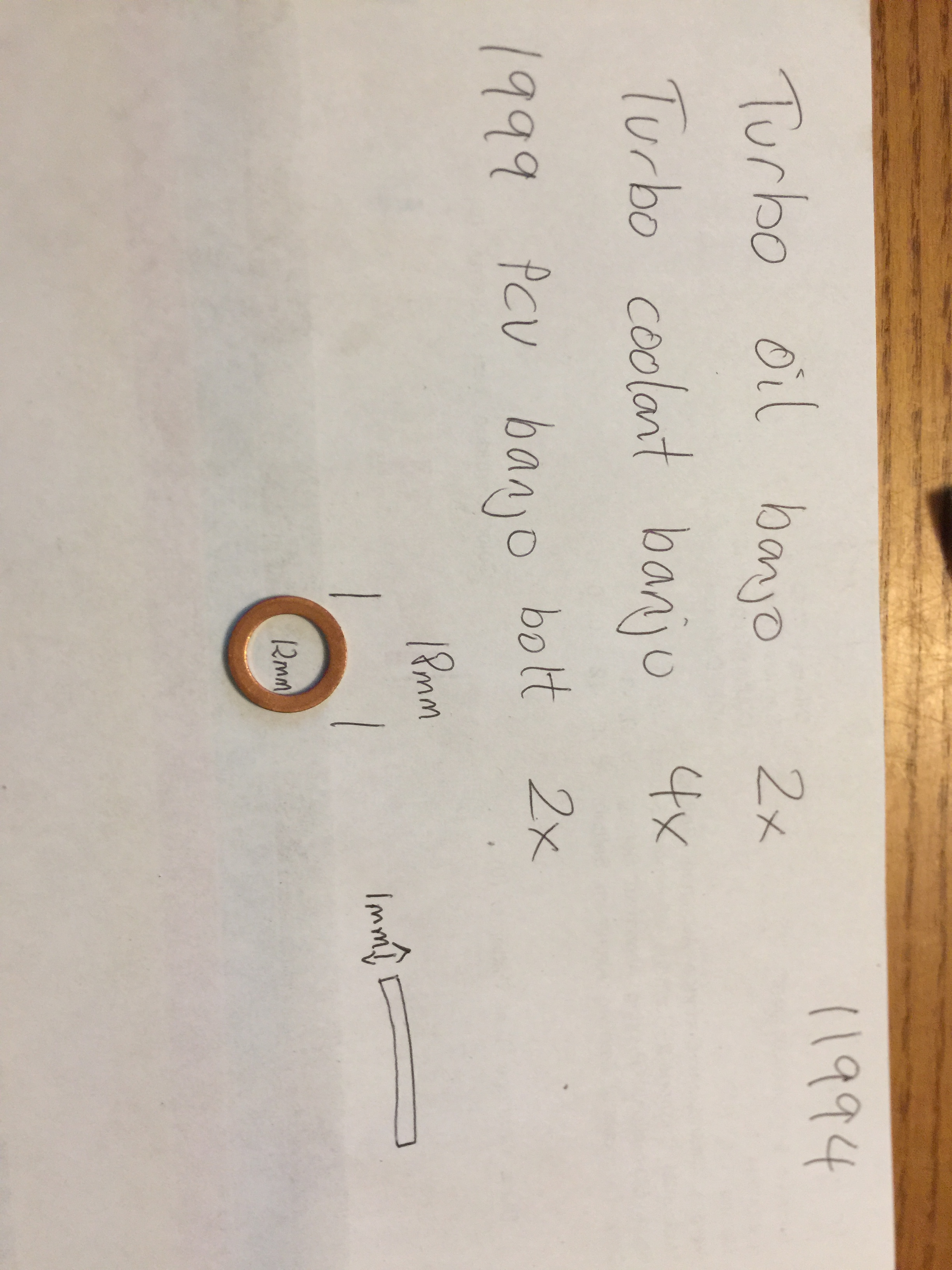

Turbo and 1999 PCV banjo bolt copper gaskets
Part 11194 - this is also a P2 ECT gasket so if you need one look for a P2 nearby.
Size 18mmx12mm by 1mm thick
Fitment
P2 ECT gasket
P80 Turbo oil line supply (return uses a different drain system with a flat gasket) 2peices total
P80 Coolant turbo supply and return banjo, 4 pieces total
1999 PCV vacuum banjo bolt under IM - 2 pieces
1999 Coolant PCV pipe return to cylinder head at rear of engine, 2 pieces
(Supply uses hose with barbed connector

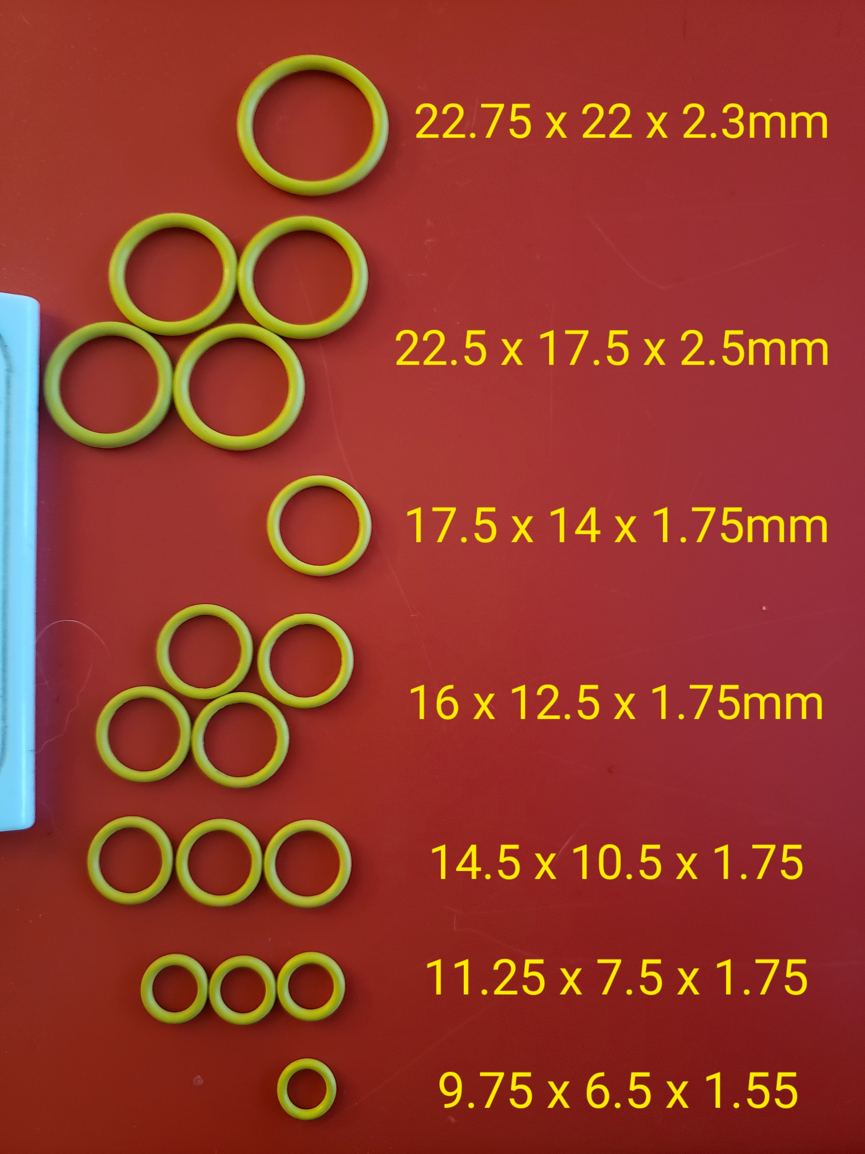

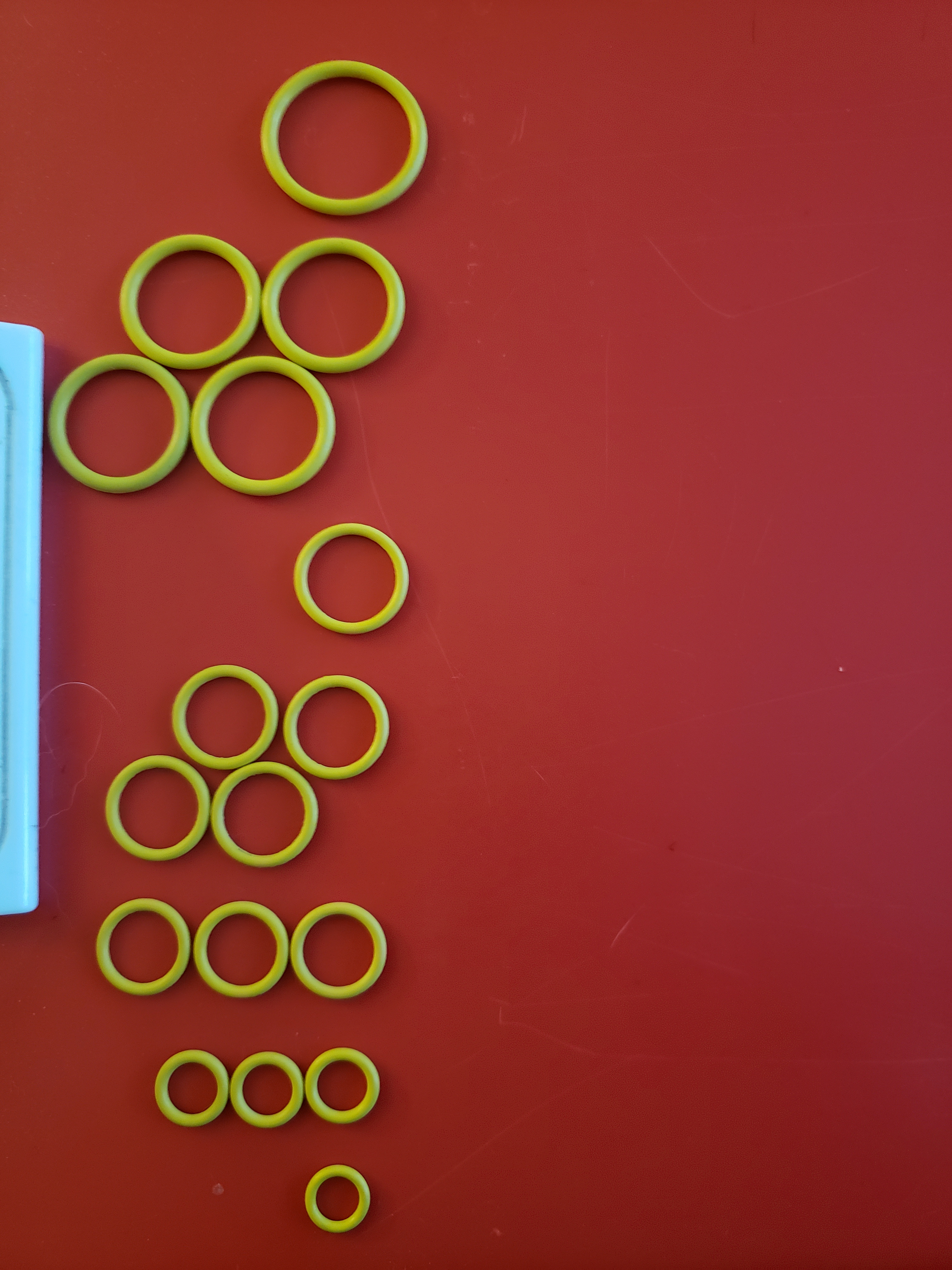

I ordered the santech o-ring seal kit RS2672 for my AC overhaul. Here are the measurements I got with my caliper. OD x ID x Thickness

Zion, do you mind if I screenshot that and cross reference it to part and function?
That will be the ultimate kickass reference tool for P80 AC
Cross reference of AC o rings from amazon attached

Go for it. Take my measurements with a grain of salt. Used a harbor freight digital caliper.
Here is the original picture

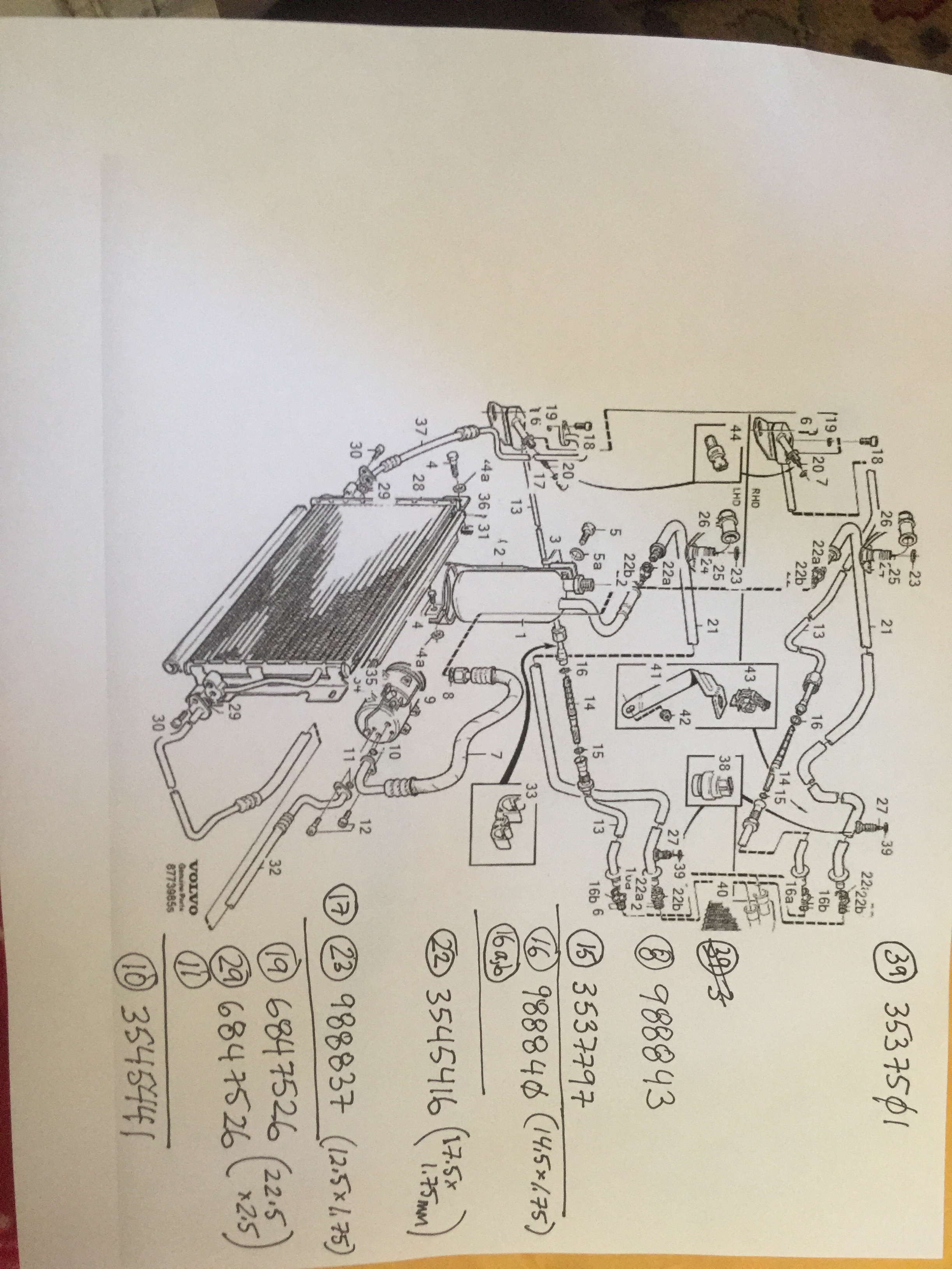

Ok, incomplete but work in progress
Posts: 35267
Has thanked: 1497 times
Been thanked: 3809 times

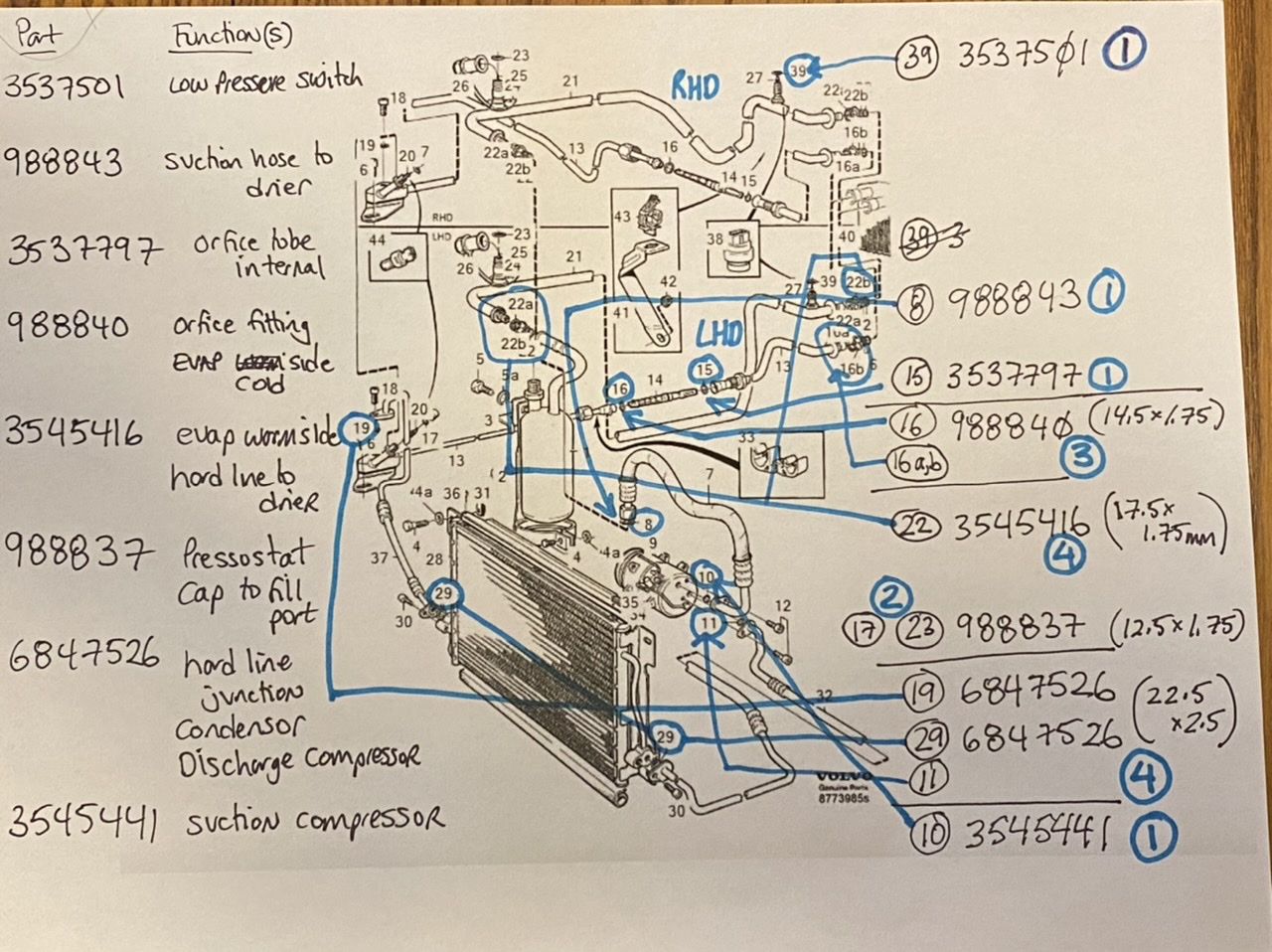

More progress.
Listed function on left.
Total number of each in blue circled by group
