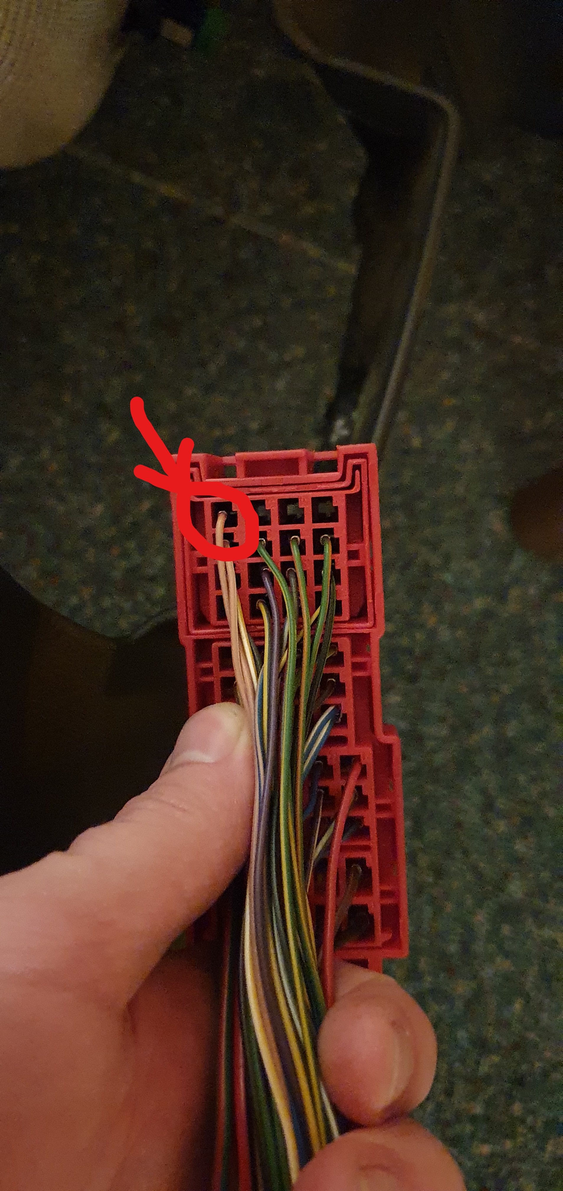

So I think I have found the solution if anyone will ever go trough this
You will need to check if you car is prewired for the adjustors, in the engine bay where the plug for the lights is you will have 3 plugs
1 headlight wipers
2 headlights
3 headlight adjustment.

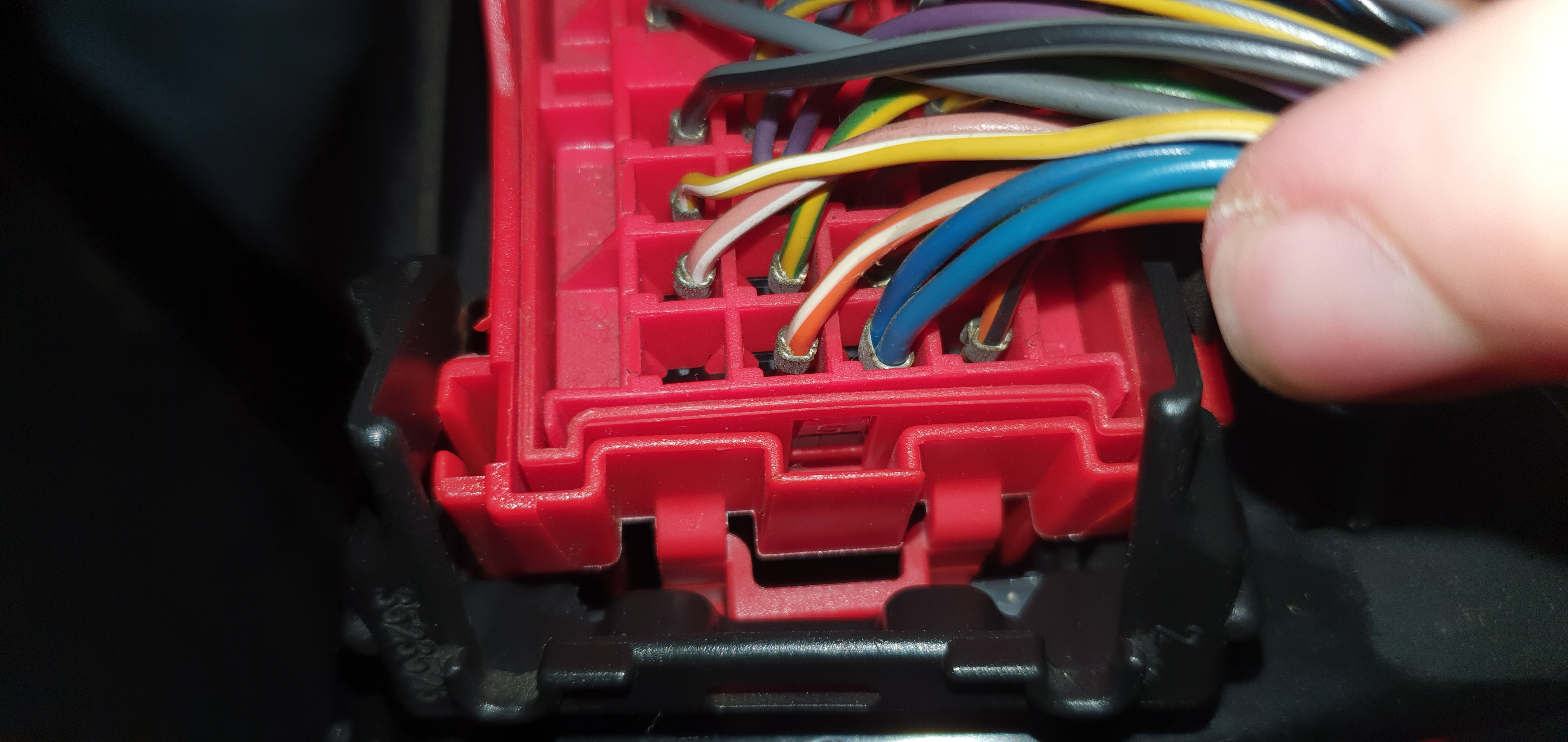

So you will need to connect the car wires to the dash wires shown in pictures.
the 3 wires bottom right pic 1 will need to be connected to the switch trough the dash wires in pic2
you could just take them out and directly wire to the switch if you want to do it easier
this is the car wiring

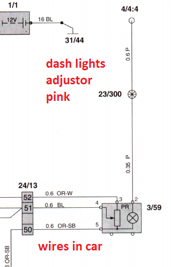

red circle around the pink dimmer wire
This is for the light dimmer like all other switches on the dash and cluster, you pull this one out from the dash wiring and insert it in the switch
then you wire in the other 3 wires as shown in the next pic
wires in car= the wires you will need to run from pic 2 in the 3 empty holes to the switch if you want to do it correctly
