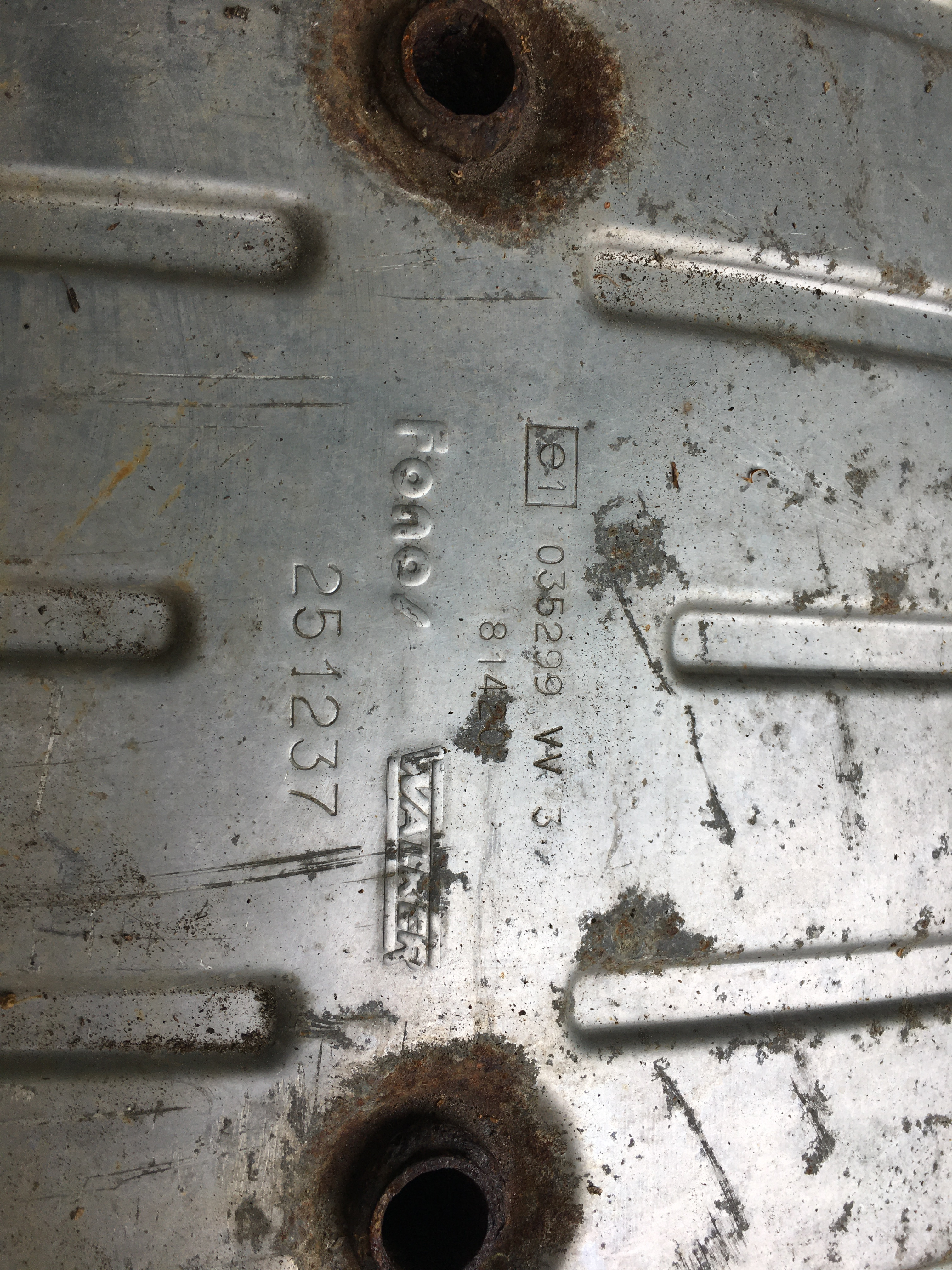

This was self inflicted. I bought the Starla muffler for the OE cat, and the Bosal cat has a skinnier pipe.
The walker muffler 251237 would have fit with just the single donut clamp
I had to kludge up to 2 1/2 inch extension, then back to 2 3/8 ( 60mm) to attach
