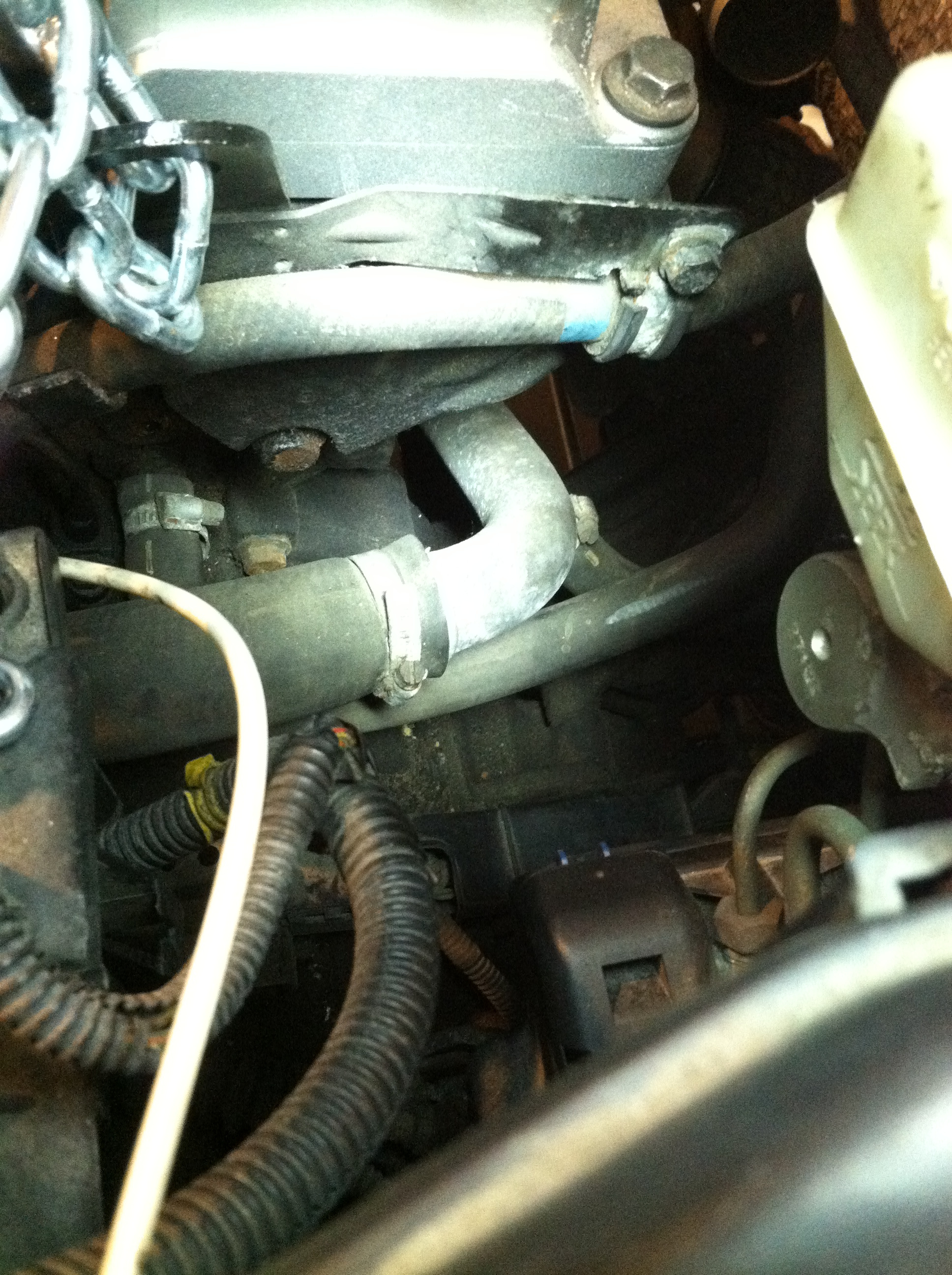

Nothing unusual about me being confused, but... My '99 NA, waiting patiently in the basement. It's the only reason I could get a pic. It did just hit 32F here, but I still ain't goin out there.

My 1998 Turbo S70 GLT has the water pipe angling forward
If your water pipe connection angles forward to front of car, you need part 9470409 or equivalent

Maybe it’s…..
Turbo cars always have the angled forward pipe?
NA cars have straight pipe -1998
NA 1999- on smiled forward pipe

I remember us being burned on this before. I will be darned if I know the breakdown however. Good to know that we should look at IPDs listings before shopping at FCP. Now if FCP could/would get their act in gear that would be nice.

Now I have both types of hoses in stock...
