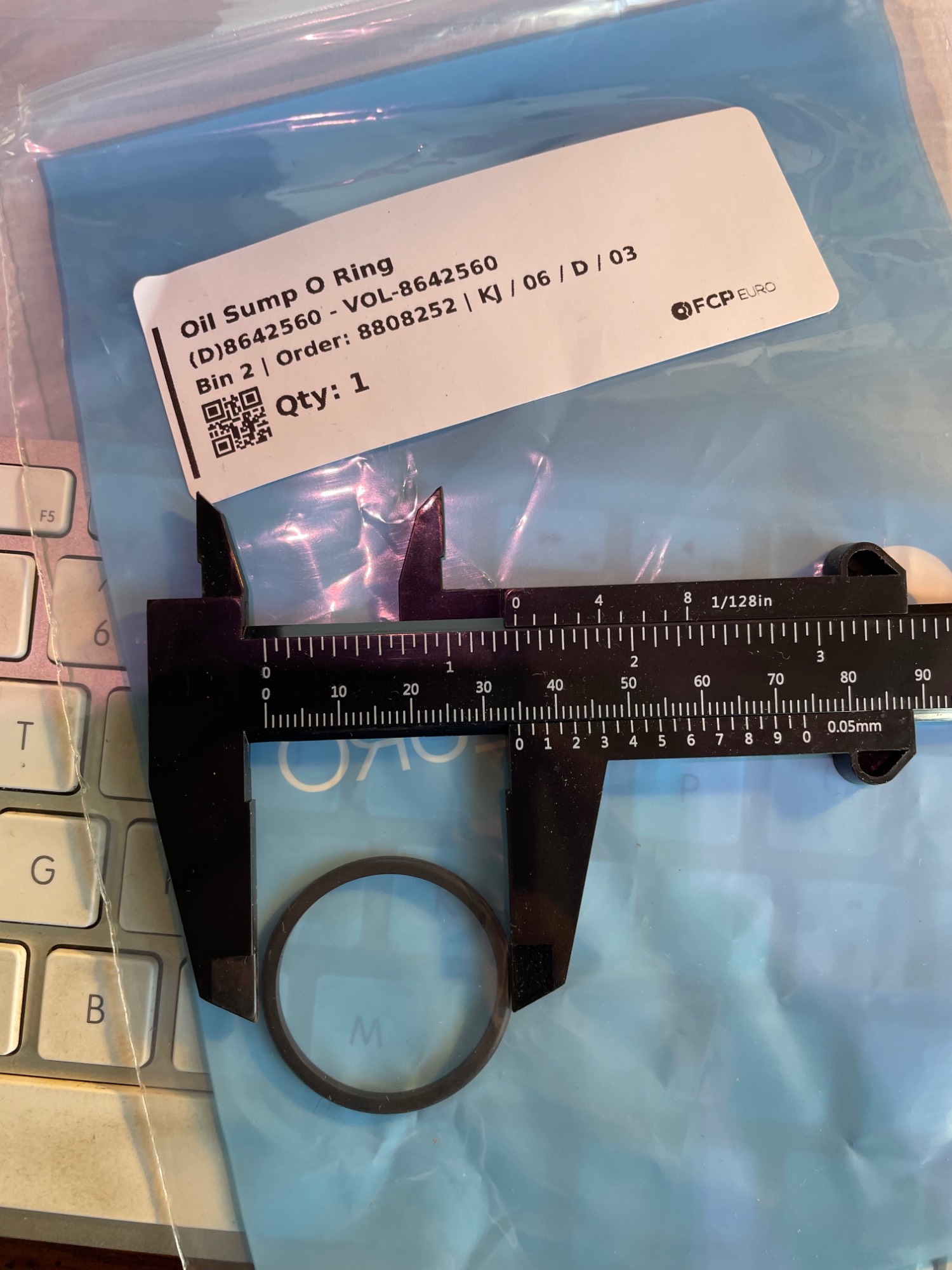

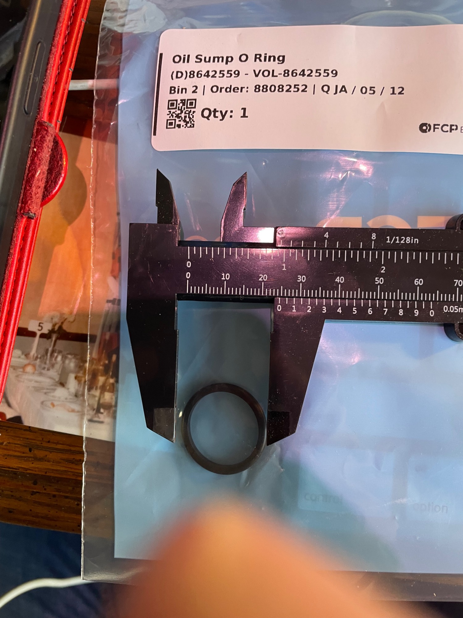

They look to me nominal 25mm and 38mm x2mm normal orings
