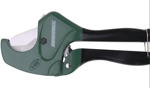

Hose cutter
Very handy for this project.
Home Depot sells one for less than $15.00.
Menards offers one for around $11.00.
This will be my next tool purchase.

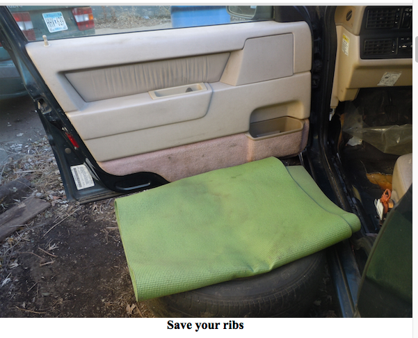

Save your ribs
You’ll be in there on your side. I’ve used a couple of wheels stacked flat. You can top the wheels with a cushion. Your ribs will thank you.
I pulled the footwell carpet (and scrubbed and hosed it down while I had it out). To do that, loosen the 2 seat mount bolts at the back and remove the front bolts (14 mm).
I found that after getting into position on your launch pad, planting a hand on the roof, I could swing my bod into the workspace, then reverse to swing back out.

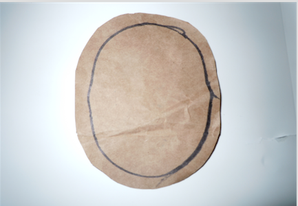

Since you won’t be using the plastic junction, you need a backing plate for the hoses to rest on and to hold the engine side face plate in place. If you remove the protruding tabs from junction, it will lay flat for tracing.
Template for your backing plate.
On your bench: trace the bulk part of the junction that nests into the firewall cavity (not the flange) that you removed onto a piece of thin cardboard, or heavy paper, as shown. Make your template a ¼” bigger all around than the junction tracing. Cut out your cardboard template, fit it into the cavity. Trim it if necessary, but make sure it’s wide enough to accept the screws from the engine side face plate. Now you have a template for your plywood cutout. Trace it around the outside of your template onto the plywood.
Note: When I traced it onto the plywood, cutting on the trace line, I could be confident that the plywood would be a perfect fit.
If you’re not comfortable cutting it that close, better to make it slightly smaller, then wedge a stick of something across the cavity to hold it in place while you trace the holes onto your plywood blank from the engine side.
Black trace line is the junction
Actual cavity width is 1/4” larger than the junction.

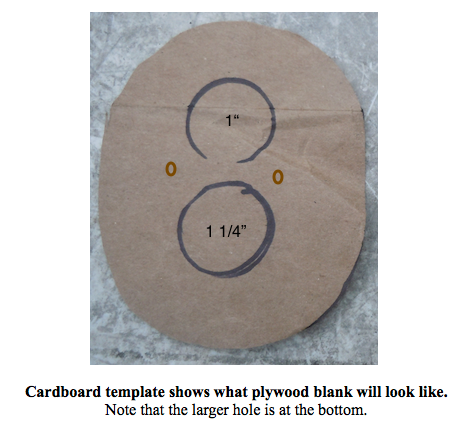

Cardboard template shows what plywood blank will look like.
Note that the larger hole is at the bottom.

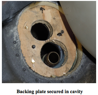

Bore holes for the hoses. Top hole is 1”; lower hole is 1 ¼”, it’s larger to allow for smooth curve of hose.
To install your backing plate, you’ll need starter holes for the self-threading screws.
Backing plate secured in cavity
Rope caulk initially tried, though sealant isn’t necessary around the edge.

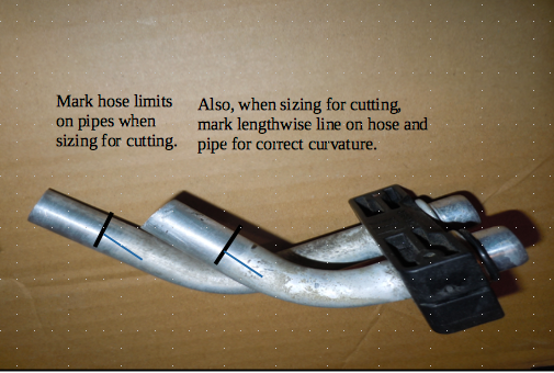

Shorten the pipes.
Make the pipes different lengths, so the clamps have their own space. In the first picture, above, you can see how they align.
In the picture below, note the shiny stubs where the hoses will connect. Use a fine grit emery cloth (or something like a Scotchbrite) to clean them up for a good seal with the Permatex 2.
Since you’ll need to remove the hoses from the pipes to smear on some Permatex 2, mark your pipes and hoses for how far they’ll go on the pipes and the right curvature.
For test fitting, install the hoses on the shortened pipes, but leave them slightly longer than they’ll need to be so you can be sure you have enough for connecting on the engine side.
Pipes set into heater core (not secured) for sizing hose lengths.
Pipes marked for hose limits and rotation of hoses on pipes so they can be assembled on the bench with sealant.
Connect the new hoses to the pipes so that their natural curvature comfortably arcs upward to curve through the firewall—so they won’t stress the pipe connections at the core. I set up everything without sealant or clamps to get the curvature right. Then marked the hoses at the firewall and pipes and hoses for curvature, as shown.
Cut the new hoses to length by firewall.
Assembly: Apply Permatex 2 sealant to hoses and pipes (see instructions) and secure them to the pipes with clamps, like in the picture below.

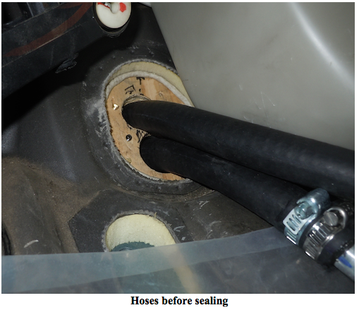

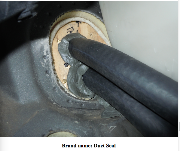

Sealing out fumes.

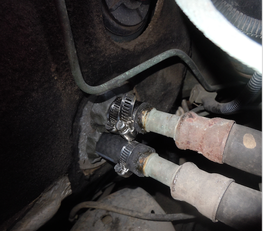

Hoses before sealing
Brand name: Duct Seal
I also applied Duct Seal around the face plate, as in this pic (it’s sort of like sticky chewing gum mixed with modeling clay). The face plate, itself, has an embossed rubber seal against the firewall. No engine fumes will get past that or the Duct Seal.
Not fancy, but they don’t leak. Definitely use the Permatex 2 sealant. The lower OEM hose nipple isn’t long enough for two clamps, but it seems fine. One caution re the clamps. I chose the narrow ones for sealing because they seem to conform to the contours of the hose better than the beefier clamp. Where the pipe or nipple was long enough, I used a heavier clamp for holding strength, but the second one probably isn’t necessary. No leaks, anyway.
After the clamps were tightened and allowed to set up for a day, I checked them for tightness the next day. The screws did turn slightly with moderate force.

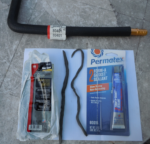

Everything is the same getting through the firewall, except that your new lower hose from its aluminum pipe will be longer to connect with an “L” hose, shown below.
The 80401 preformed hose is from Advance Auto; NAPA clerk told me they have a similar one.
For reference, consider this hose has the long “leg” and a short “foot” to connect to the engine nipple.

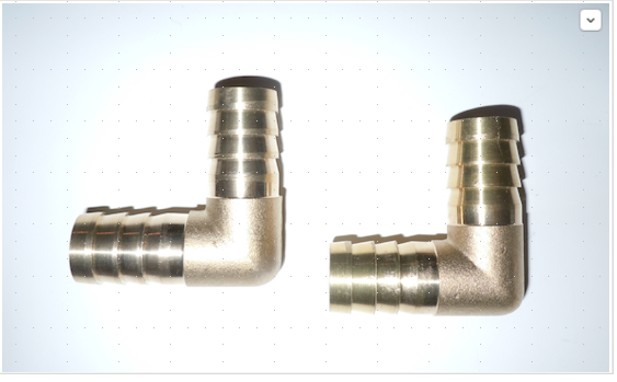

Same as #3, except for use of 90 degree 5/8” hose barbs
If you can find these handy right 90 barbs, you’d also go with the long hoses all the way from the aluminum pipes through the firewall and about 14 inches (for the lower hose) into the engine bay. Then use a right 90 hose barb, as shown, with a short length of hose to connect with the engine nipple. The upper hose will extend about 8 inches into the engine bay. Measure them to be sure. As with the others, be sure to use Permatex 2 sealant—and, again, I’ll recommend the narrow band clamps.
I couldn’t find these right angle barbs locally but Amazon has them, which is where I bought them (about $10.00 for the pair + shipping).

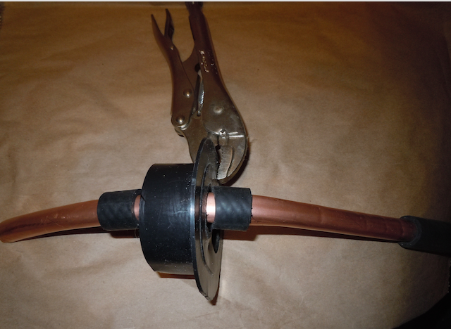

If you’d like to spend less time and effort on this project and reuse the OEM junction box, read on.
Those right 90 barbs (or the copper 90 degree elbows with stubs) will still be handy; depending on how you configure it, you might need 4 feet of new heater hose—less, if you use the preformed 80401, as shown.
You’ll still have to cut back your aluminum pipes, as pictured above. I’m emphasizing the shorter pipes to minimize stress on the heater core (manifold) where the pipes connect.
This mod avoids all the fussy work involved with eliminating the junction and making a backing plate. Though you’ll still need to remove the junction to take out the plastic locking sleeves and saw off the tabs for a flush fit of sealant—a hacksaw will do the job. Just hold the junction in your vise by its flange.

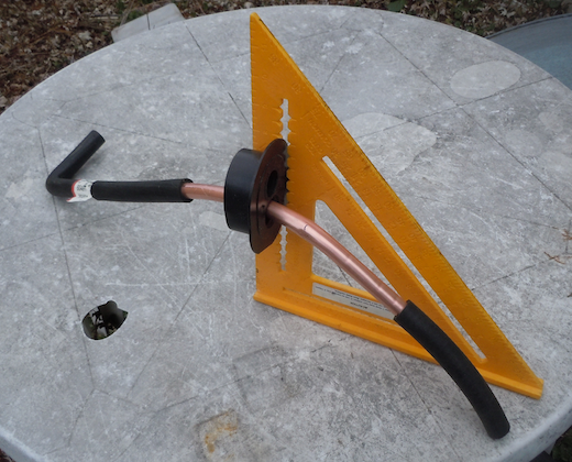

For this mod, ½” soft copper tubing will go through the firewall. NOTE: it’s not that soft. I devised a simple jig to bend it (picture below).
This mock up (for the lower, longer hose) is basically what your configuration will look like (if you use the 80401). The lower right end will link with the shortened aluminum pipe. I’d prefer a straight link of hose (and it wouldn’t need to be that long) on that end to minimize stress on the aluminum pipe connection to the core. The curvature of the tubing works well at the other end where it goes through the firewall.
If you look closely, you’ll see that I straightened the right end of the copper tubing.
In the next picture, you can see the bushings revealed that make it easier to seal the openings on either side of the junction.
After installation, they’ll be pushed into the junction to take up most of the space in the original holes. Then, the duct sealant around the pipes at the face plate will complete the seal.
If you do this mod, when you purchase the hose, ask the clerk to cut off 4 1-inch pieces to use as bushings.
While I had the junction out, I used a hack saw to trim off the protruding tabs on either side. The flange, where it tucks behind the HVAC duct can also be trimmed back.

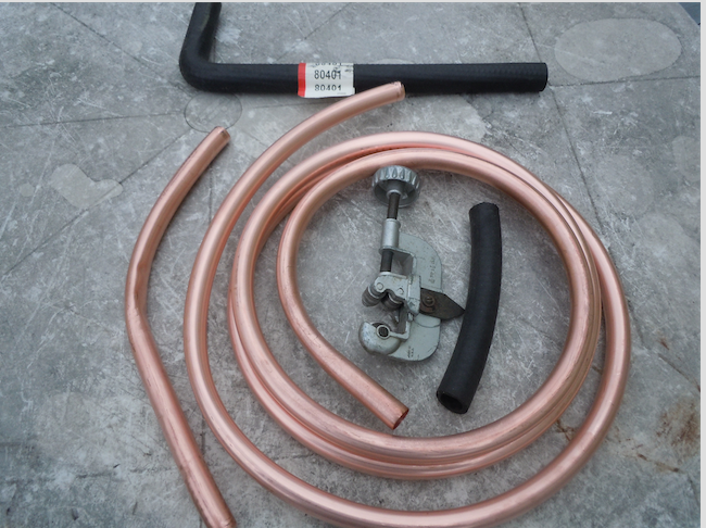

The coil of soft copper tubing costs less than $20.00 at Menards; about $25 at Home Depot.
You’ll need a tubing cutter. There’s a very small version for cutting in tight places.
You have to tighten the cutter wheel slowly to avoid collapsing the tubing or getting it out of round.
For my first attempt to bend a length of the tubing, I slipped it into a 3/4” pipe. You can get needed leverage that way, but the hard edge of the pipe will flatten and dent the copper. Better to use a jig like in the previous picture.

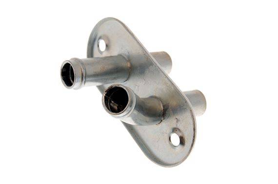

This is similar to a Triumph TR-6 firewall bulkhead. #611043. I don't know the specs on this part so it may not work.
- 611043.jpg (10.41 KiB) Viewed 2592 times

Matt asked how I decided to do the mod.
I'd thought about it quite a bit while the 850 was parked last summer. One of the o-ring connections at the firewall had leaked and I considered the whole junction setup too complex and possibly prone to eventually leaking again.
So, what was the alternative? Just get through the firewall with new hose and hook it up like I did.
But two problems that others have mentioned are a standard hose could kink if you try to force it to turn (the 60 degrees) through the OEM junction, and also stressing upward the pipe connection at the heater core manifold.
The screw that I call the "yoke" screw that pulls the pipes and o-rings into their seats is pretty robust and while I haven't tested the limit of the yoke that it screws into for its strip point, it too seems like it can take some forceful tightening.
But, if the pipes are securely held in the base (manifold) of the heater core and there's upward stress from hoses being forced to sharply bend through the junction, that might eventually crack the base of the heater core.
The two main mods to avoid this problem both relax the hose, allowing it to easily route through the firewall, but only if it is given some length to form a relaxed arc—which meant cutting back the aluminum pipes. That was kind of a "yikes" reality, but to gain the stress relief of the pipes-to-heater core connection, I had to do it. No regrets on that once done.
Removing the junction seemed necessary to avoid the sharp turn the hose would need to make if was forced through the junction. That led to the big question: what am I going to use for a backing plate that's needed to hold the face plate on the engine side in place?
I considered different materials, then time was running short and I had some scrap plywood. Hmmm. This IS a hack, so there are no constraints on creativity and expedience if it works and only you will know what it looks like.
I had the tools and the plywood scrap, except for the hose cutter which I just bought yesterday, and will use for sure on the next one—my 93 850 also needs the hack.
As you can see in the post, there was some fussy work involved in making up the backing plate. The pipes were an easy mod since I have a cutoff wheel (Harbor Freight). I just wanted to leave a long enough stub to get a good hose connection. See the picture. The rest is explained.
There's always a better—and maybe more economical—way to invent something, so after I put this together and everything seemed good, I started thinking about how to replace the engine side OEM hoses. The clerk at Advance Auto rummaged to find me the 80401 "L" preformed hose. A walk around Home Depot got me thinking about the right 90 copper fitting (which I had on hand). That brought up the question of whether there was a right 90 hose barb (which I found on Amazon).
The bigger question was, how can I get through the OEM junction (with sleeves removed) without kinking the hose. I had vaguely been aware of 1/2 inch bendable copper tubing. When I discovered that its O.D. is 5/8 inch, so it would connect easily with heater hose, that seemed like it might be the easiest and best way to go. I'm sure I'll do my 93 850 that way.
So the short answer to Matt's question is: my assumption that the plastic junction had to go drove my search for what to replace it with. And time running out, I had to get creative. There are plenty of materials in my garage waiting for creative uses. (There's even an M56 transmission and a manual shifter with cables which I'm pretty sure I'll never use.)
It was only after the hack as pictured was done that the search for better ways to do it got under way.
