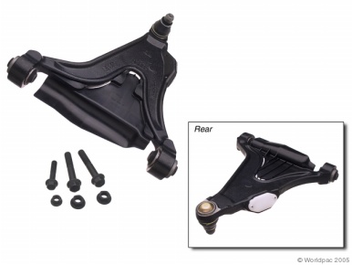

Ozark,
I'm trying to envision what you mean. Here is the control arm photo from FCP website. I can't see where the bump stop is or how it works. Can you add a little to your comment? When the car was sitting today, I was turning the wheel from lock to lock, and the sudden "pop" occurred when it was near but not at lock on the right side. However, I don't see how it would hit the bump stop if it isn't moving up and down. I'll take a look tomorrow at the actual control arm on the car. It's below zero here but is supposed to warm into the 20s tomorrow.

Mine was more of a creaking noise from the right side. When I took the spring seat off it had collapsed and was rubbing on the strut mount. It had actually cut a groove into the spring seat from rubbing.
I would try Ozarks suggestion of greasing the stops first. If that does not solve it get an oil can with a long spout and shoot some oil on top of the spring seat. When I did this on mine the creaking stopped so I ordered the "Genuine Volvo" XC90 seats from Volvo of Richardson in Dallas. Creaking gone.

Holler1,
On the second picture note the white plastic piece on the side of the control arm. Smear a gob of grease on that part and see if the problem goes away.
...Lee
