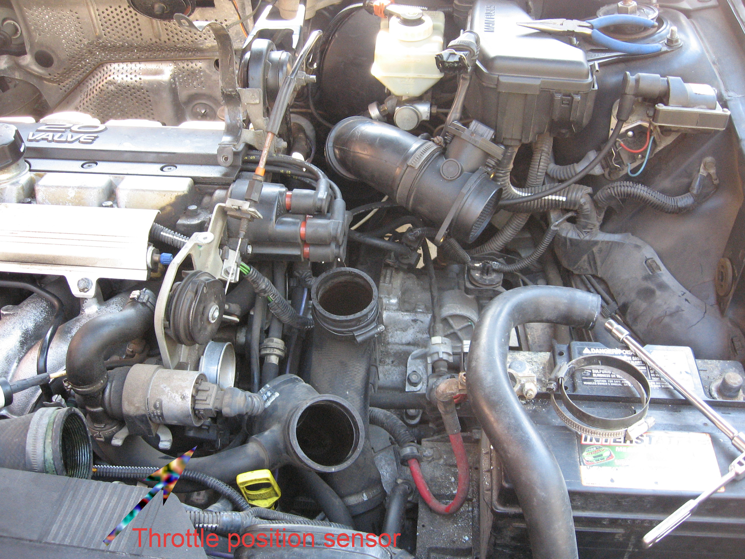

Thanks for the response. Where is the throttle position sensor? Can you please provide either a picture or description. I love Volvo's and this car, but if it was a horse I'd be tempted to shoot it.(kidding)

It's attached to the throttle body, at the front of the car. Remove the black cover over the idle control valve to gain access to it. It's held in by 2 screws, but I can't remember what kind.
(You can click on this picture to get a better view - sorry, it's the best one I have where you can see it).
