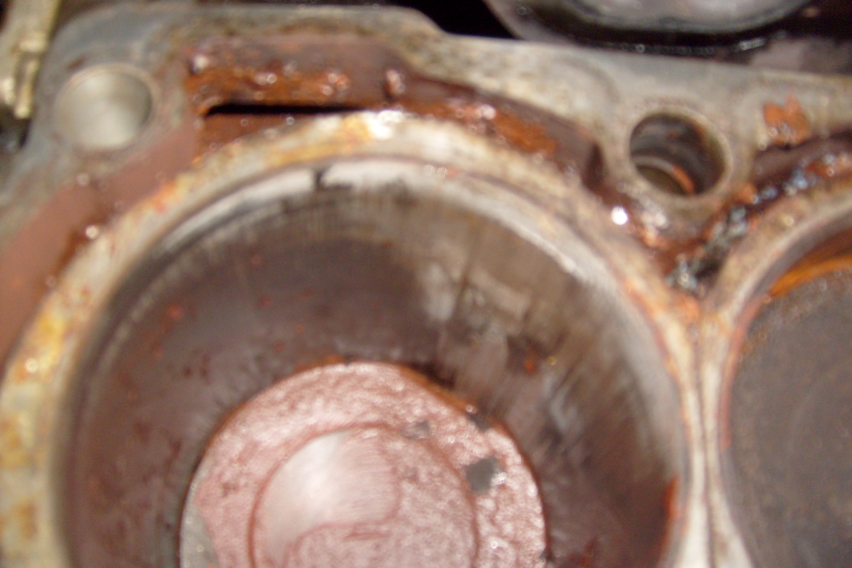

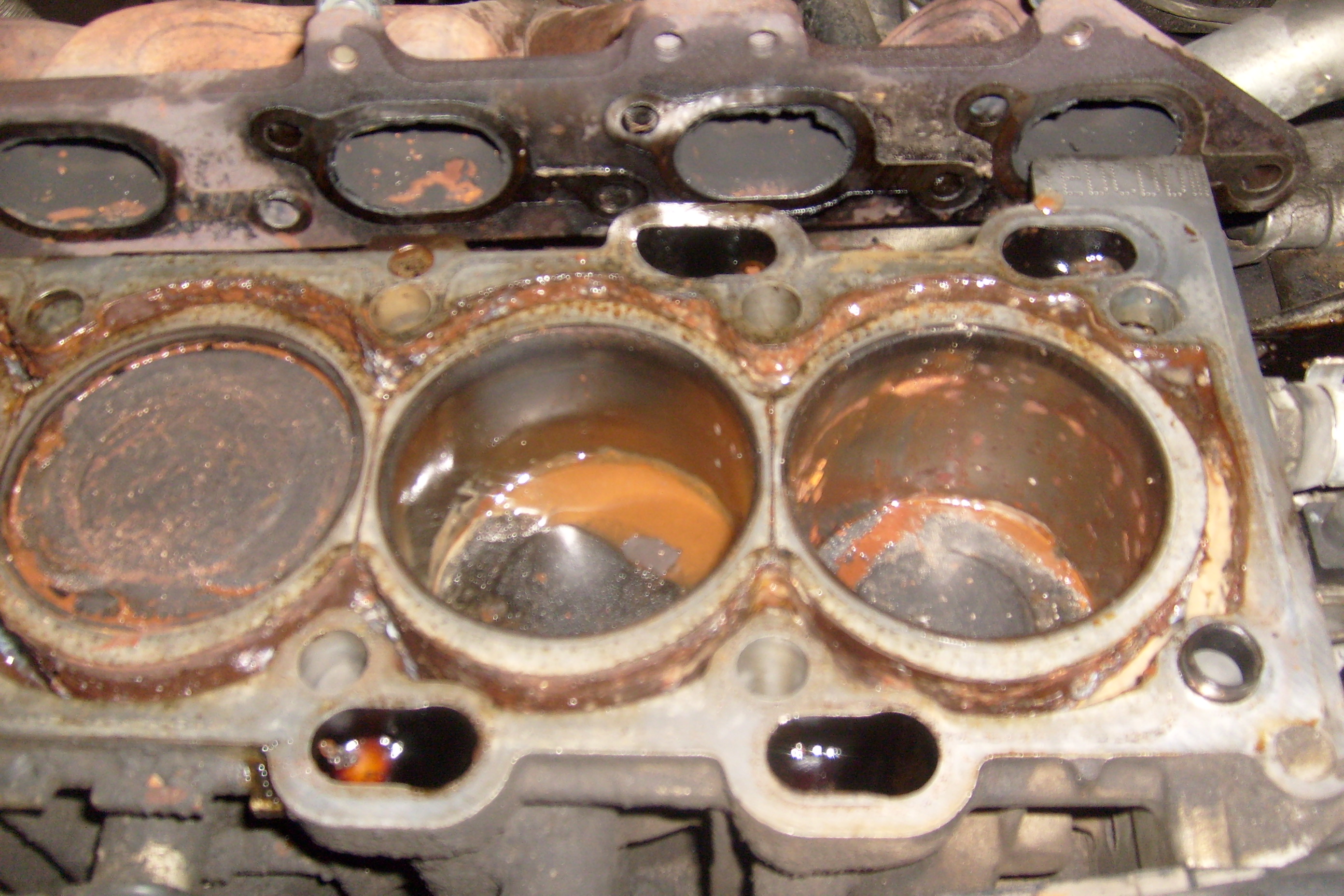

So this is the result after four hours of stripping this afternoon. A big chunk of aluminium missing out of the cylinder 1 piston; you can see it at about 2 o' clock.
Yeah, I shouldn't have bothered, but the head and valves look good, no missing bits and the original head gasket and valves with the same factory markings.
I poured water into the engine about three weeks ago and it was coming out and dropping on the road. The cylinders were actually filling with the water and there's corrosion/rust everywhere. Once the block is pulled I'm going to start investigating the possibility of putting a B5252S 10 valve block (with the 20 valve pistons/conrods) as I have one on a stand in the workshop. If the casting and bolt holes are in the same position it will work but there will be some work to rebuilding it as I've yet to compare the crank journals for the conrods. Same capacity and same bore & stroke b/w B5254 & B5252 so it's just a big meccano set waiting to be assembled.
I'm going very low budget on this car as so far it owes me around $800. It requires new PCV, heater core and firewall coupling (half of the coupling came out with one of the heater hoses!!) Also front spring seats are toast. I'll keep posting the progress as it occurs.
