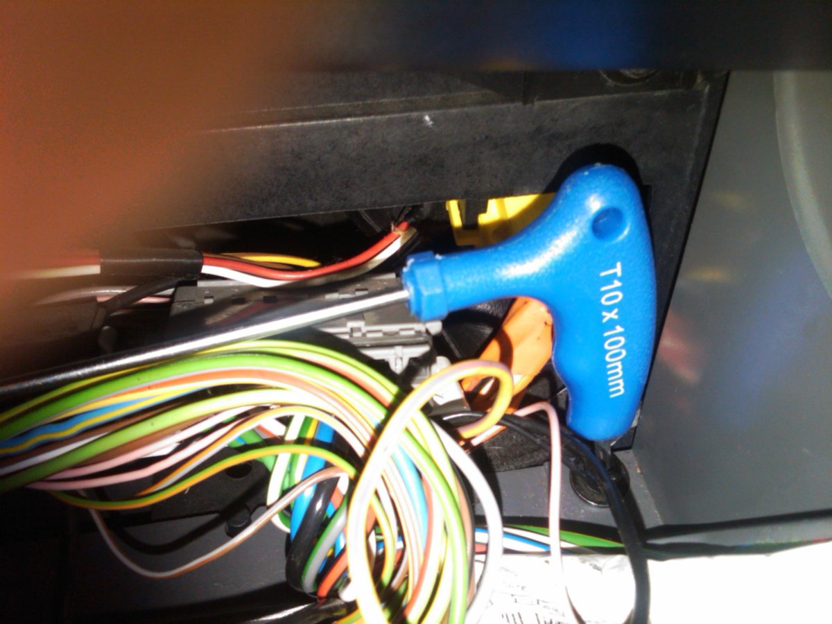

inside, the 2 bolts by the handbrake adjusting nut and in front of the cigarette lighter are removed first. unplug the lighter and move the OBD data connector out of the console. Way down in are 2 T10 bolts to remove and I had to use small allen wrench to get the one on the left out:

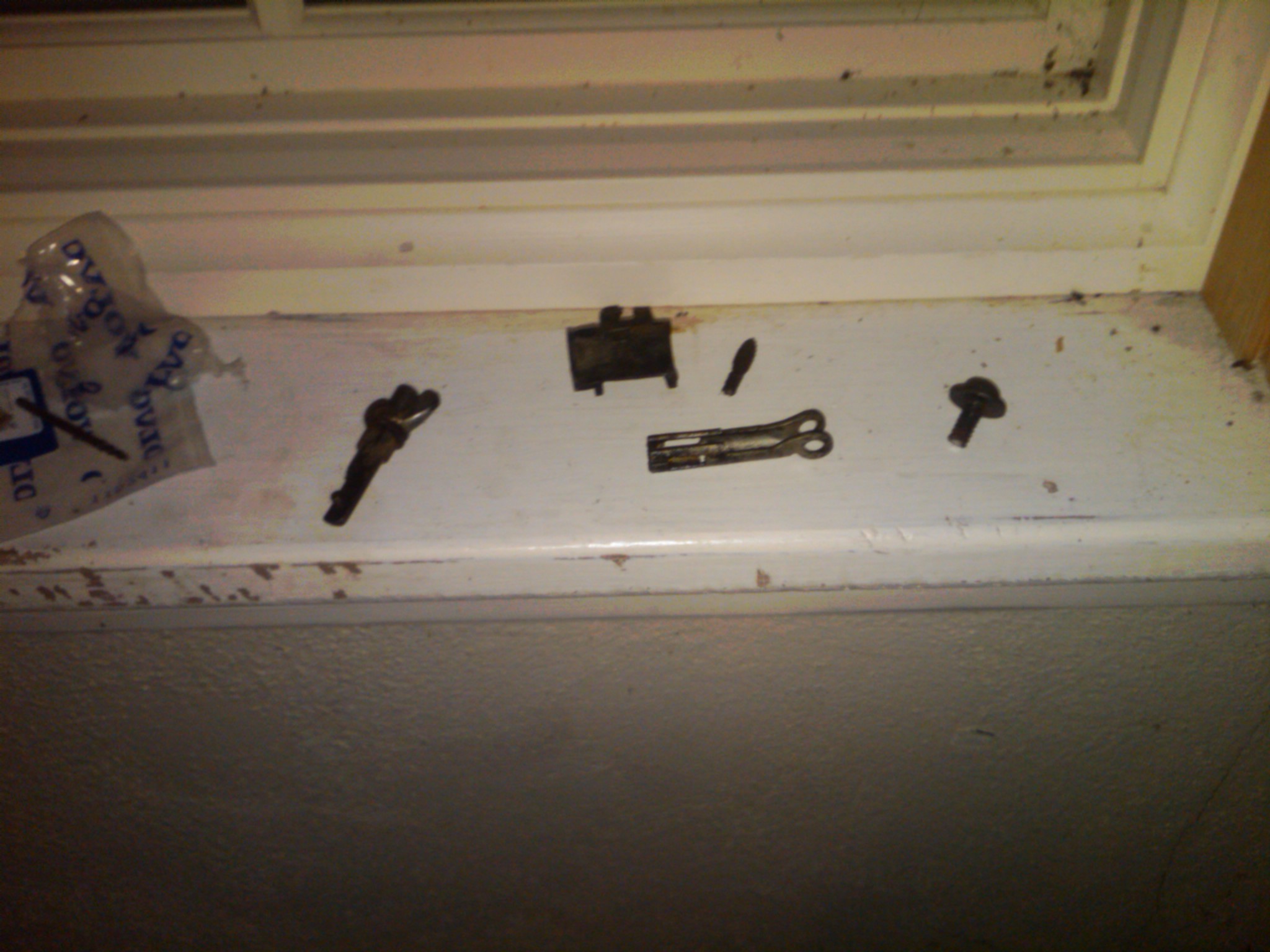

Outside again, the cable clip mounting bolt was hard to remove on the right with no access, so I used an industrial hacksaw blade. The little bit of screw left in the thick body metal piece was hard to get out, but I finally got it to screw on through and out the back. The bolt on the left side snapped right off 1/4in. down from the head, so I destroyed the old plastic piece here (after seeing a new mount comes on the new cable) and got the rest of the screw out with visegrips. Here's picture of the screw I sawed out and part of the broken old plastic mount:

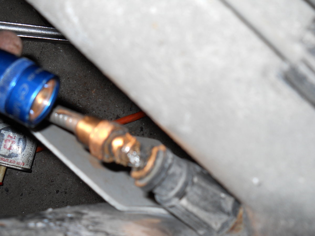

I wiggled the end piece a lot and then stripped some of the cable cover off to expose the small inside cable to be able to pull out the expander and take end piece out, see picture above and below. I decided to replace the expander(part #9475812) and mounting screws(986126), washers and rivets.
