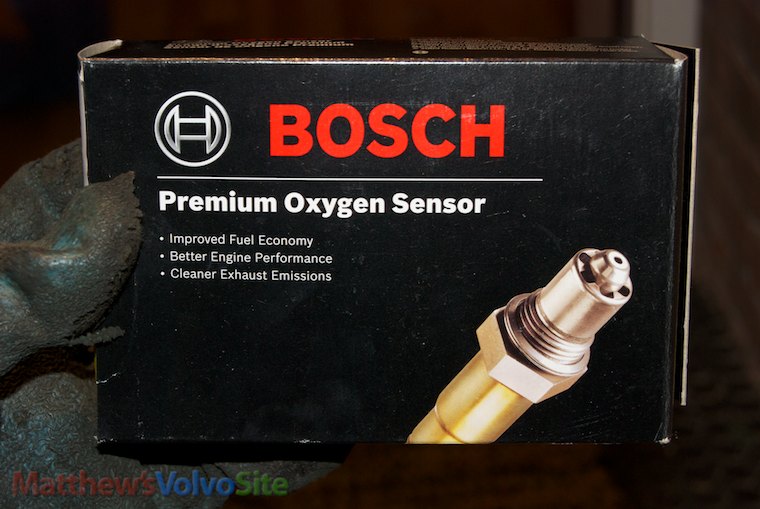

So I got the Bosch sensor for my '97 850 T5 (T=turbo) from one of my sponsors, Bosch part #15062. It was around $90. I didn't want to fiddle with the Bosch universal sensor, although some here have used that with success and thus saved money.
A sticker on the box says "Oxy Sensor R 850T CSV70 NA98". Take that to mean what you will. In other words, this Bosch part might fit many/most of the gen 1 FWD Volvos.

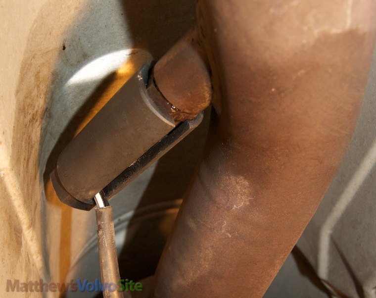

Here's a shot of my fancy new 7/8ths inch oxygen sensor socket. Less than $10. Didn't want to just cut the wires, you never know if a) the O2 sensor is indeed failed and b) if it's not, if you'll need one again.
There's just barely enough room to slide a 3/8ths inch socket wrench into the socket. Just push it on.
