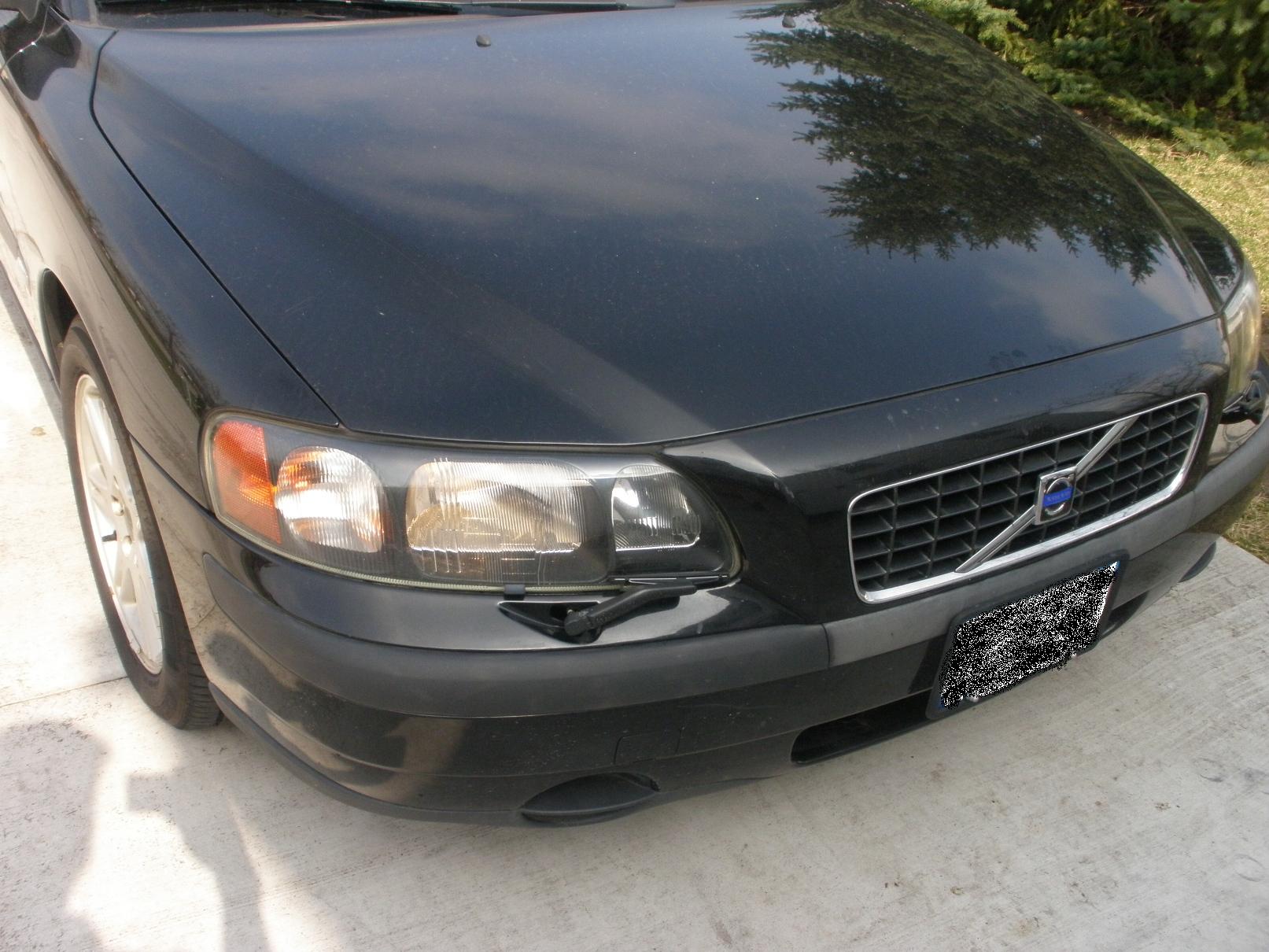

Got a new heat gun for a project around the house and had some time to try it on the bumpers on my 850 wagon.
Before
After
Not bad. took about 20 minutes total. some suggestion would be to wait for warmer less windy weather. It was high 50's here in Ohio. I did the front as well. Took out some spots and evened out some worn areas. I will hit it again when it warms up. Well worth the 31 dollars for the heat gun. Also used it to take some left over sealer after pulling the side moulding off of my Audi 5000 Turbo Quattro. Get ready to send the old girl to the paint shop.

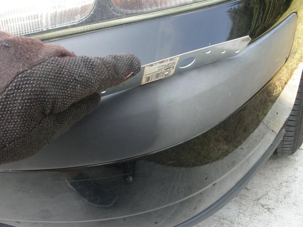

Last season I read about this method. I posted a brief discussion but it was too cold outside to get even results.
Warm weather has arrived so today I pulled out my $9.99 heat gun (on sale at Harbor Freight) and went to work.

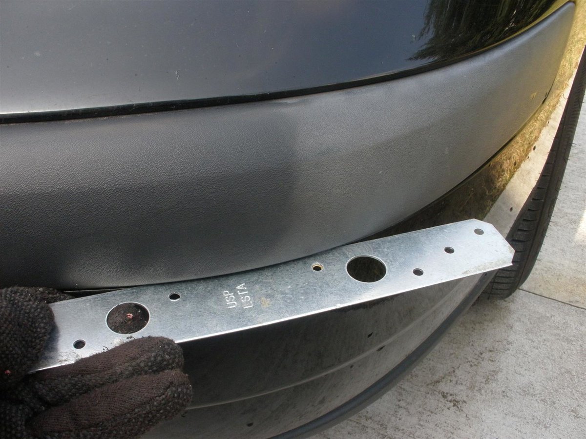

The side trim pieces are adjacent to metal on the door panels, so basic care is sufficient. The bumper trim, however, is adjacent to plastic so I used a thin metal bracket as a heat shield. In the photos below I am holding the heat shield along the bottom edge, then holding the heat shield to guard the top edge.
I used a small circular pattern to even out the effect, instead of going left to right (like power waxing your paint goes in an orbital pattern).
I had a couple of these metal brackets. When one got too hot to hold I picked up a new one and let the other cool down.
The third photos shows the change close up. It's not a perfect effect but its a huge improvement over very weather-beaten and faded 12 year old plastic trim. The fourth photo shows what it looks like from a normal viewing distance.
I did the side panels and the front and rear bumper trim. I didn't do the lower trim and I stayed away from the side marker lenses.
That whole job took me about 45 minutes.

Had to laugh about the choice of heat shields sorry ... something that insulates rather than conducts heat, and that doesn't have large holes in it, would presumably make a far better heat shield. Like a piece of wood. Just don't catch it on fire! :lol:

Actually I wanted something thin and something that dissipates heat over a large surface area. its like clipping an alligator clip as a heat sink when you are soldering so excess heat goes in to the metal then radiates away.

Reynolds Kitchen Aluminum Foil will work just fine, fold it double for stiffness and off you go
