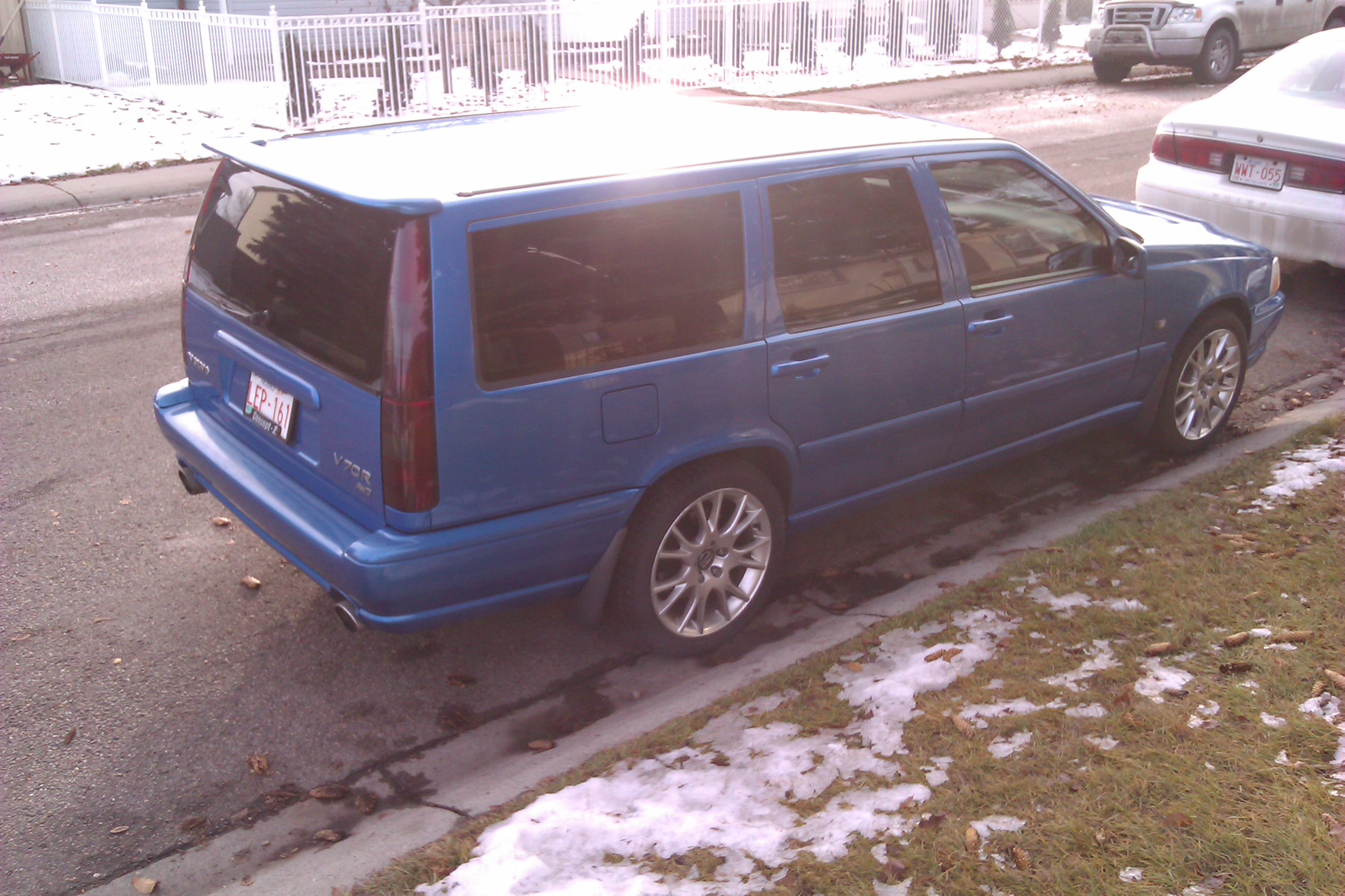

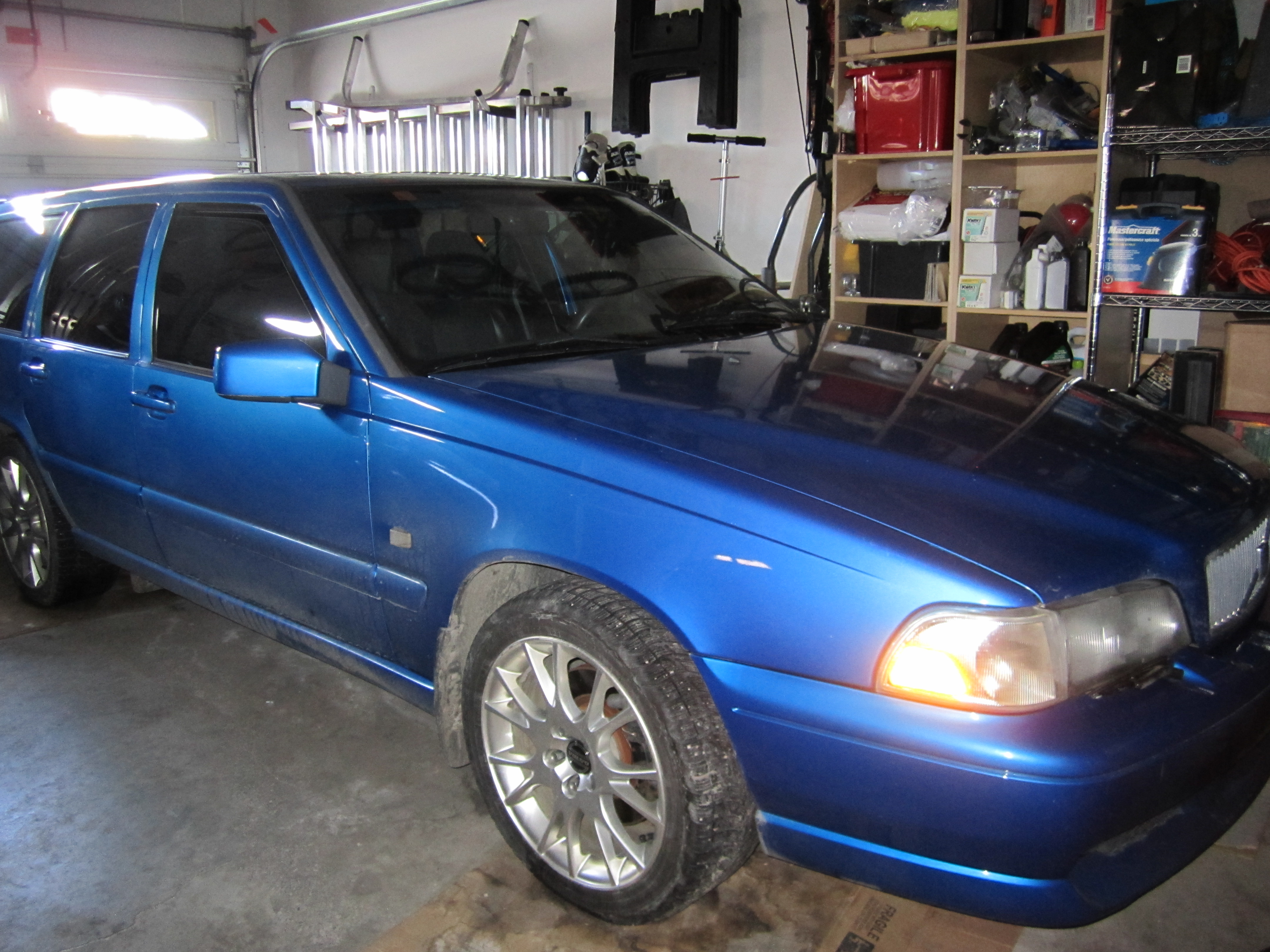

Many thanks for the added guidance on how to add a photo, so I did. Hopefully this now clarifies what the car looks like.
Appreciate all your help Regent.

I like that gorgeous Blue Beauty a lot!
