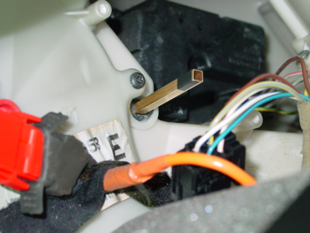

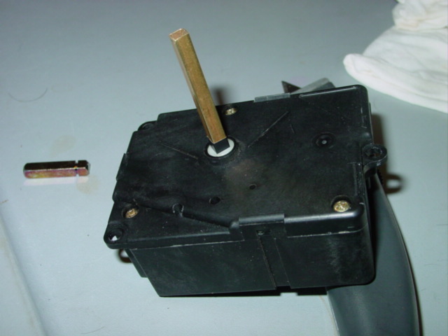

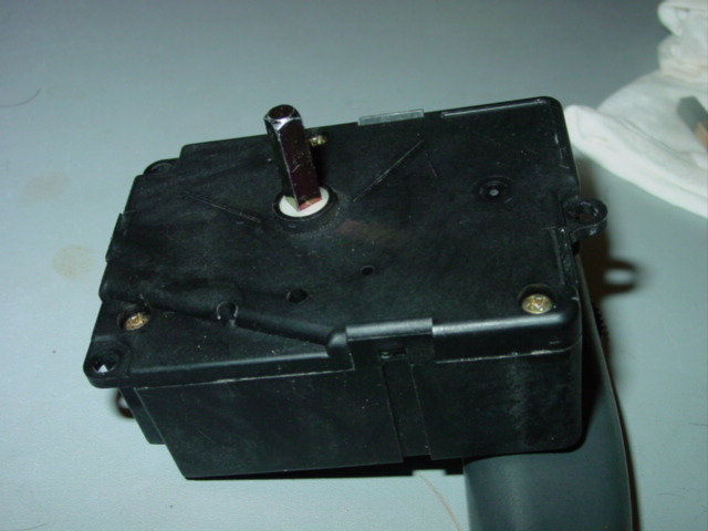

I used another method for the broken plastic female shaft that moves the dampener. The plastic shaft was broken close to the HVAC duct. I replaced the metal shaft in the electric motor with brass square tubing. Cut the the tubing to an appropriate length so it would fit right into the broken plastic shaft. I misplaced the measurement, but it was approximately 1 7/8".
The brass tubing is 3/16" square. K&S Precision Metals Stock #153. Should be available at local hobby (R/C) shops or ACE Hardware. A little electrical tape on the brass tubing will make it fit snuggly into the electric motor.

- Motor with Volvo shaft - remove and use brass tubing
- Motor.JPG (57.86 KiB) Viewed 542 times
- Brass Tubing replacement shaft
- Shaft Motor.JPG (57.83 KiB) Viewed 542 times
- Brass tubing into Dampener plastic. Note electrical tape on motor end of "shaft."
