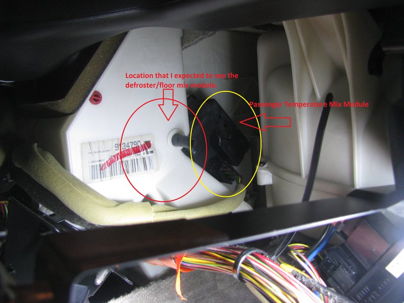

Hi All, I always use MVS, but this is my first post. I'm not getting any heat to the floor, or heat to the windshield for defrost. I've been all through MVS to find possible problems. At this point, I can't even locate the Defrost/Floor damper motor to determine if it's defective.
Can someone help with the location for the Defrost/Floor damper motor?
Any help is greatly appreciated!

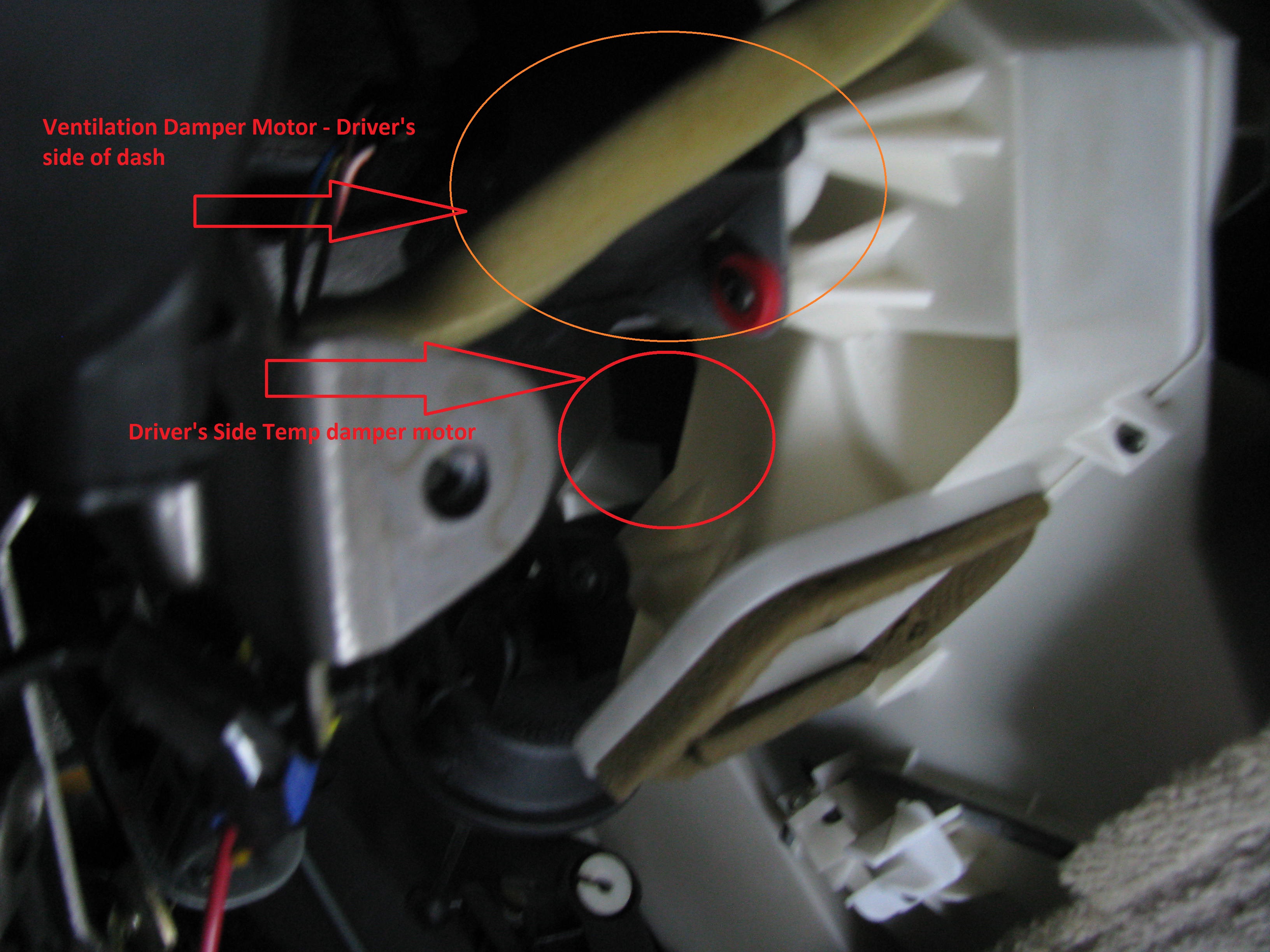

It should be up high on the LH side. It is hard to see/access where it is positioned. It looks similar to the one in your picture, but has a slightly different connection to the flaps. If you remove the LH dash under tray, and lay on your back looking straight up you may see it up to the RH side of the speedo console.

Hmm! I recently stripped the dash out of a 98 S70 with ECC and only recall pulling 3 motors. Perhaps I missed a second one on the LH side. Our old 850 had 5 motors.
I looked a Vida for a 98 V70 with ECC and is lists 4 motors, but does not show the location of them all.
As I expected, there is the one behind the glove box for cold air ventilation, the one on the RH side (my version of Vida does not show this), and the one on the LH side.
Vida lists the motors as follows: 2 x temperature, 1 x recirculation, 1 x ventilation. Working on the assumption that ECC has temp controls for each side, then that would account for the 2 temperature motors, and the other 2 are self explanatory.
Hope that helps.
The pain with this is that the plastic connections for the flaps connection to the motor drives can split with age, and I have had cases where the flaps stick with age. It would be a major pain to access the motors to remove and test the flaps are all good.
The cold air/ventilation flap behind the glove box can fail as the plastic arm that actuates it brakes. This is a relatively easy repair, requiring the glove box to be pulled, but the motor has 1 or 2 screws at the front, and then slides out.
The motor on the RH side can be removed with great difficulty and patience, but is a real pain as one of the screws requires a double jointed arm (yours!) and a mirror to access it.
The motor(s) on the RH side, in particular the recirculation motor, would probably be accessible by pulling the top dash cover off and removing the speedo binnacle. The LH temp motor I haven't tried to remove, but I'm fairly sure the cruise control may have to be removed to get to it. Maybe someone more familiar with working on that one may ship in.
I have not had a motor fail yet, but have had the flap connection split. There is somewhere on the internet a how-to on cleaning and refurb. on the motors if you want to go that far.
