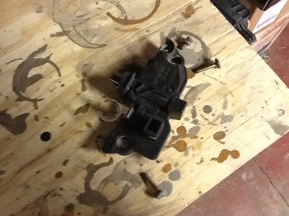

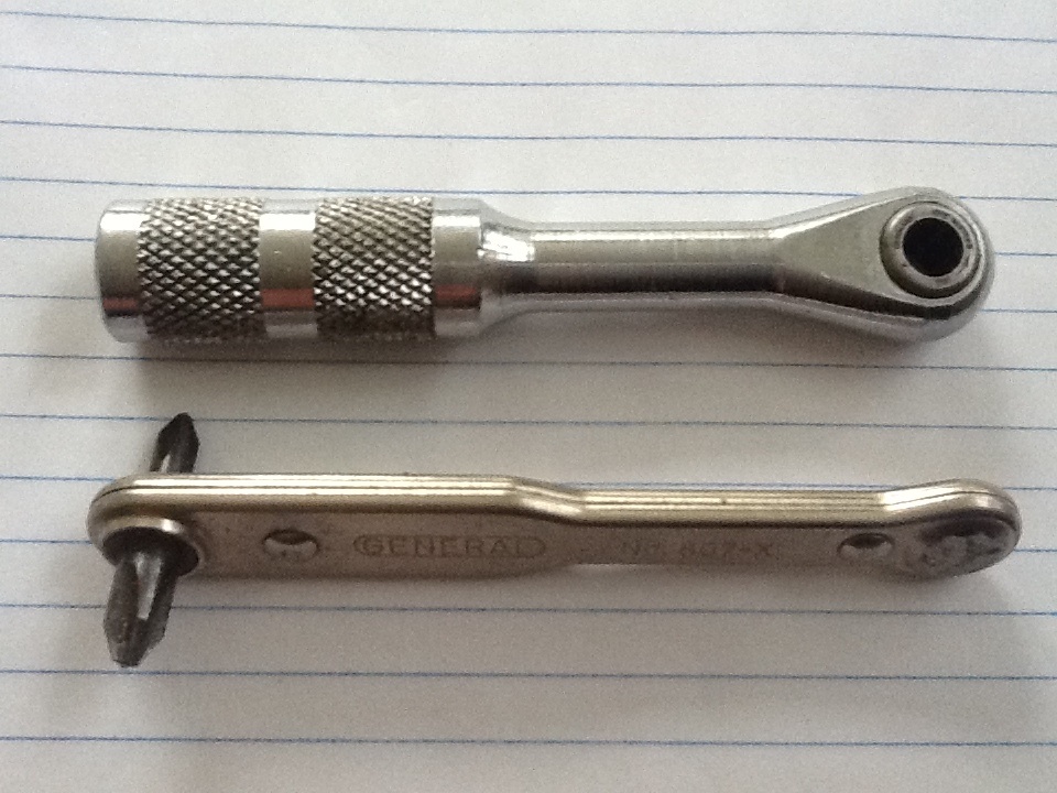

I have an alternator from a 2000 V70. The part number on the regulator is BR14-M1 then printed below the BR number is F OOM 145 230. The cover plate or cap is held on by the B1 and B2 nuts and a Philips screw. no clips. The voltage regulator is held on by 2 long Philips and one short Philips. It then slides out.

Thank you! Your two pictures are worth at least 2000 words! F-OOM-145-230 is the Bosch part number, and I've found independent confirmation that it is supposed to work with the 0-124-515-019 Bosch 120A alternator:
http://store.alternatorparts.com/ib230- ... ators.aspx
I'm thinking I may have to bite the bullet and pull the alternator to get access to the regulator. I saw a video that involved pulling the serpentine belt, moving the power steering pump and taking out the radiator fan in order to get the alternator out (all because of that one Phillips screw!). Any insight on this?

$49.95 + $12.95 shipping to Canada. The best I could find in Canada was $94.99 + 13% tax + shipping. If I can get the screw out of the cover without having to pull the alternator (I'm going to try a ratcheting screwdriver as Kahl suggested above), I'll be on easy street...

I managed to replace it with the alternator in place using a Phillips bit in a small ratchet. Very fiddly work, but it is possible. There was one hiccup while putting it back together-- I dropped the screw for the cover plate and couldn't find it anywhere. It seems to charge fine-- 14.05V at the battery terminals. Should I be worried about this?
