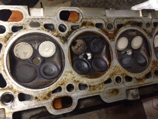

alright. I got the head off. Pretty cool stuff! Thanks Robert for the step by step instruction. The #4 valve looks nasty. Also as i looked at the pistons I noticed that all of them have indentations on them. These do not look new. I'd like to get your thoughts on the posted pictures. What's my next step? Thanks as always.

Yep, burnt exhaust valve. I should make "white block" key chains out of them. How long have you had that car? How many miles have you put on it?
The pistons are fine. They are made with those groves in them.

If your making key chains i'll send you mine too! I have had the car 1.5 years. I have put around 20k. I was hoping those grooves didn't happen when all this went down. This is good news. I will be taking the head to the shop Friday or Monday to have them r/r it.rspi wrote:Yep, burnt exhaust valve. I should make "white block" key chains out of them. How long have you had that car? How many miles have you put on it?
